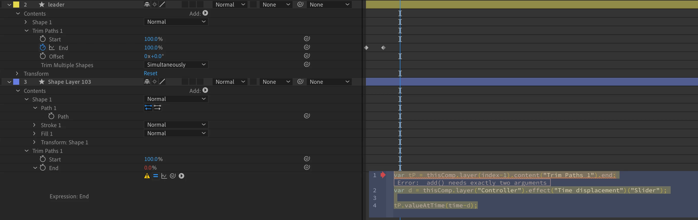

I have about 100 shape layers that I want a trim path on, and for them to be offset by x amount over time so the first starts, then the next follows and so on. Whilst I could keyframe this and then sequence the layers, it becomes a big faff if I want to change the delay amount. I'm using:
Adobe After Effects 8.0 Keyframe Data
var tP = thisComp.layer(index-1).content("Trim Paths 1").end; //a 'leader' shape layer above
var d = thisComp.layer("Controller").effect("Time displacement")("Slider"); //a slider on a null
tP.valueAtTime(time-d);
I'm getting 'add() needs 2 arguments on the first line. and AE seems ok with it someimtes, and not at others. I can sometimes scrub through and see the value change as expected, but not the image, sometimes it just gives up. What is happening? Any input greatly appreciated, thanks!
