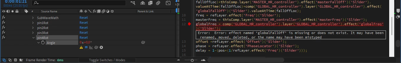

Tengo el siguiente error en pantalla con este script y no se como solucionarlo:
Por si necesitas todo el código es el siguiente:

Well, have you actually created the controller layer with all the sliders mentioned in the code?

That's a strange error message. It's complaining about not being able to find the Slider Control named 'globalFallOff', but the line that it's pointing at doesn't reference that control. Can you post a screen shot of the controls on the 'GLOBAL_HR_controller' layer?
December 26, 2022
Sorry, I can't find that layer anywhere, maybe that's the problem. This script was not created by me, it was made by Anthony Possobon. The problem is that it also worked correctly before, the only thing I did was update after effects to the 2022 version.
If it works for you, I'll pass you the script.
Dan Ebberts
December 26, 2022
It appears that when you run the script, it creates the control layer and then applies expressions to your shape layer (with puppet pins) that refer to the controls. It sounds like that's not the process you followed here, is that correct? Is this an older project file where the script had been run previously? If so, maybe the control layer got renamed or deleted?
