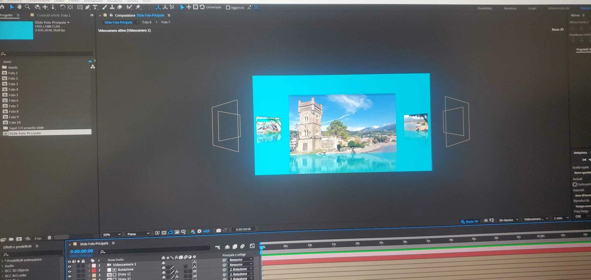

Cari ragazzi buon giorno ,
sono alle prese con l`esportazione di un progetto che non risulterebbe dopo coda di rendering UGUALE alla visualizzazione del progetto avviato in timeline : cioe esporta solo livello tinta unita (sfondo azzurro) posto come ultimo livello e NON tutto il progetto a carosello di foto che girano in circolarita` ed in sequenza .
Dove commetto l`errore?
Vi allego un foto di schermata per fervi rendere conto del sitazione
Spero in vostro concreto aiuto

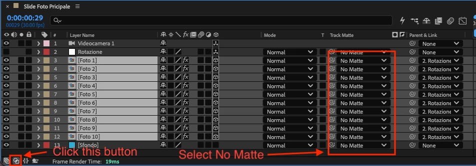

    Looks like you’ve used the Null as a matte for the photos layers. Which is making them disappear. If you go to the layer panel > Highlight all the photos layer > Select No Matte in the Track Matt drop down, you should be able to export the file with photos.
    Note -  If you don’t see the Track Matte drop-down in the Timeline, you can enable it by clicking the button in the bottom left of the Timeline panel.
    Check out the screenshot.
    Let me know how it goes.

    You were clear and precise... I solved the problem and I also solved some small errors in photo centering and reflection of the VR Reflect plug-in... I don't know what to say. Thank you so much for your patience and expertise... Nichu, you are the president...

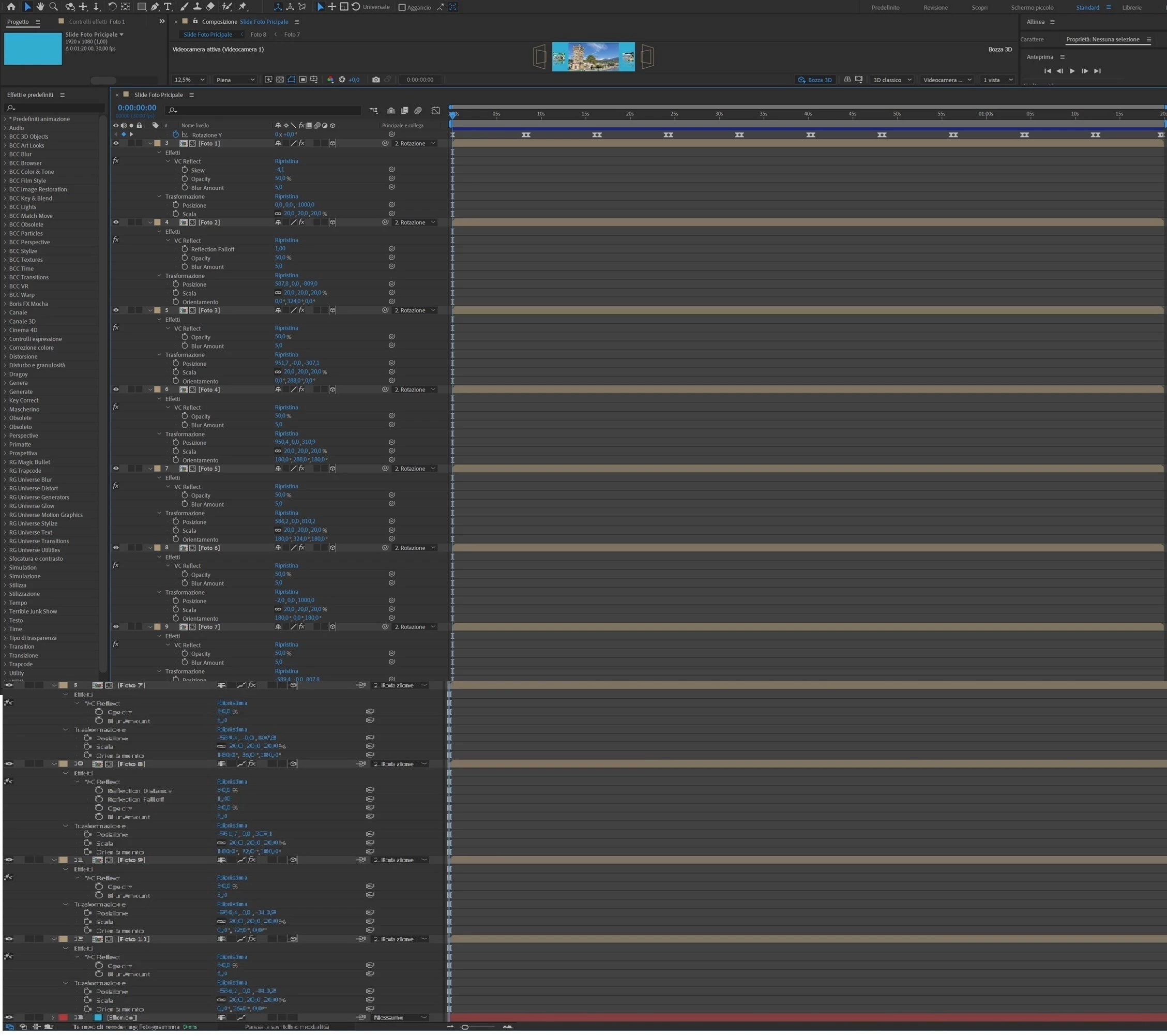

    To fit the entire timeline into a photo of the screen, I had to make a few changes, but I hope the result helps you... I look forward to your comments!
    Regarding your first question, namely, if the levels were set as guide levels, how would I know this?
    I'm CERTAINLY far behind your preparation and knowledge of the program... you're the teacher, I'm the student, so to speak.
    I look forward to your patient feedback and add that you've completely understood what exporting does to me.
    Thank you, Giovanni.

    As I can understand, when you export your project, only the blue background layer is exported. Is that correct? Please ensure that your layers are not set as a Guide Layer. Also, do you mind sharing an uncropped screenshot of the After Effects UI with modified layer properties expanded (press "U" twice while the timeline panel is highlighted)? That'll help us understand the issue better.
