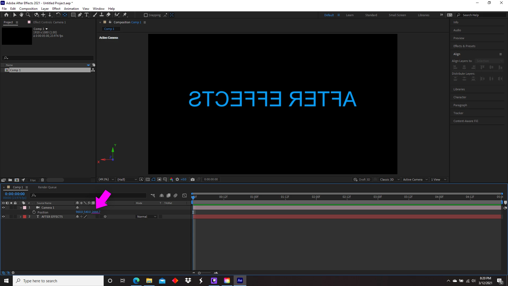

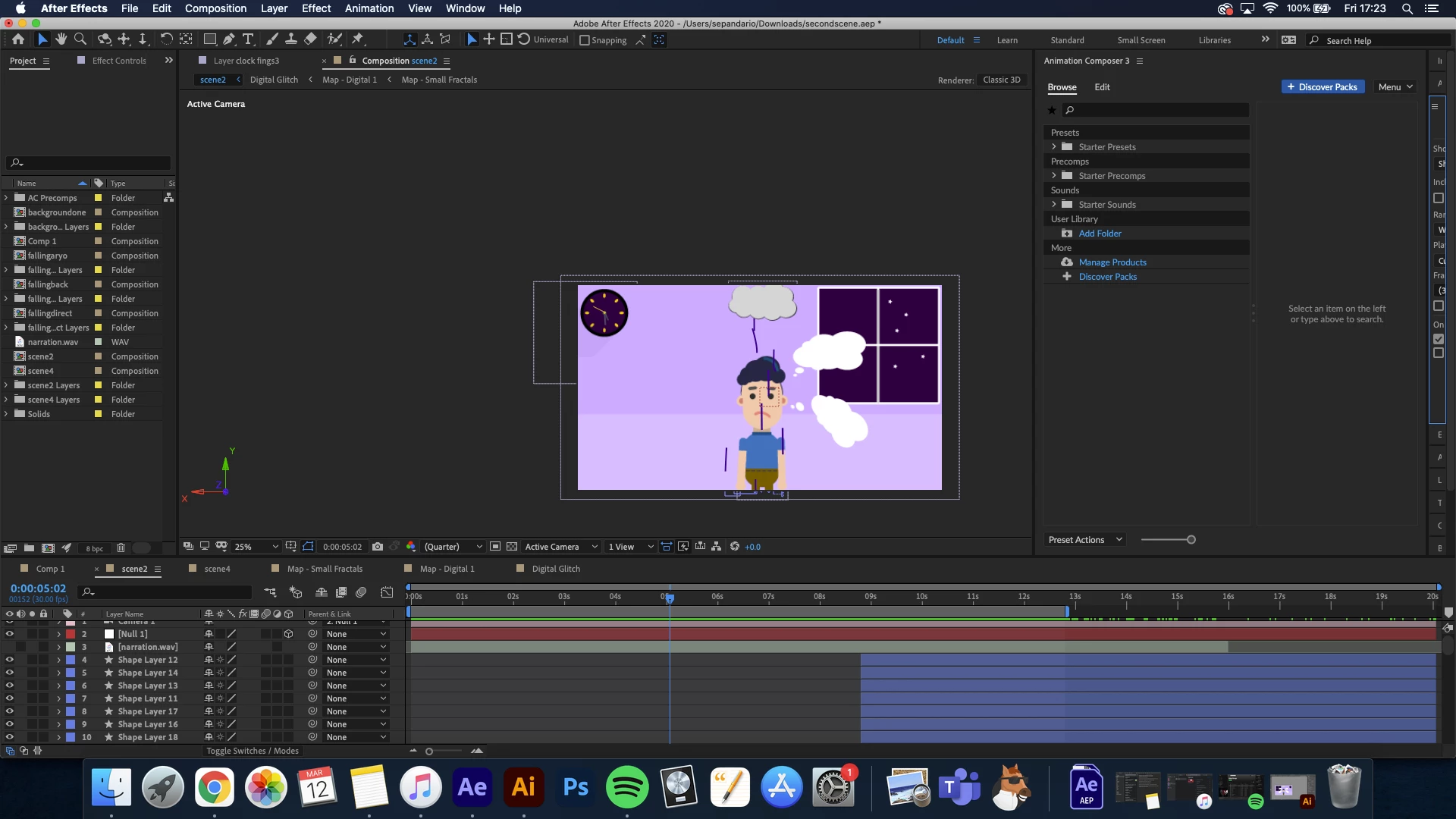

Firstly please bare with me as I am just starting with this software however, while I was working on my project for some reason everything flipped horizontally (reflected) and I am not sure how to bring it back to how it was in the beginning. I tried to flip everything horizontally by the layer option but that would just mess up the animations that I did for them.

Check the Z Position value.  If the Z value changes from -2666.7 (ngative) to 2666.7 (positive) with the default Point of Interest Z at 0.0, then your artwork will flop.
March 13, 2021
Someplace way down the layer stack, there is a layer that is probably 3D and. your camera is probably behind it. When you are trying to solve problems select and solo the problem layer, press the U key twice to reveal all modified properties. If there are 3D layers open up at least 2 views so you can see where the camera is in relation to the layer. If you can't figure it out post screenshots that show the layer properties (press uu) and embed those screenshots using the toolbar.
It also looks a lot like you have some Illustrator artwork that you have converted to shape layers. There's a better than 90% chance that doing so does not give your project any advantages. It is almost always a complete waste of time to convert vector layers to shape layers.

Start by checking your camera and the Null.
