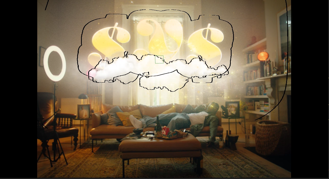

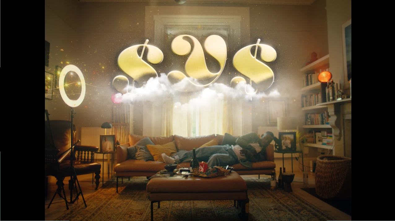

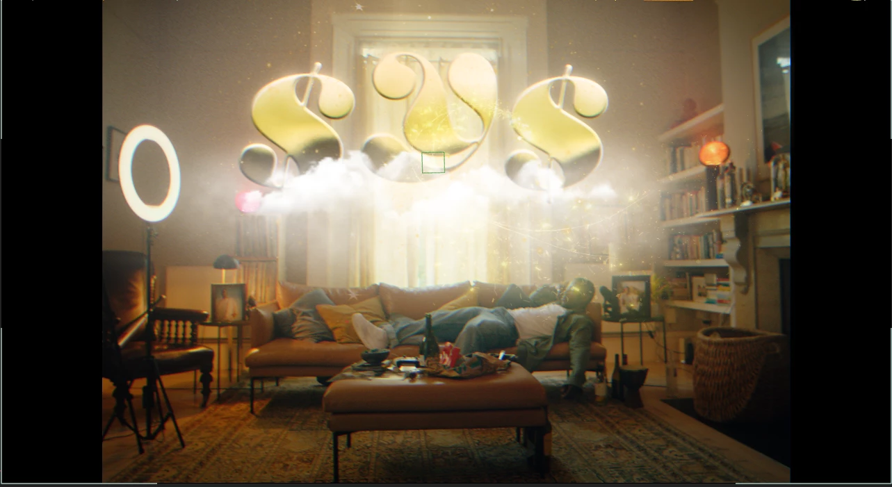

There is more of a fundamental flaw with after effects architecture here that Adobe are not will to admit - Please follow this example. I'm working on a film title here - it's a heavy composite. One of the final stages is to add chromatic abberation to all layers Except the background layer. I cannot precompose because if I do my blend modes will work incorrectly and the alpha channels will create a dark shadow underneath in the main comp. If I add an adjustment layer I can get the desired effect but now the footage is covered in CA that I don't want. If I add chromatic abberation to each layer indivusally I'm met with a black edge banding around each object because it's only applying to that layers individually alpha channel. If I add CA within my title precomps then I my CA is affect by all of the blur and glow affects on the outermost precomp.There is forced compromise here - it is crucial for after effects to add some form of node based work around for situations like this.  - I understand this is probably a project that is best tackled in Nuke, but as a motion designer (not VFX artsist) pulling a favour for a friend - nuke isn't an option. Now I know this isn't a massive deal, but it is a limitation of After effects. Examples attached, and link to the final sequence here
