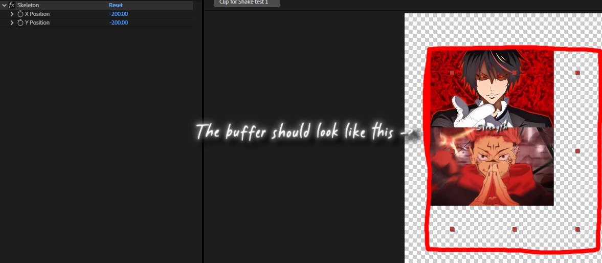

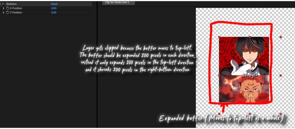

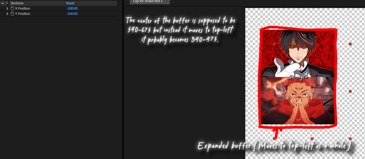

The buffer only expands in the top-left part and it looks smth like this:
It should clearly look something like this instead:
Now, absolutely no one wants to help, I don't have the slighest idea why this happens. The buffer expands in the top-left direction but it shrinks in the bottom-left direction. It does not make any sense. Here is my current code (btw if you set both rects to the expanded rect, PF_RenderOutputFlag_RETURNS_EXTRA_PIXELS is not needed:
