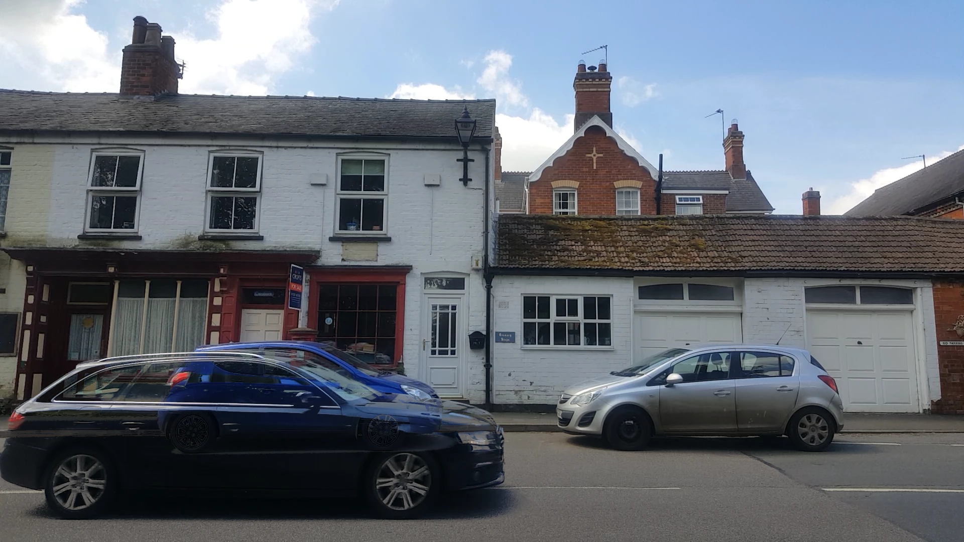

I'm having trouble creating transparency using a Difference Matte. I have a still background image without moving object that I use for the Difference Layer and the footage. The camera is mounted on a tripod so there's no camera shake.
Here is the still Difference Layer image
The object I want to isolate is the car in the foreground

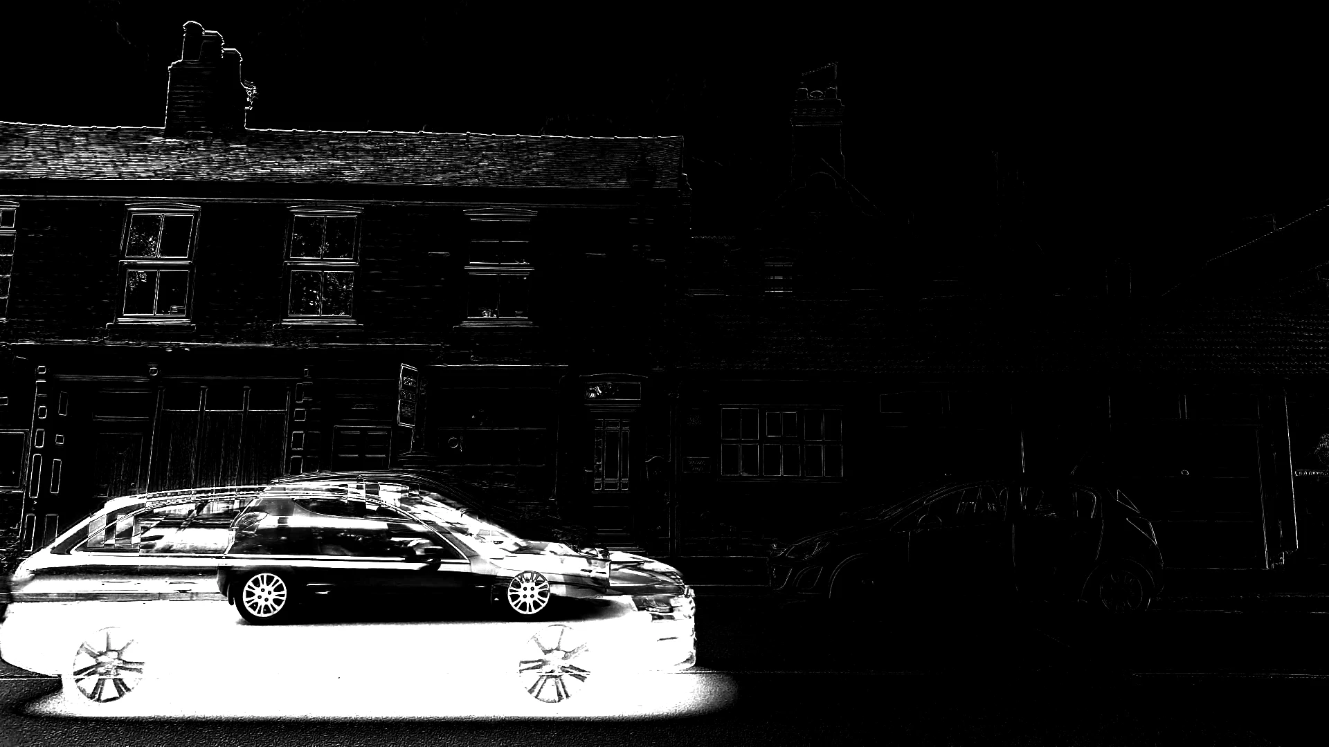

This is the best result using the Difference Matte and Matte Choker
And this is the Matte Only so you can see what the differences are
Is there anyway to improve this as it just look ridiculous?

You actually answered the problem yourself—those are the differences. The difference blend mode visualizes the differences between two layers. Everything else in your shot is the same, with the exception of the foreground car. This is why your matte is mostly black, because there's no difference between the two layers.
If you want to isolate the car you need to rotoscope it. You can start by checking out the Roto Brush (After Effects Roto Brush, Refine Edge, and Refine Matte), but it depends what you're trying to do with that isolated car. If you want to completely cut it out then you're going to have to do a lot of work on the windows, as you can see right through them; so if you're trying to put the car on another layer you'll have BG elements from the above shot mixed in with your car. If you're trying to color correct the car then you can just use the Rigid Mask Tracker and attach that mask to a Lumetri Effect.

The problem is the blue car! In the Final Output image (3rd down) the blue car in the background can be seen through the black car in the foreground, this I assume is because the Difference Matte algorithm has detected no different between parts or the blue car and parts of the black car. This can't be the case because when the footage is played in Final Output mode the blue car can clearly be seen as a ghostly image as the black car passes in front of it. If there were no differences between the two layers then the blue car ghost wouldn't be visible.
Have a look at pictures 2 and 3 (from the top). You can clearly see in picture 2 the black car in front obscures the blue car behind it and a nobody would never say that there isn't difference between the two, except for those bits that appear through the window.
I want to isolate the car because it's going to appear in the same place but later on in the footage. Bits that appear through the windows don't matter because the car will still be driving passed that car anyway.

Sorry, I was thinking more about the Difference Blend mode than the Difference Matte effect. It looks like a contrast issue then. Your BG blue car is too similar to the FG black car, which is indicated by how the matte looks. The darkest parts of the blue car are black, indicating no differences.
Here's one option: you could try color correcting your still image. You didn't say what version of Ae you're using, so there are two different ways to go about this. If you're using CC 2017 then you can add a Lumetri effect to your still image, go back to your Difference Matte effect and choose "Effects and Masks" (next to the Difference Layer dropdown). This will allow the Difference Matte effect to reference the post-effected clip.
If you don't have this option then you have to pre-compose the shot and move the Lumetri effect inside the pre-comp.
