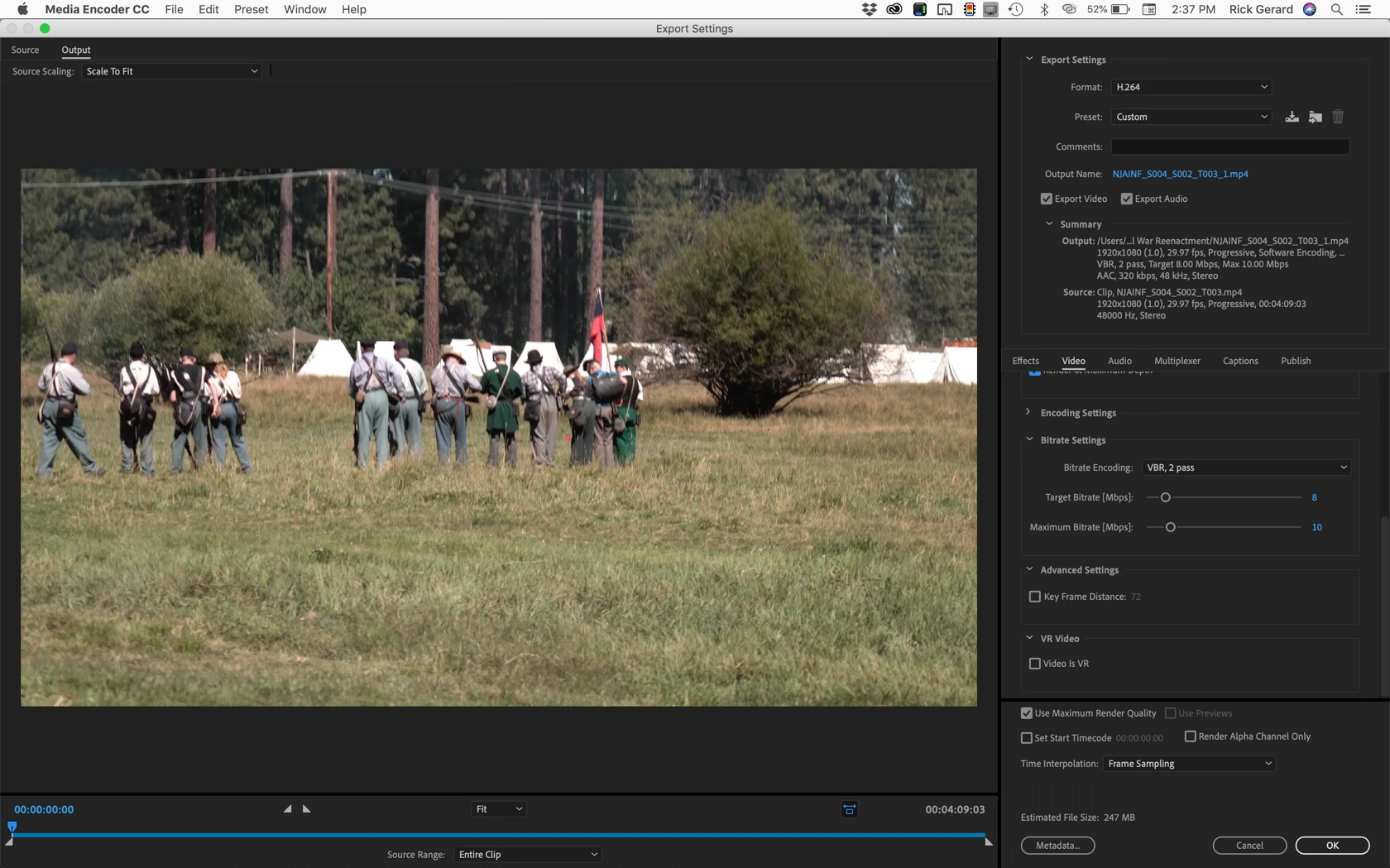

When I am asked to deliver at different frame sizes I always render a 10 bit or better production master using the Render Cue and a suitable production format. I load that footage in the Adobe Media Encoder and set things up as follows:
  1. Pick the Vimeo HD Preset
  2. Check the bitrate - it should be 16
  3. Reset rendering to VBR 2 Pass and change the bit rate to 8 and 10
  4. Move to the video settings and divide the width by 2 and you should get 960
  5. The last step is to enable Render at Maximum Quality
Until you become an expert in compression and formats this will give you a very high-quality render at different frame sizes. VBR 2-pass rendering will do a better job of preventing color artifacts and retaining detail when the footage is downsized. If you can do simple math picking the right data rate is almost always just a matter of dividing the width by the new width and fixing the data rate. Anything higher than the Vimeo or YouTube presets isn't going to get you much more than a larger file.
You can load up the AEP/Comp file if you like, but your render times will be lower if you render a production master first, then do the h.264 rendering in the AME.
I hope this helps. If you are going to be doing a lot of work with video it is a very good idea to spend a few hours studying compression so you understand exactly what is going on when you monkey with the knobs.
