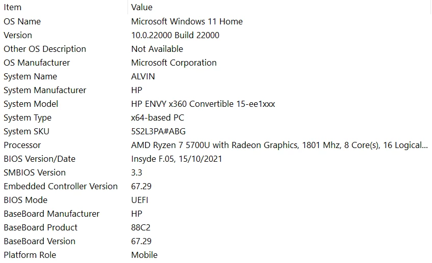

Sorry, but this is way too vague to make any sense of it. You need to provide exact system info, details about the comp by ways of screenshots and explanations as well as exact specs of the source files and where you got them from plus other critical info such as hardware acceleration, actual memory and cache settings, render settings and so on.
Mylenium
September 25, 2022
So sorry! I'm not exactly a tech genius and I've never had a problem with AE before so I was unaware of what would be needed to get more clarity on the issue. Thank you for the reply, for starters!
I've attached a screenshot of my system's info, as well as other information listed in your above message.

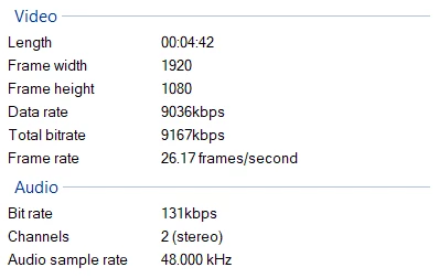

The composition is compiled entirely of mp3 audio files and mp4 screen recordings of a video player on Google Chrome (details below). The AE file is 11MB with 900 layers (though merging clips and layers doesn't seem to have any better effect, as I tried that in a different save antd the problem still occurs).
I've also included a screenshot of the warning that comes up every time I re-open my file - each time it claims that different clips are damaged or unsupported. If I continue re-opening my file, eventually every clip will be lost. I've been using Media Encoder to export as Render Queue only exports the audio.
