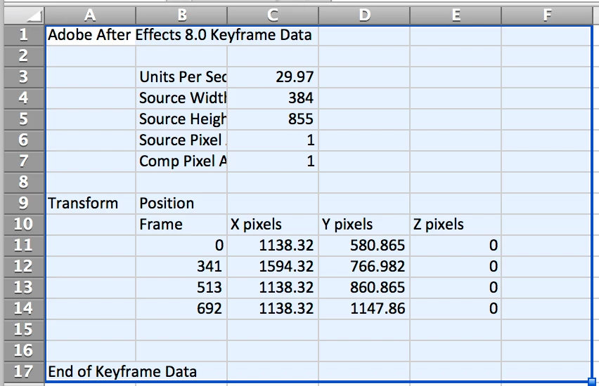

I'm planning to record some footage of users interacting with a physical product (not software). The users are asked to hold the product fairly steady, but I need to track their movements (camera position and angle is fixed). I plan to put 3-4 small points on the product visible to a camera. I'm hoping After Effects can help track those points and export some usable information in eg. csv or some other excel friendly format. It could be the position of the points relative to each other or a fixed point in space, or the distance between the points. If I get the data I can calculate what I need from there.

    This is what copied and pasted position keyframes look like when you copy and paste to excel:
    You will have to do each tracked property individually and AE's tracker puts a keyframe on every frame, then you'll have to edit the spreadsheets to get something that is easier to understand. Nothing to it but to turn that data into meaningful graphs you'll need some fairly decent EXCEL chops.
    That motion path is curved by the way and there was a bunch of easing applied to the path. None of that comes through when you copy and paste keyframes to s spreadsheet so a motion graph of that movement would generate a straight line between frames. The only way to get the curve if you don't have a keyframe on every frame is to add a simple expression. Just start an expression then type value. Then use the keyframe assistant to convert the expression to keyframes and you'll get a description of the curve in the spreadsheet.
    You can not get any usable data by copying and pasting mask or shape path keyframes.

    My goal is not to create a new video or any other digital output. It is solely to get some data on the angles and movement of the product. If I can get some numbers / position information from After Effects I can calculate what I need in Excel (I'm not concerned about my Excel skills in this regard). If I can get a set of keypoint data (e.g. X and Y coordinates for each tracking point) for each keyframe like Rick Gerard has shown here then I'm set! I don't want a curve or anything like it. Just the keyframe-by-keyframe coordinates. From that I think I can calculate what I need (reference distances, angles etc can be calculated based on this information).
    So if I record the video I can go in and add tracking to the four points and keyframes for e.g. every 5 frames, it can output something similar to Ricks spreadsheet with coordinates for each point at each keyframe? I don't know how to do it yet, but if I know it can be done I'm willing to dive into it and learn!

    What Roland suggested - simply paste the keyframe data. If you need more extensive processing, consider buying mochaPro or another commercial tracking app like Syntheyes that offer way more custom export formats.

    Any property's value(s) can be copied and pasted into a Word/Excel document.
