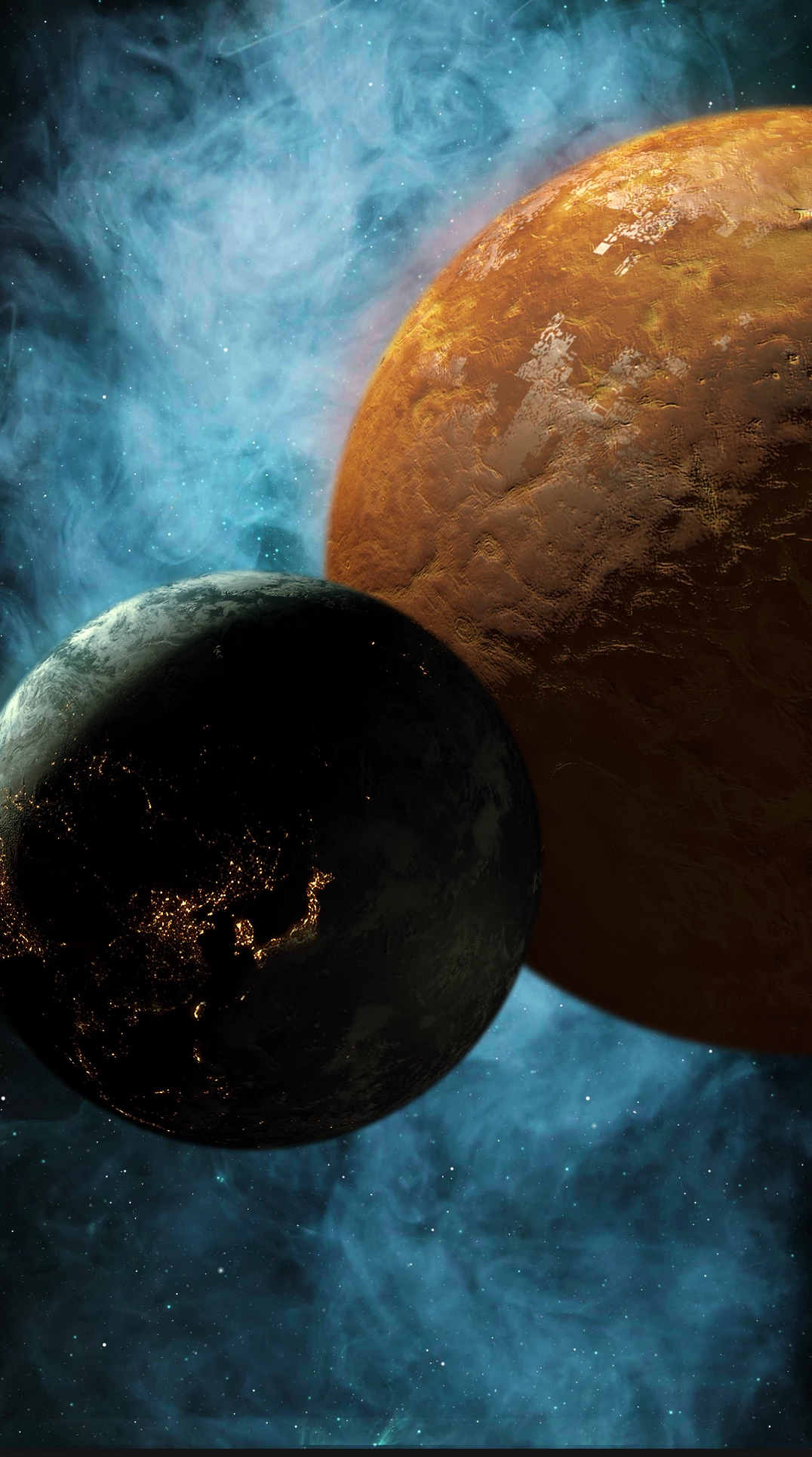

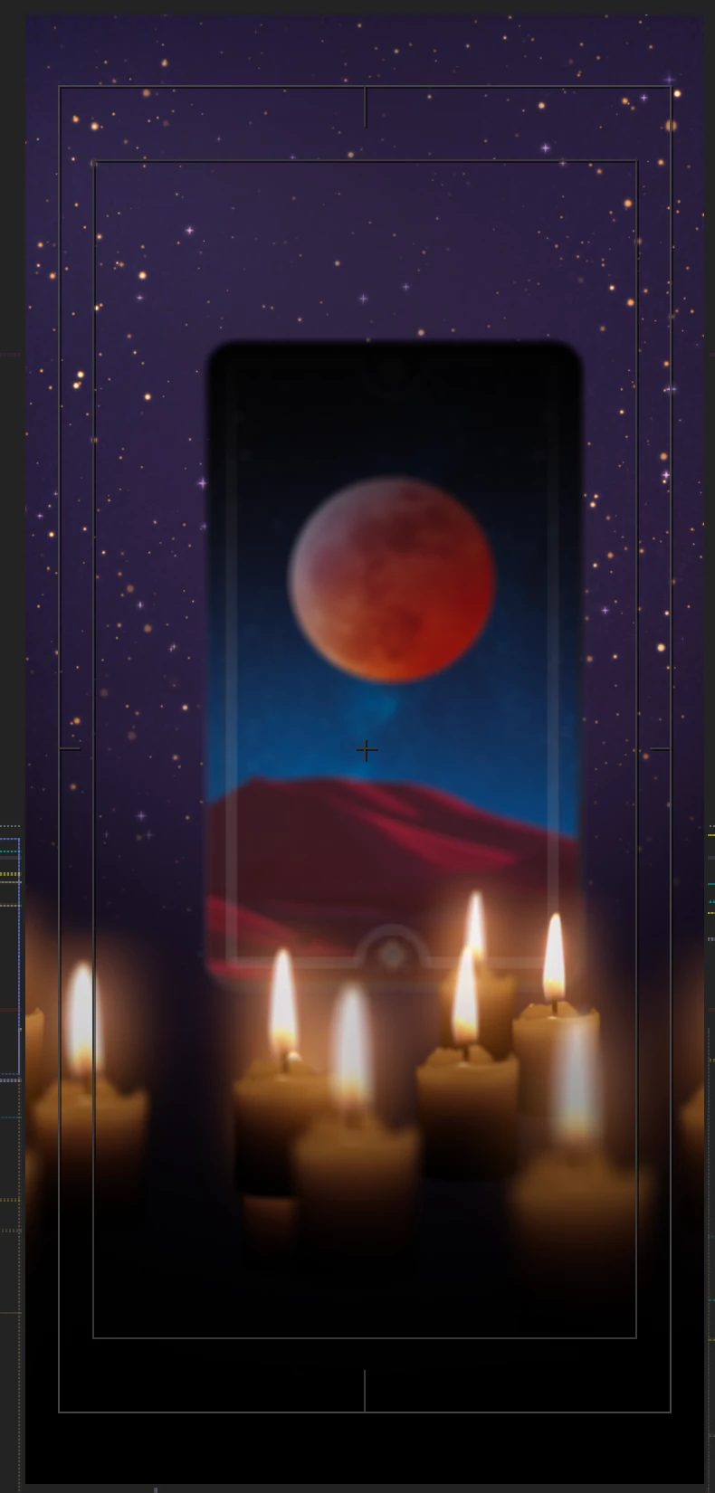

I'm going to share some screenshots to explain my project better.
