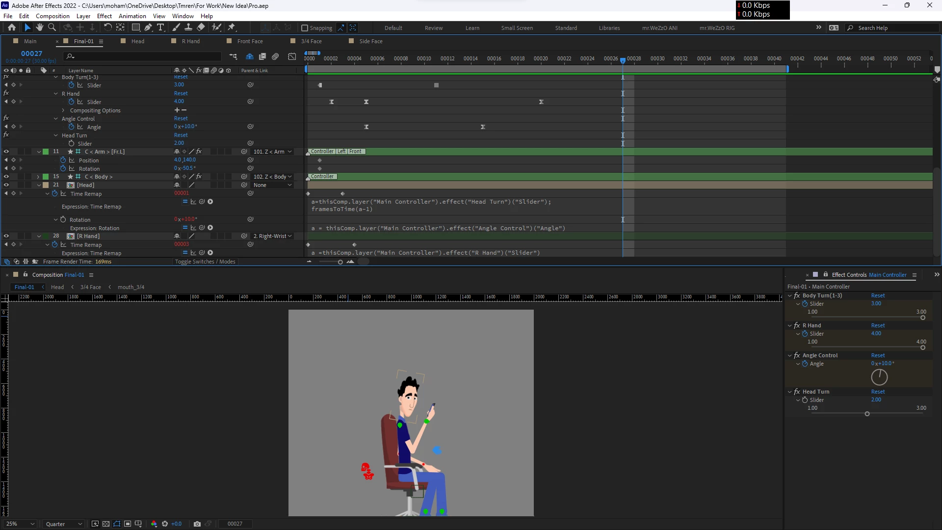

Hello There, I'm Character Animator & I use a lot of Expressions and connect with the slider control and Time remapping when I try to animate with a keyframe nothing works so I need a guide or pdf about expression.

Thank you for your reply, I upload a video about the main problem.
