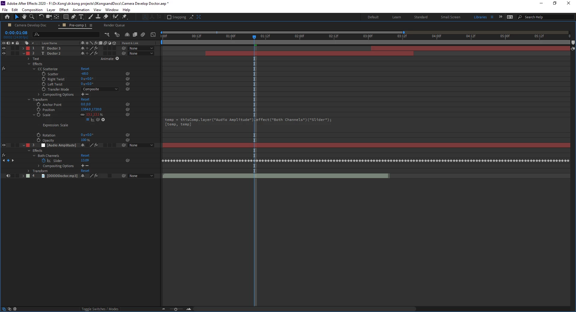

I'm trying to have my image sync it's scale with the beat of the audio. Was able to convert to keyframes and pickwhip scale to the slider, but I found it too small a scale. I tried to add 100 to each of the values, but if I hit enter or click away, it just dissappears.
Here's the code I have working successfully;
temp = thisComp. Layer("Audio Amplitude") .effect("Both Channels") ("Slider") ;
[temp, temp]
And I try to add the following: + [100,100] in order to make it larger. What am I doing wrong?
I'm going off a tutorial that doesn't have this issue. Thanks

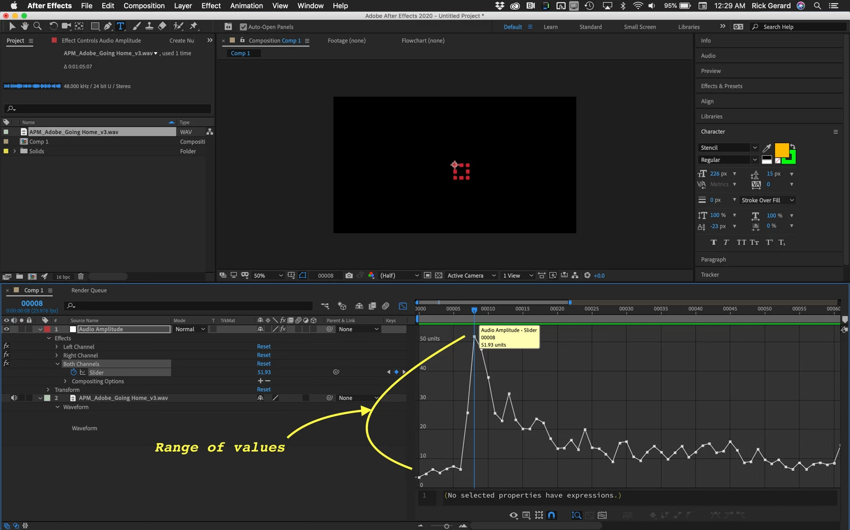

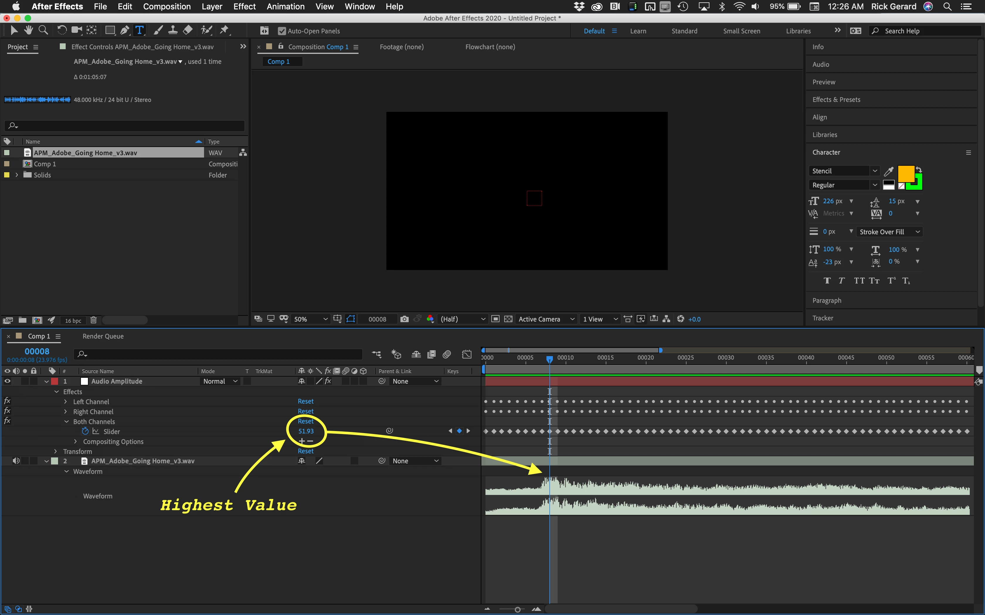

Your workflow and your thinking are incorrect. Open up the Graph Editor, make sure that it is set to view the value graph and check the range of values in the audio layer. Typical values for Both channels run from zero to about 50 or 60. It is easiest to see what the value range if you use the Graph Editor but you can also just check the waveform and the keyframe values:
For this audio track, the maximum loudness is 51.933. The average lowest vale is about 9. Once you know what the loudness (both channels) curve looks like you can add a linear method to the expression. You can use any of the different Interpolation methods to set up the relationship between audio and scale. I usually prefer Linear but you can use easeIn or easeOut. This is the proper linear method to use:

You've done a few things which individually they should work. However, there is no clarity on what your Expression looks like at this moment. You should provide a screengrab of (1) Expression and (2) Timeline with layers and keyframes.
