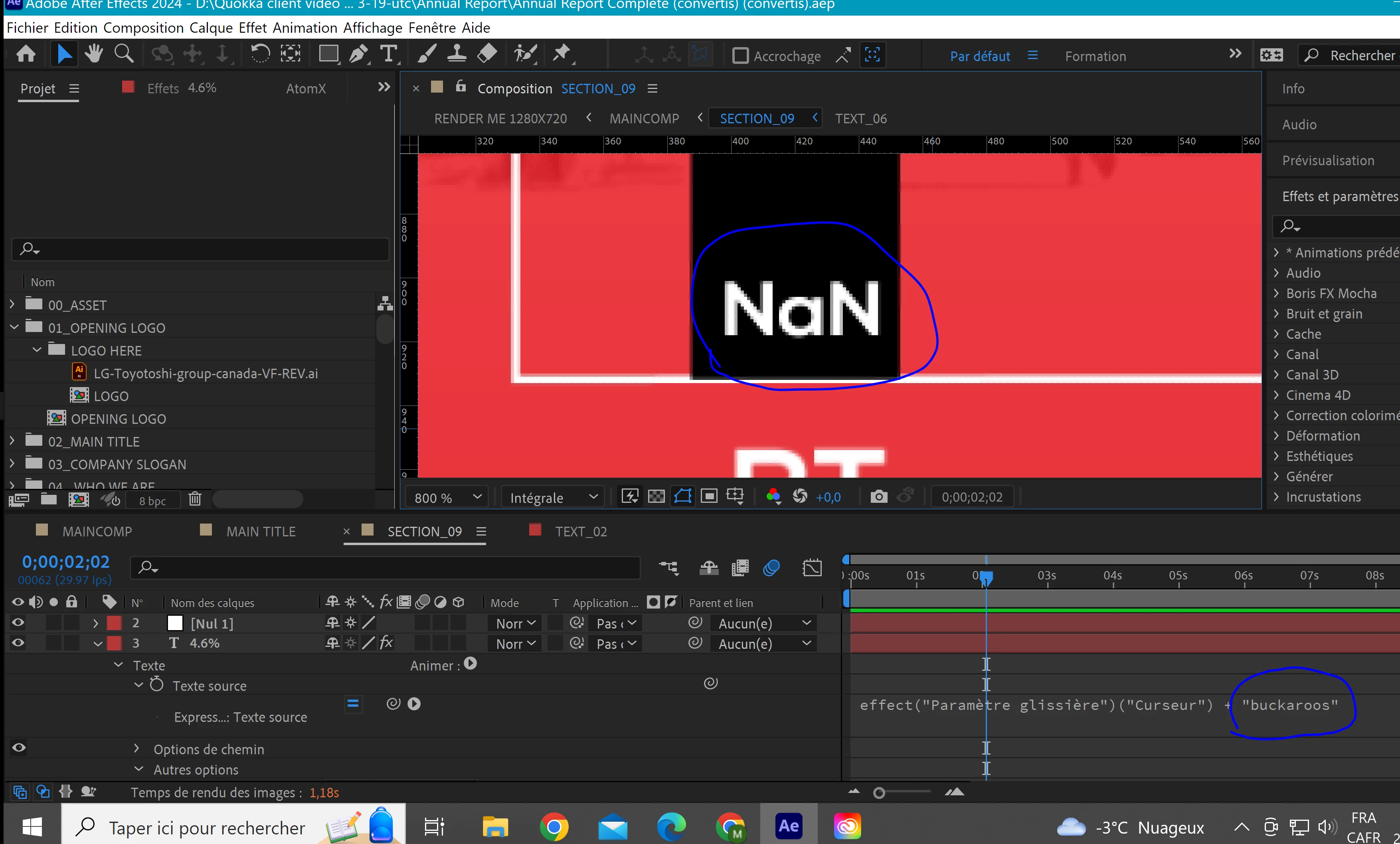

expression dont work in 2024 but do in 2022 AE edition
This expression works in 2022 but not in AE 2024..
effect("Paramètre glissière")("Curseur")+"$"
Waste 1 hour on it.
Fix your &?$%%$&& platform that you charge 1000 $ CAD per year

Jan 23, 2024 2:36 AM UTC
Yes, it depends on the JS engine used:
Legacy Extendscript Engine:
effect("Paramètre glissière")("Curseur").value + "$"
Javascript Engine:
// OR
effect("Paramètre glissière")("Curseur") + "$"
JohnColombo17100380
Jan 22, 2024 10:12 PM UTC
@KodaAgence Also, try changing your expression engine to JavaScript in the Project Settings under Expressions.

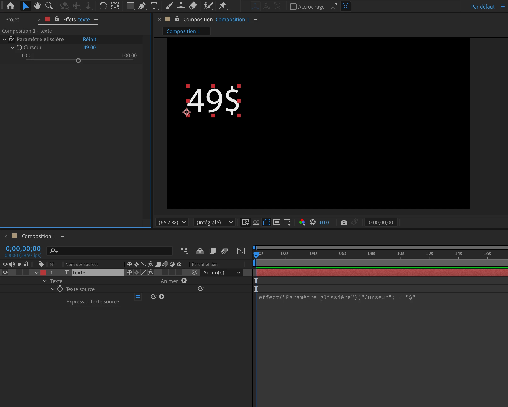

Jan 22, 2024 10:06 PM UTC
Hi @KodaAgence,
Thank you for submitting this report. The same expression link appears to be working for me in version 24.1 (see image below).
Are you able to share your project with us so that we can take a closer look?
Thanks again for reporting this issue and for any further information you can provide,
- John, After Effects Engineering Team
