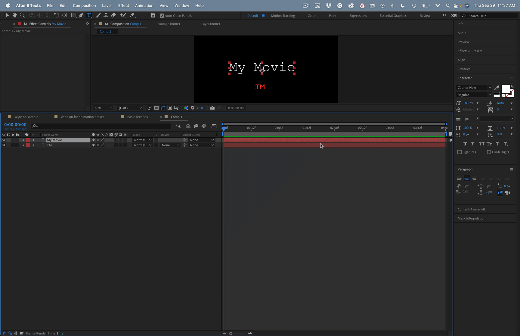

Bastien Tessanne
September 29, 2022
I have an animation preset I created a long time ago that I use to add trademarks or graphics to either end of any graphic or text layer to another text layer. I use it all the time.
This is the expression:
// Controls
pad = effect("H Pad")("Slider");
vertOffset = - effect("V Offset")("Slider") * .01;
stLeft = effect("Set Left")("Checkbox");
// reference Layer
ref = thisComp.layer(index - 1);
refPos = ref.position;
refScale = ref.scale * .01;
box = ref.sourceRectAtTime();
y = box.top + box.height / 2;
//This layer defineProperties
lbox = sourceRectAtTime();
lx = lbox.width - lbox.width - lbox.left  * scale[0] * .01;
ly = lbox.top + lbox.height / 2 - (lbox.height * vertOffset);
// Graphic alignment
if (stLeft == 0){
	xOfst = box.width + box.left;
	lx = lx;
	pad = pad;
else {
	xOfst = - box.width - box.left;
	lx = lx - lbox.width;
	pad = - pad;
// Scale Compensation
x = xOfst * refScale[0];
refPos + [x + lx + pad, y - ly]
You will need to add a Effects/Effects Controls/Checkbox and two sliders to the layer and fix their names.
This is how it works:
Mylenium
September 29, 2022
This is not directly possible. It would be best to simply split the layers. Otherwise you can apply an expression-based selector applied to a scale and position animator and use this:
100-(textTotal-textIndex-2)*selectorValue
Just be aware that it's gonna jump around quite a bit.
Mylenium
Joost van der Hoeven
September 29, 2022
To change font size in a string is quite a puzzle. You could try a fixed animator but then you'd need your numbers to have the same amount of charactors every time.
I's suggest to put the "GO" in a separate layer and parent it to the number layer.
