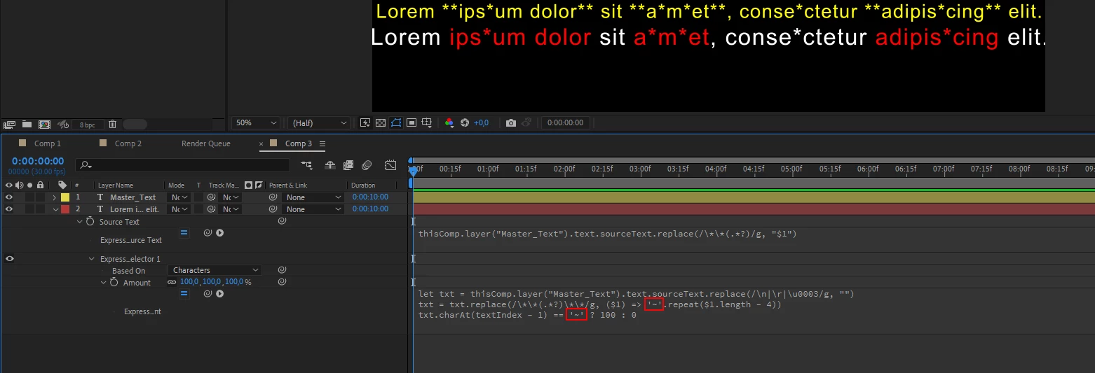

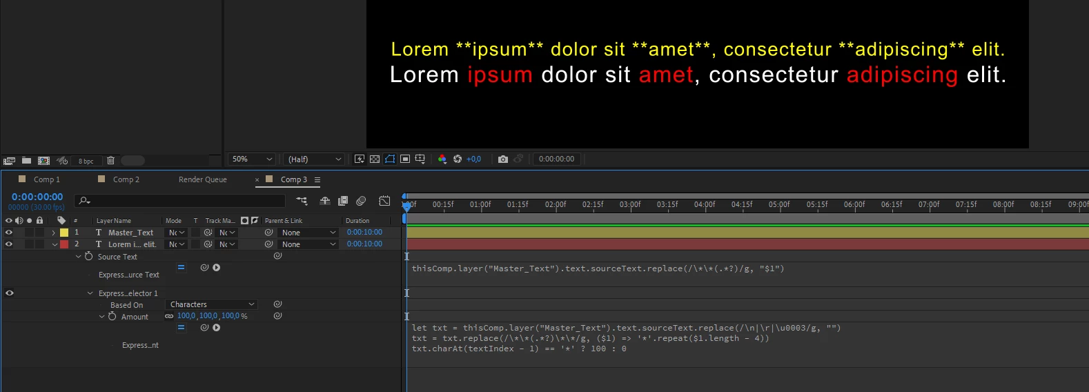

Jul 15, 2024 6:26 PM UTC
Maybe something like this:
 source text expression:
thisComp.layer("Master_Text").text.sourceText.replace(/\*\*(.*?)/g, "$1")
Amount expression:
let txt = thisComp.layer("Master_Text").text.sourceText.replace(/\n|\r|\u0003/g, "")
txt = txt.replace(/\*\*(.*?)\*\*/g, ($1) => '*'.repeat($1.length - 4))
txt.charAt(textIndex - 1) == '*' ? 100 : 0
BenterAAuthor
Jul 15, 2024 7:04 PM UTC
Thanks a lot for your support, Airweb! Seems to work! Unfortunately it seems that this solution doesn`t allow the use of one single "*" as regular character in the text (which has to be an option)?
Jul 15, 2024 7:21 PM UTC
I updated the code above a few minutes ago, it should work.
