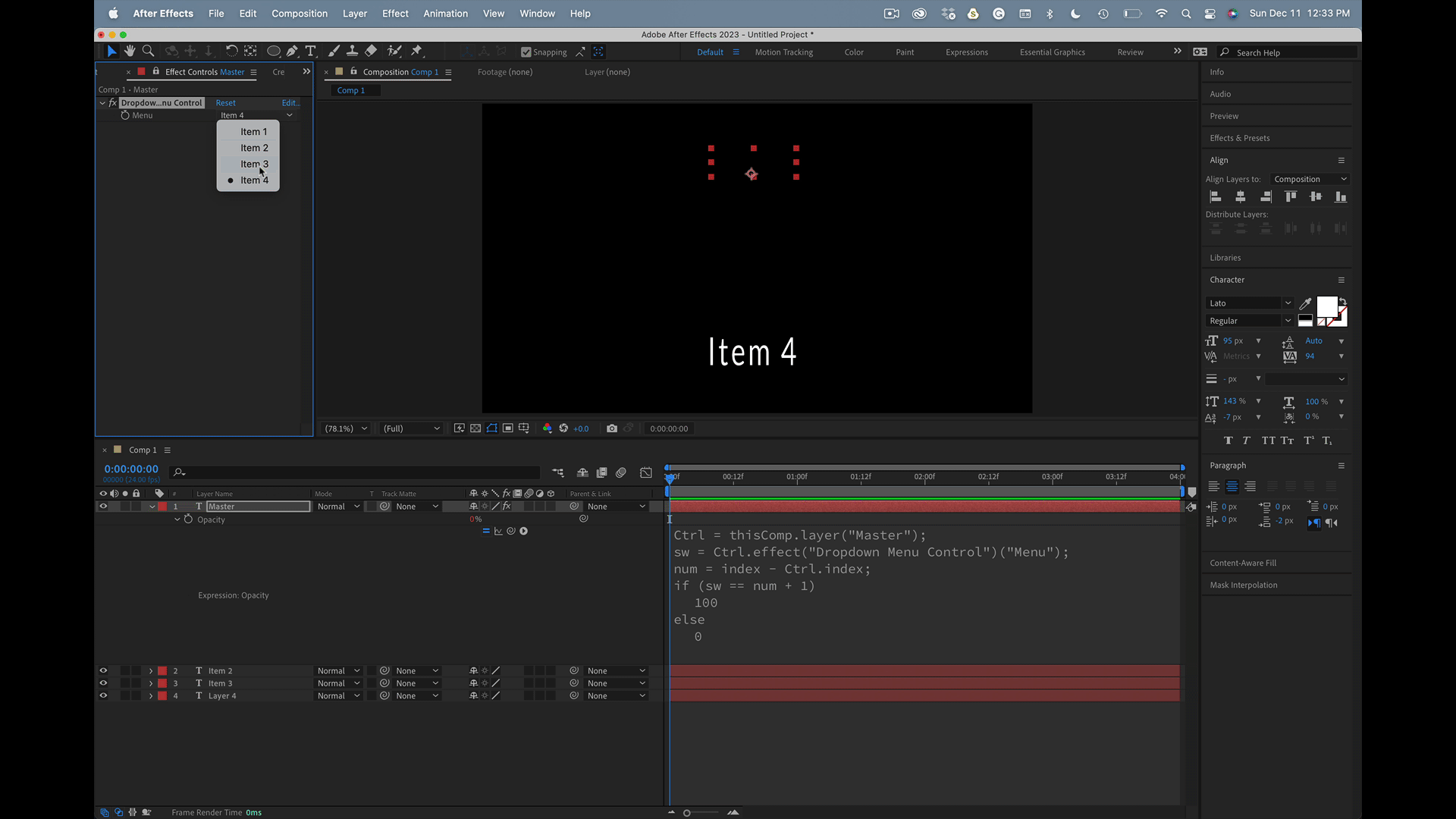

If you have multiple layers, a Dropdown Menu Control would be a better option. Put it on the Master layer, then stack the other layers below and add this opacity expression to all layers you want to control. The only other editing you need to do is to add enough items to the list to count all layers.
Ctrl = thisComp.layer("Master");
sw = Ctrl.effect("Dropdown Menu Control")("Menu");
num = index - Ctrl.index;
if (sw == num + 1)
	100
else
StormyCPbAuthorCorrect answer
