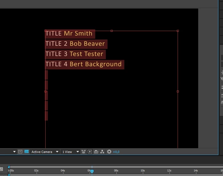

Thank you for you reply Dan! I have attached a picture of what I am working on, for simplicities sake. I am creating a text frame and paste all the text into it, then I want to have the expression type all the lines, from top to bottom. Each line will be coloured according to the attached picture, IE a total of two different colours being used. I need to do this with several text frames, so it would be great to have a simple as possible work flow.

Assuming your text is white, you should be able to do it with a yellow Fill Color animator and an Expression Selector with this for the Amount:
if (textIndex > 6) 100 else 0
You'd have to adjust this, based on the length of the TITLE part, unless you can come up with a clever algorithm to detect it automatically (which would be easier if the first one was "TITLE 1").
