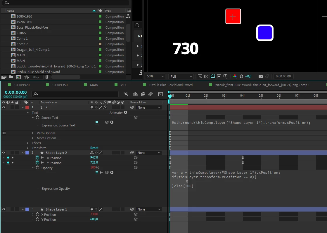

Hello!
I have this expression on my Opacity parameter
var a = thisComp.layer("Shape Layer 1").xPosition;
if(thisLayer.transform.xPosition == a){
}else{100}
  Its mean that if my second shape layer will be in the same X position as first shape layer it will disappear
But expression is doesnt work
I thought that AE can`t get number from layer, but I pickwheeped his xPosition to Source Text cuz I want to check it and its work
I have no idea whats I`m doing wrong, pls help :(((

Such comparisons are always exact matches and your approach is simply unsuitable to solve a geometric issue, even more so in 3D. The slightest discrepancy in the numerical values, be that just a thousandth fraction will stop it from working. You need to filter this through a linear() expression or measure the distance with length or combine both methods. Something like this would work:
refPos=thisComp.layer("Shape Layer 1").xPosition;
myPos=thisLayer.transform.xPosition;
mDist=length(refPos;myPos);
linear(mDist,0,0.5,0,100);
Point in case: You need to give it some tolerance like in my example where it's half a pixel or else the conditions may never be met during animation.

It simply measures the absolute distance and if it's below 0.5 pixels, the opacity is lowered to 0 with only a tiny "slope" inbetween. This could be further refiend in any way you want, including making a true hard switch with a Math.floor() or including additional conditions.

"mDist" is smth like divide two numbers and get distance between two layers?
MoistoffAuthor
October 28, 2022
I tried to write a number instead of my variable and its worked, but its not good for me
I have a 900 layers and moving object, those 900 layers must dissapear then reach position from my moving object
