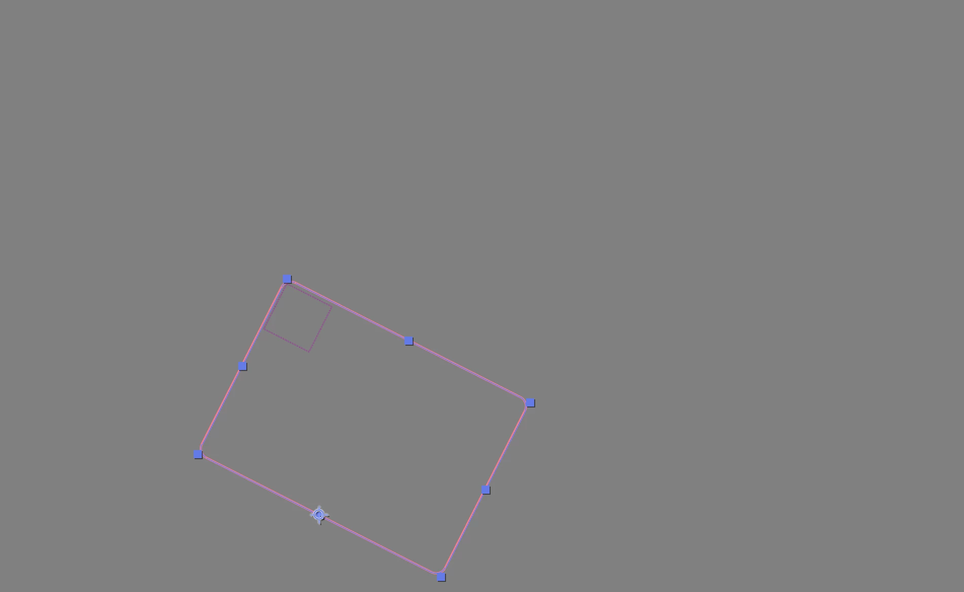

This hopefully describes the problem. I have a layer (could be a shape layer or a precomp) that is rotating from the anchor point at the bottom. I have a null (purple box at the top left of the shape layer) parented to this rotating shape layer. When I try to get the coordinates of the null object, it only gives the coordinates of the null relative to the anchor point of the shape layer, the layer it's parented to.

The actual Position of a child layer ("Null 1" in this example) is retrieved by using the toWorld(AnchorPoint) function like this:
L = thisComp.layer("Null 1");
pos = L.toComp(anchorPoint);
If you need more than that, we need screenshots with the modified properties of the problem layers. Select the layers, press the 'u' key twice, then take a screenshot of the entire UI and share it.
