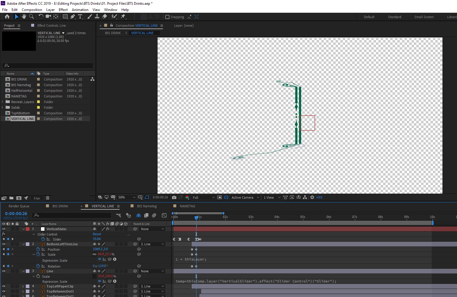

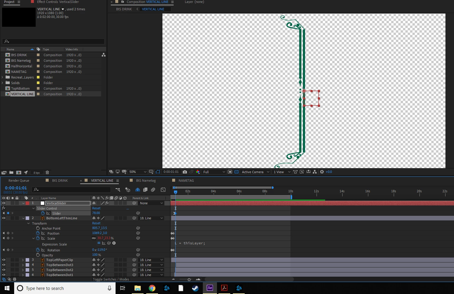

Sadly this doesn't seem to work:
You can see that as I move the slider, the one "dangly bit" with the expression on it becomes wildly distorted, moreso than without it.
But we're on the right track! Do you know where to go from here?
Dan Ebberts
January 17, 2019
My guess is that it has to do with skewing that happens when you combine rotation and non-uniform scaling. I'm not sure what to do about it though.
Dan
