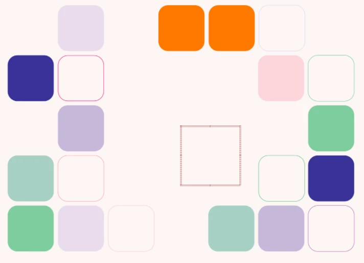

Hi all,
i'm trying to animate squares on a grid. They should switch between fill on and off and as consequence stoke shloud do the opposite. If fill is on then stoke is off.
At the end this should be controlled by the length of a marker and randomly continue,
If the marker is 5f long then the triks should happen randomly after Nx5 frames where N= is a random value.
How can i do this?
Thanks

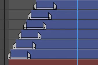

Here we go...this is what i need. Thank you. I knew this techniqe but it didn't cross my mind.
I use a tool to control shape and stroke colors that generates animation based on markers lenght so it wuold be nice to use them in order to be able to manage the timing. So every 5f (markers lenght) the magic happens but instead whit Fractal noise it can't be done.
