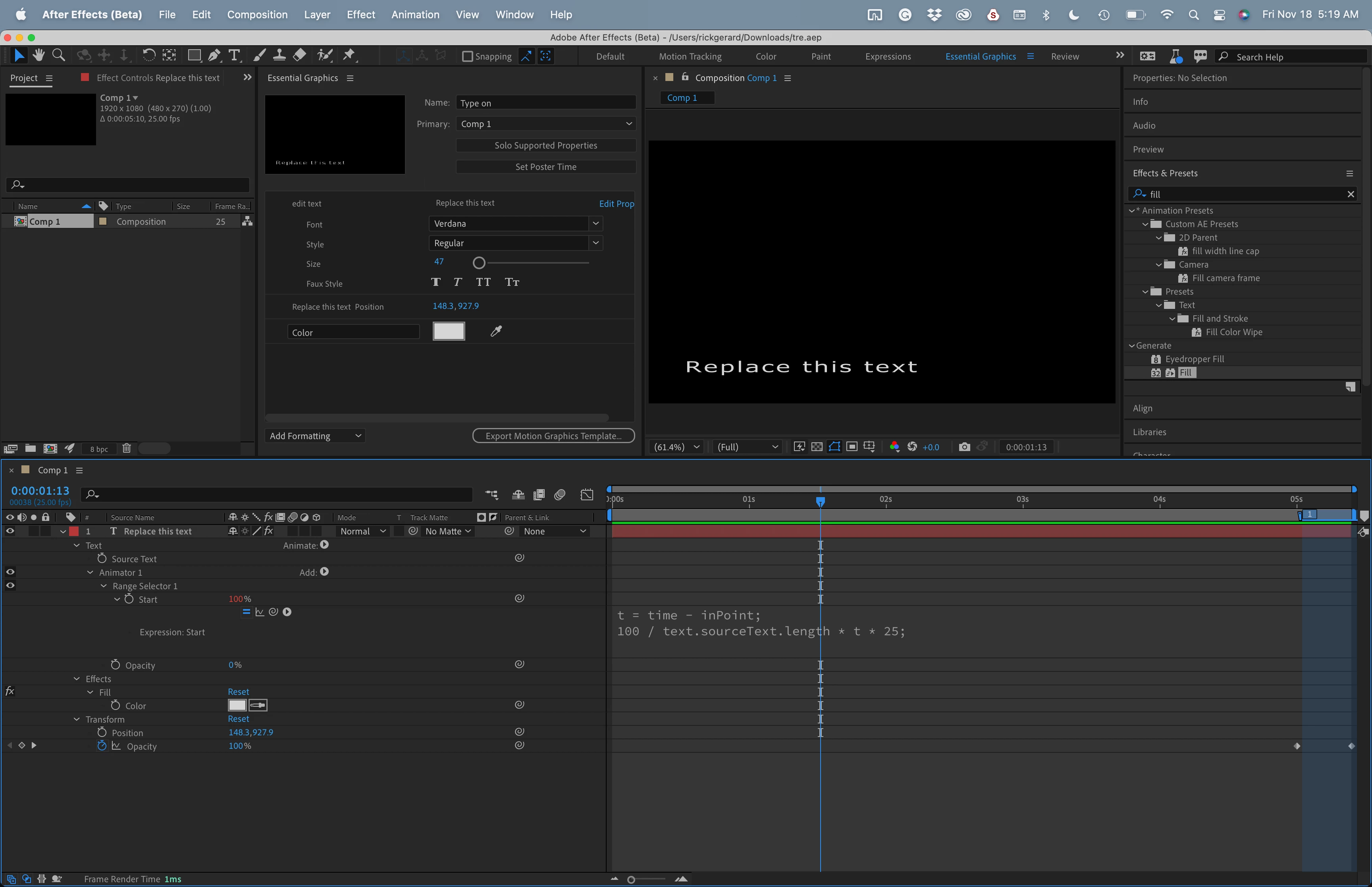

Do you have a working example of an AEP/MOGRT together with a PPROJ?
You should only need two protected regions and a space between them. Try this project file:
I've uploaded a 22 and a 23 version of the project. MOGRT files are not compatible with the uploads, so you'll have to save your own.

All you should have to do is add a comp marker one or two frames before the end of the comp and set that to the only protected region. You can also simplify the expression. I would use the layer in-point like this:
t = time - inPoint;
100 / text.sourceText.length * t * 25;

Thank you for your help. Unfortunately, with this solution, I can no longer extend the sequence in Premiere. And if I use your AEP file and export the template without any changes, than I can indeed stretch out the sequence in Premiere but the longer the sequence the slower is the animation.
What I wanted to achieve was a template with which you can set a text in Premiere that is always animated at a constant speed and holds at the end for as long as needed without having to make a cut, add a frame hold and extend the frame hold (the final MOGRT would have more text and other things in it, but that one line is the minimum to try if it could work at all).
Or at least if this is not possible, I would like to understand why this particular expression does not work with the protected region and is not responsive. Is "time" the keyword (and if so, are there more?) that cannot be used when a MOGRT should be "responsive"?
November 22, 2022
Try putting two protected areas. Protect the first 4 seconds and the last 1/2 second. The first protected area needs to protect the longest animation you will need. The last lets you stretch out the middle where there is no animation. You can always Cut the graphic if it is too long.

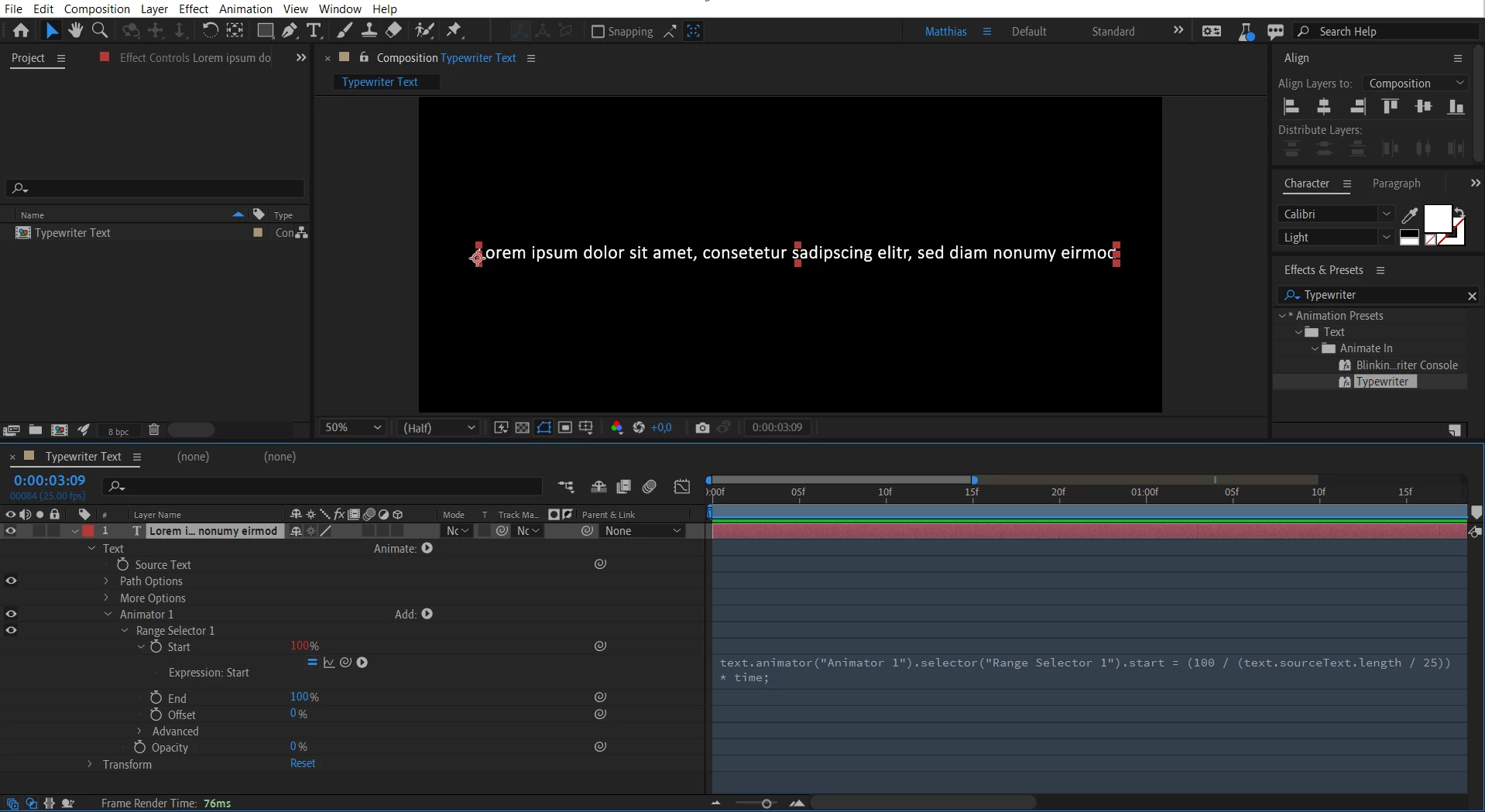

I think it would be helpful if you posted screen shots of how you have things set up in AE. It seems like it might be possible to account for any stretching by basing your calculation on the duration of the protected area marker rather than on the global time value.
<edit> Actually, try replacing your expression with this and see if it makes a difference:
(100 / (text.sourceText.length / 25)) * (time - thisComp.marker.key(1).time)
November 17, 2022
I created a small example project and a screenshot. Thats's what I did:
1. Create composition, add text layer
2. Drop Typewriter effect onto text layer
3. Remove keyframes and insert expression
4. Create protected region
