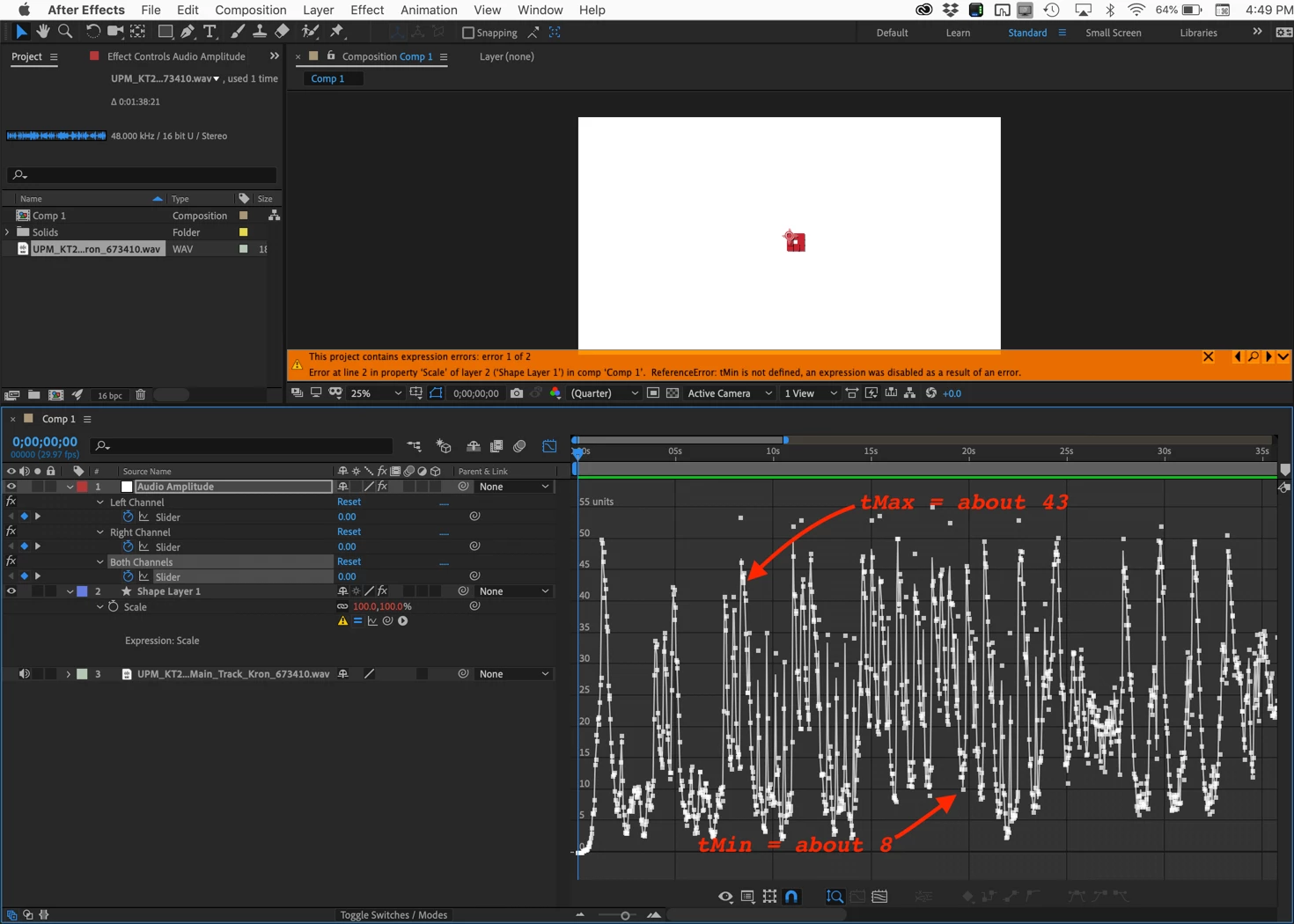

To figure out what values you should be using for tMin and tMax it is a good idea to pick the ("Both Channels")("Slider") in the graph editor looking at only the value graph and choose the minimum and maximum values you want to use to trigger your effect. Here's what a typical graph of the Both Channels Slider would look like:

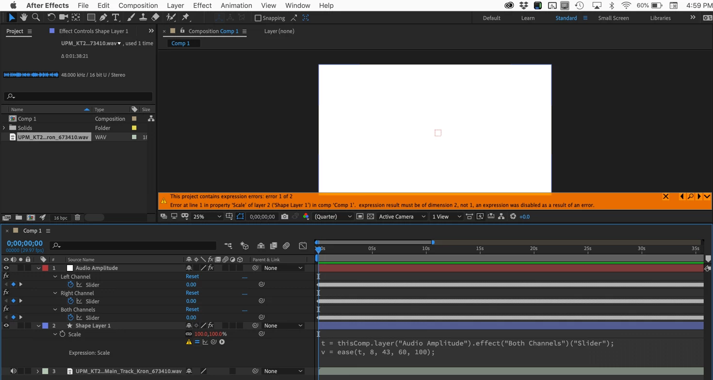

This music swells from zero to a maximum value of about 55. I want the start of my animation to happen at about 8 and the maximum value to happen at about 43 so those would be my tMin and tMax values. I am applying this effect to scale. Scale is always an array of at least 2 numbers, but if the layer is 3D then there are 3 values. To fix the expression error I need to add the values generated by the ease() method into an array and set a minimum and maximum scale value for value1 and value2. I don't want to go above 100% scale so that will be the value for value2, and I don't want to go below 60% (your choice here) so that will be the value for value1. We're almost done. So far the expression looks like this:
I still have an error because I have not generated the array. For this project, I want to only scale in Y so the layer grows from the bottom in time with the music. I set the anchor point at the bottom of the layer in the center and then complete my array like this:

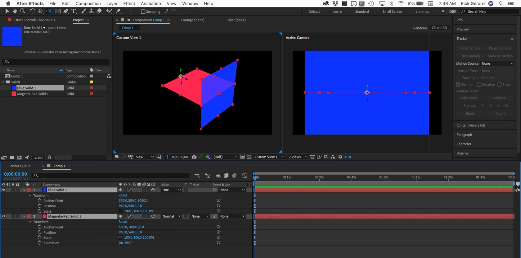

Now let's talk about scaling in z.  Run this test on a couple of 1000 X 1000 pixel solids in a standard HD Comp. Set them up like this:
As you can see the anchor point of the red solid has been set to 1000, the bottom of the layer and the red layer has been rotated 90º on the X-axis. The Blue layer has had the Anchor Point changed from the zero, layer center, to 1000 and that moves it 1000 pixels toward the Active Camera. I changed the blend mode to Hue to make it easy to see when the layers perfectly lined up.

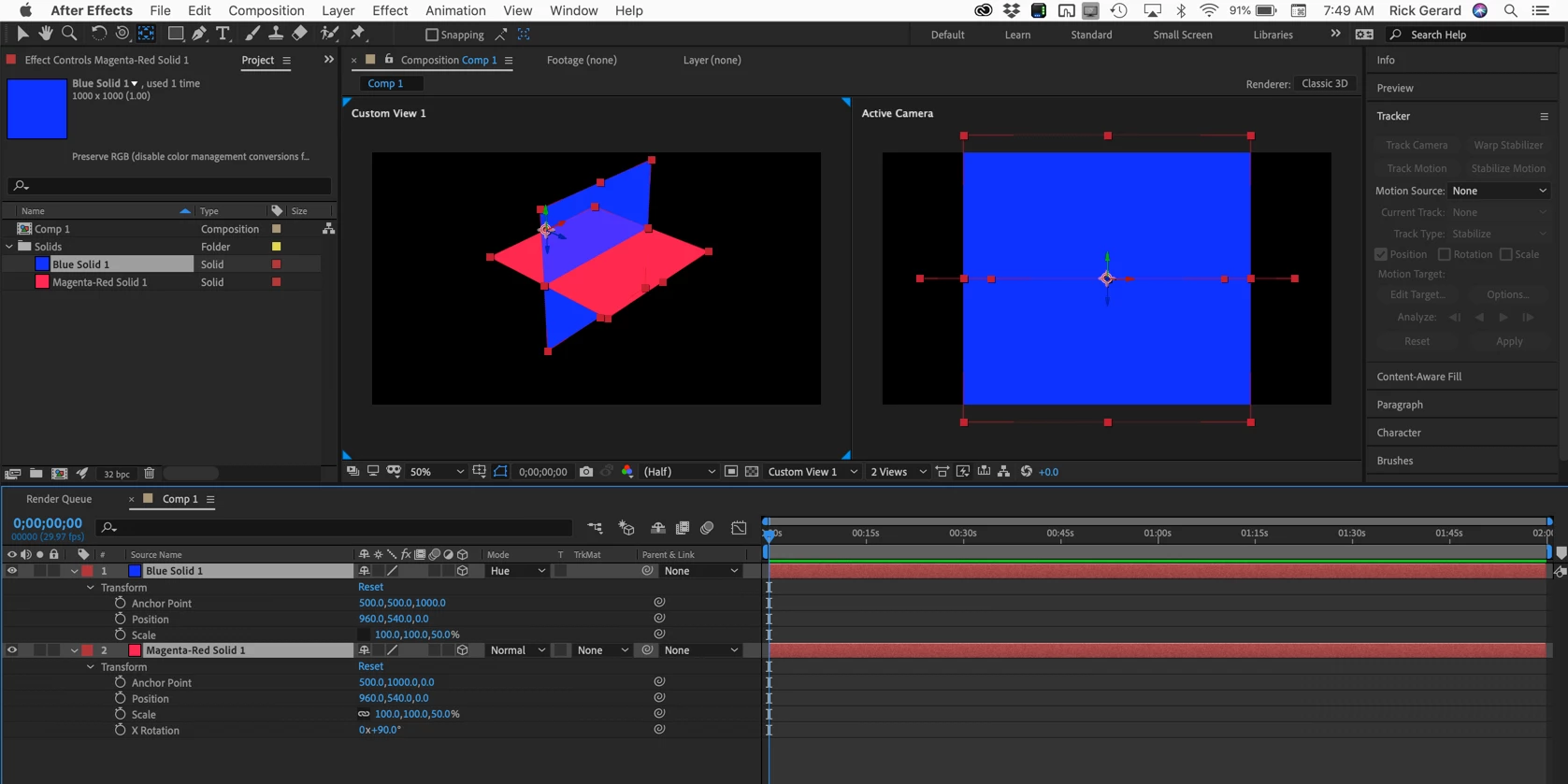

Now change the Z scale of the blue solid to 50% and you get this:

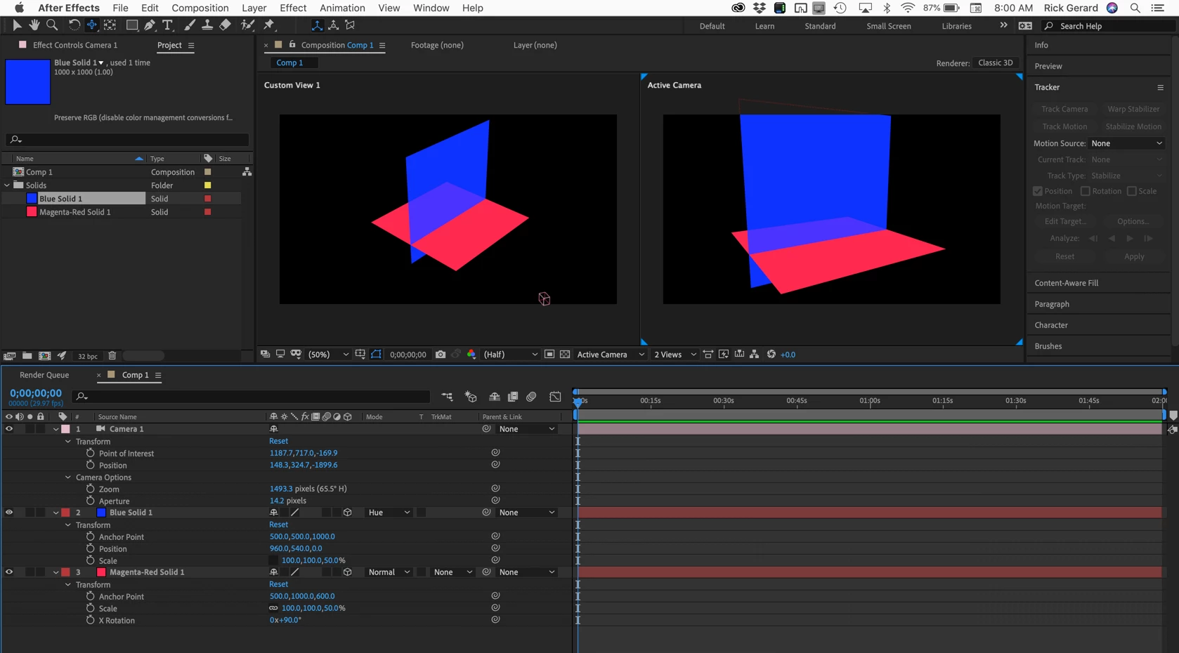

Because the blue layer is perpendicular to the Camera (active camera) the only apparent change in the blue layer is the size of the layer. If you move the red layer down or add a camera and offset it so you can see some perspective in the red layer you will be able to see that the blue layer is moving on the Z axis like this:

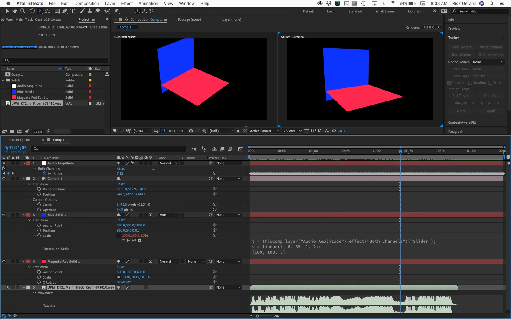

Adding an audio track and converting audio to keyframes and adding the expression I showed above will give you this:
You can see from the waveform that I have moved the CTI to the loudest part of the audio track and the scale is 2% in Z. At the lowest part of the audio track, when the value is 8 or lower, the scale is 1%. This makes the movement along the Z-axis very small. You almost can't see the difference.
Leave "value1" at 1, because a z scale of zero will make the layer disappear)  and change "value2" to 100 and the layer will move from the back edge of the red solid to the front edge like this:
