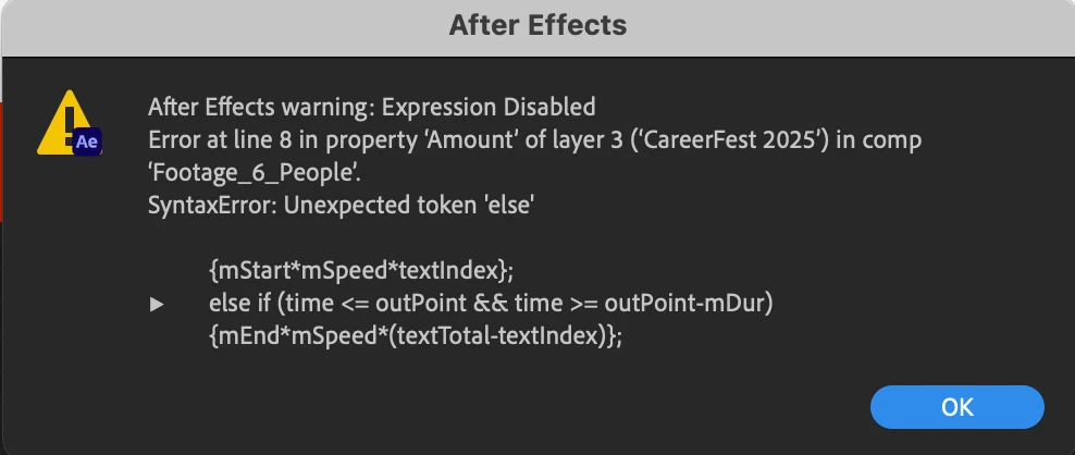

Mylenium
shmithsAuthor
Jul 4, 2024 9:05 PM UTC
Thanks, this gives me an error-
