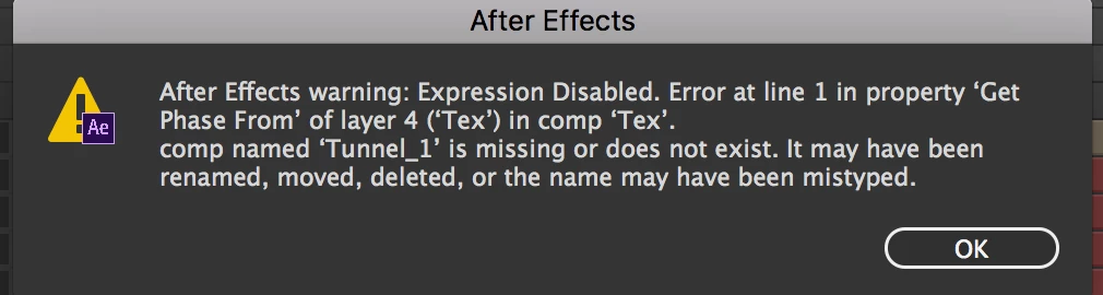

December 13, 2016
If you have renamed layers in some versions of AE you force a line feed. This can be removed from the layer by selecting the layer name, pressing enter, then delete twice, then name the layer again.
If you expression looks like this:
comp("Tunnel_1").layer("MIR").effect("Mir")("Scroll Y")
some new code;
some other code;
Then you have a forced line feed that either must be fixed by editing the expression. You have to have a ; at the end of each line of code and you cannot force a line feed or the expression will break.

Hey Rick, thanks for your quick response.
The error message below doesn't help much because the comp "Tunnel_1" does exist in my project - so I assume AE just doesn't understand the value I'm feeding it.
I played around a bit more and it looks like the only values that cannot be linked to the Target Comp through an expression are the ones being altered by an expression in the Source Comp. Tried it in AE 2014 and the same error appears. I guess I never linked expression generated values between comps before - that explains my confusion.
