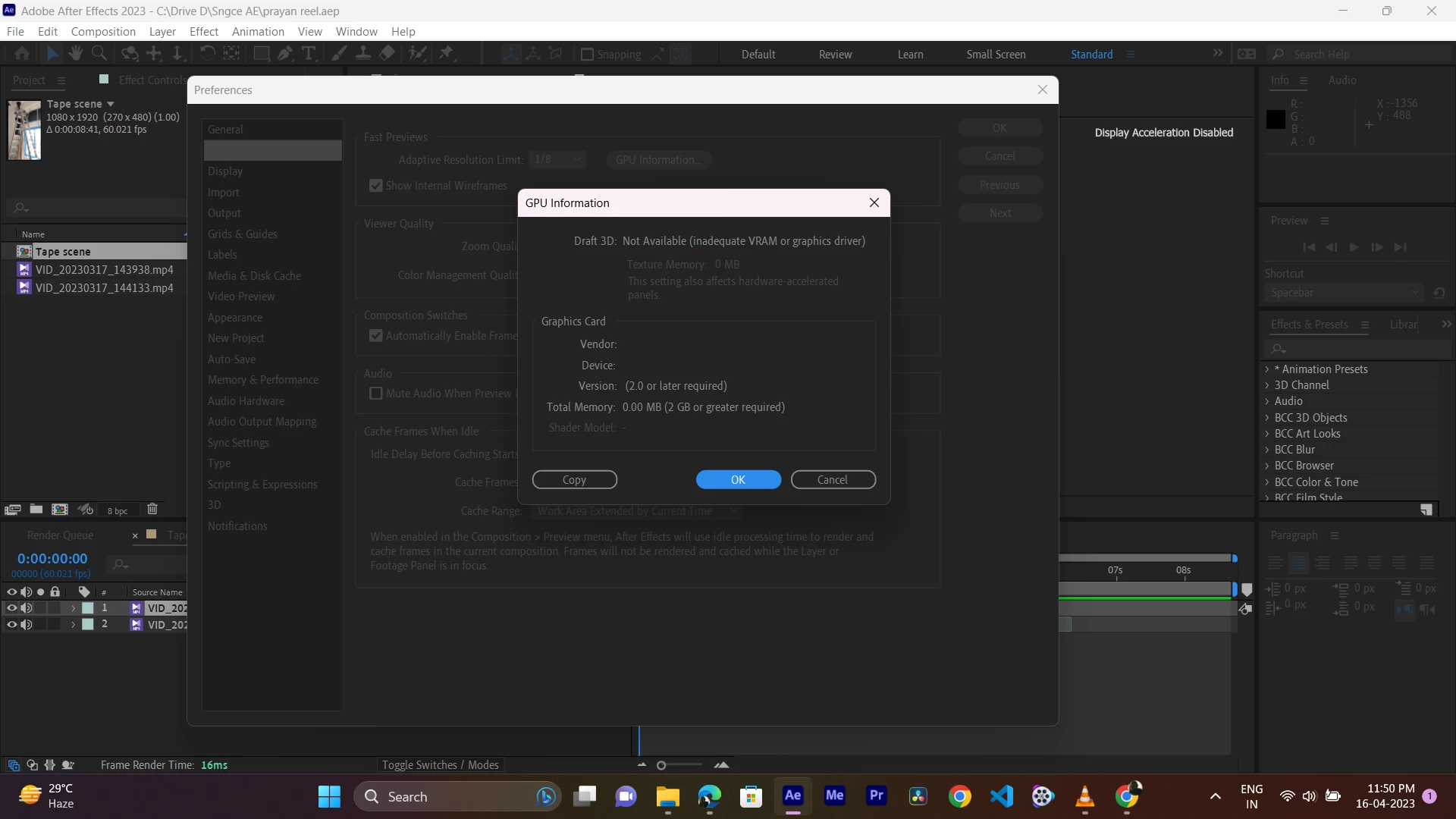

April 16, 2023
I'm facing the same issue in my After Effects 2023, even though I'm using a laptop having intel i5 1240P processor, NVIDIA RTX 2050 4GB DDR6 GPU. Can you please help me out...

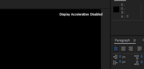

Hey guys this software is frustrating I need help
Display is disabled I have tried everything here it is not working out

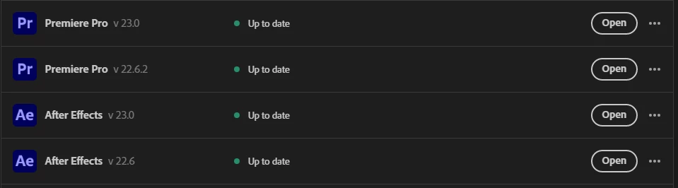

Hi guys, it's 2022, this problem is apparently recurring almost every single version of After Effects that comes out. I found the solution and the reason of the problem and it's so 'face palm' material you'd think corporations would think about this.
The issue stems from the disconnect between graphics drivers and After Effects updates. Basically, you need both AE and Graphics drivers to 'sync' over the year. General rule of thumb is NOT to update Premiere and After Effects for at least a few months until things 'smooth' out because you get stupid issues like this, every... damn... year.
Observe:
After Effects 2022 (22.6)
After Effects 2023 (23.0)

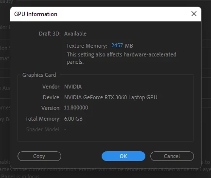

I have Geforce 3060 Laptop GPU. I have both AE installed and only 2022 work with graphic acceleration. 2023, I have the annoying Display Acceleration Disabled issue which means I can't playback properly, slow rendering, even slower updates to the viewport sometimes the viewport doesn't update. That's because it's defaulting to 'Software' instead of GPU.

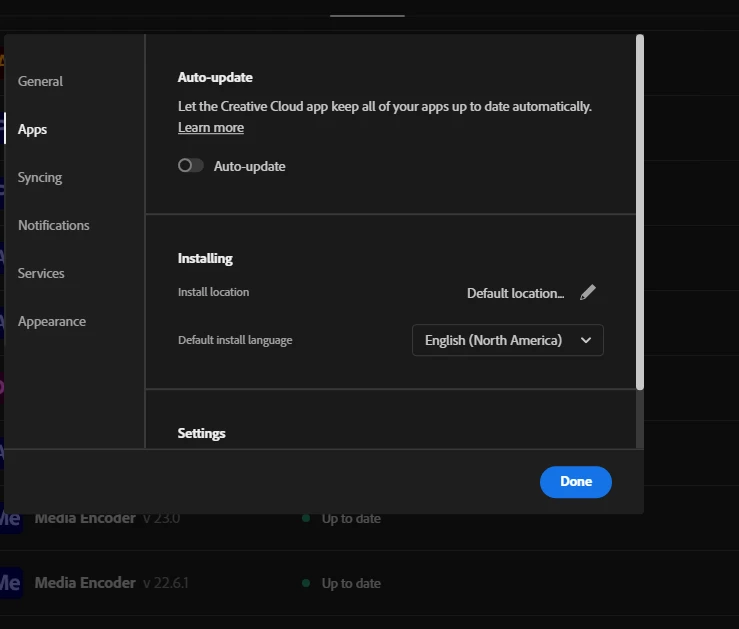

Solution:
- Updating your graphics driver is generally fine but what you should do is roll back your After Effects to the previous version and stick with it until the stupid bug is fixed. This is mine.
- Some people get this issue because Adobe CC automatically updates After Effects for you leaving you with issues between Premiere and After Effects which equals sadness. Make sure Auto Update is disabled.
I shall receive all thanks and gratitudes in 'You rock' or equivalent praises.

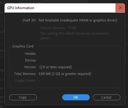

i've the same problem can you tacke look on my infos plz & thank's :
https://shared-assets.adobe.com/link/ca1c979b-1453-477b-6766-216cdf8513b8
