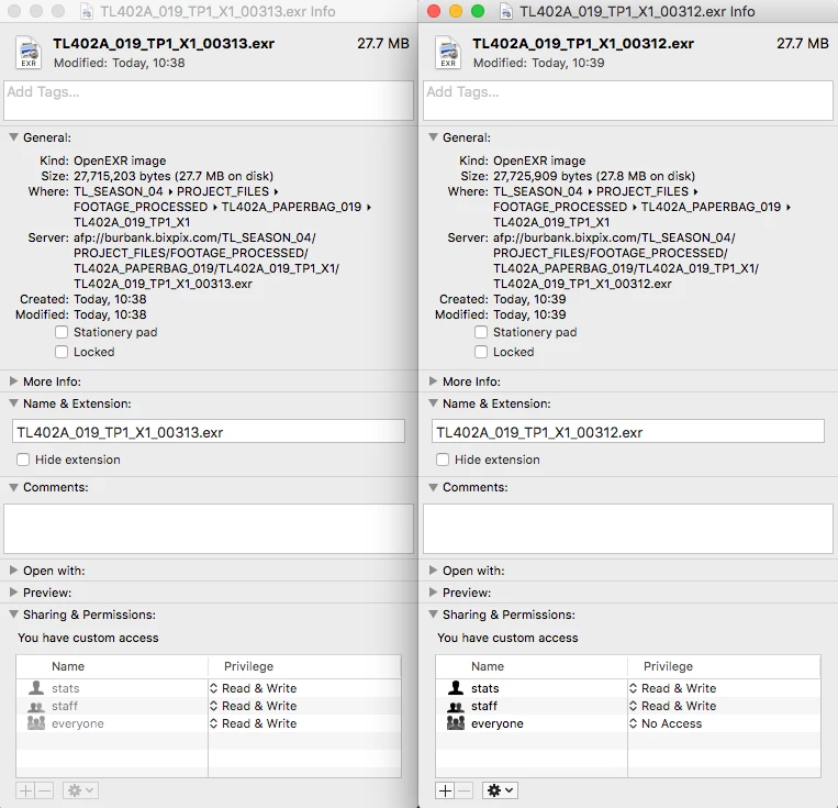

To illustrate, here are two files in an image sequence rendered from After Effects using a render farm, but the left one was from a machine running AE 14.1 and the right one was from a machine running 14.2.0 (and both machines running OSX 10.11.6):
Any user that's in the staff group (so any local user account on a Mac) is fine, but in any more complex environment you've got users who have zero access where before they had RW. And either case is different from every other file I've looked at, including those generated by the OS like folders, and those generated from other CC programs like Photoshop - the standard is user: RW, staff: R, everyone: R. I've also checked the newest 14.2.1 update and the issue is the same.
