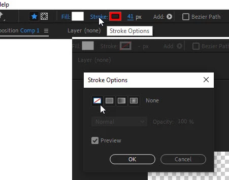

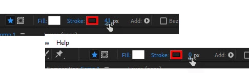

Correct answer imeilfx
Your shape is correctly fitted into your composition. You have 41pixel black stroke around your shape and stroke is outside of your shape.
So if you need your stroke - everything is fitted correctly as it is
- if you don't need stroke - just turn it of
or lower stroke width to 0 pixels
and then fit to comp.
February 29, 2020
Oh wow.. Sometimes it's so easy to think it's my lack of experience with this program that I miss these stupid mistakes..
