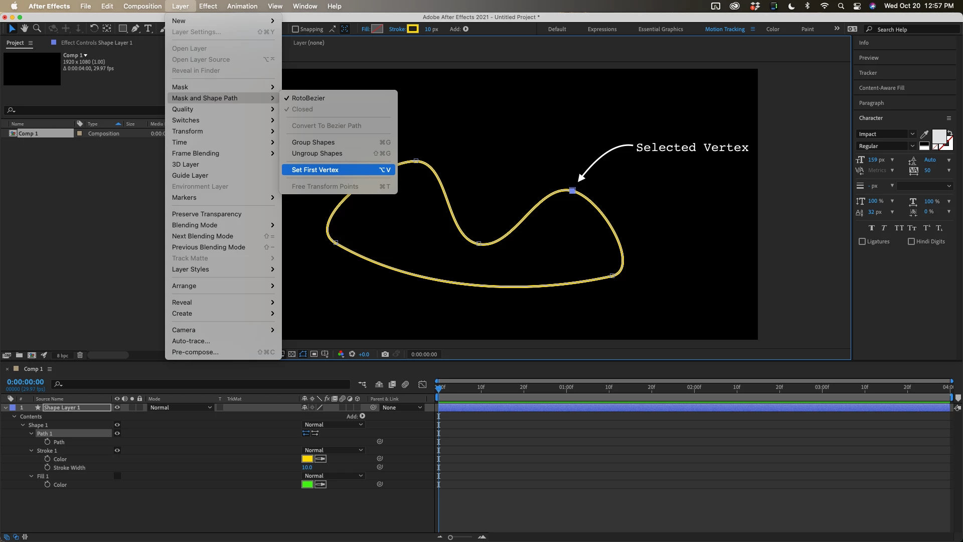

To fix this, you need to manually set the starting point. First, reveal and select the path in the timeline, then activate the Selection Tool (V). Hover near the vertex you want as the starting point until the cursor changes to a white arrow, then click to select that vertex. Next, right-click on the selected vertex and go to Mask and Shape Path > Set First Vertex.

If you reveal and select the path in the timeline and have the selection tool (v) active, as you get close to a vertex the cursor will change to a white arrow. You can then draw a selection around the selected vertex and go to the File/Mask and Shape Path/Set First Vertex and change the first vertex.
That should fix your problem.

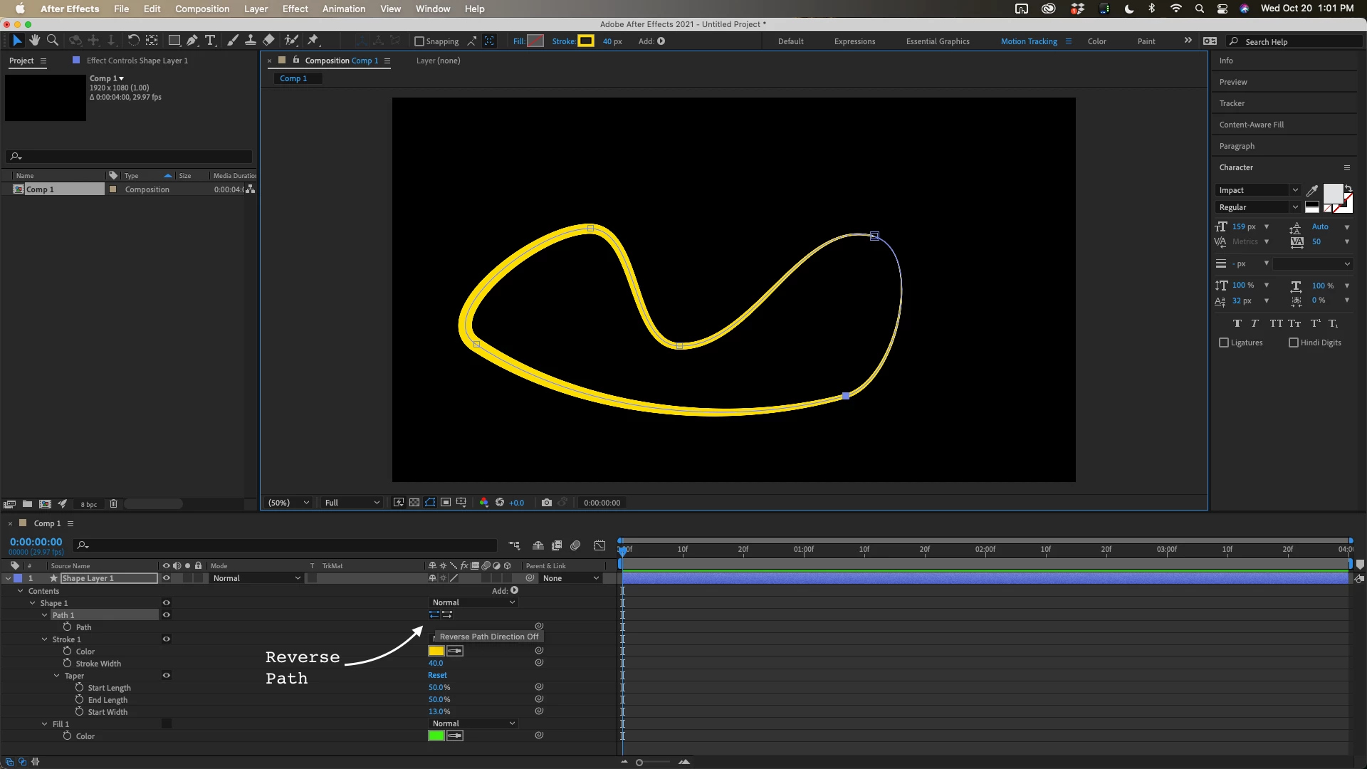

You can also change the direction of the path by changing the direction options in the timeline:
Hopefully, that will solve your problem.

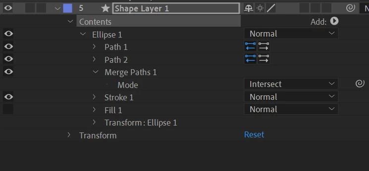

But this time I was able to narrow it down. The merged path is causing this problem, even when the paths aren't intersecting.

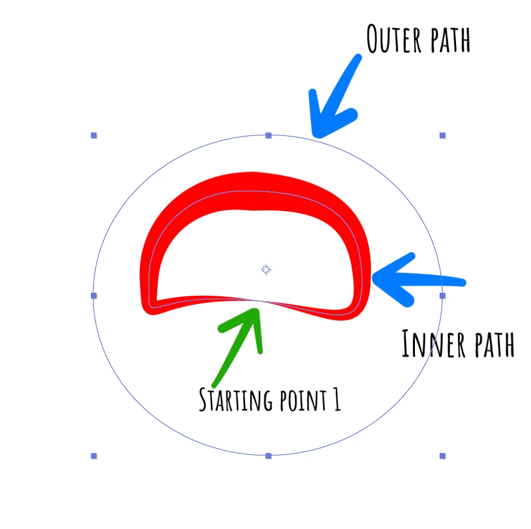

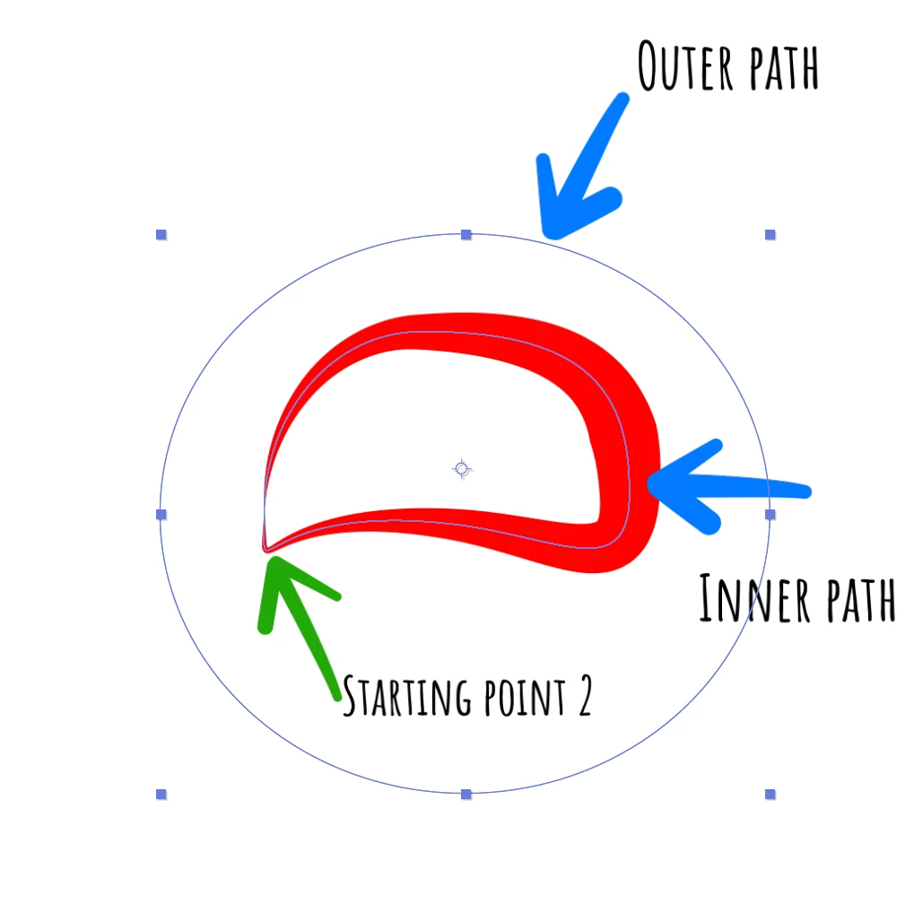

As soon as I move the points around a little bit, the starting point changes (see the image below):
You can clearly see that the paths above aren't even intersecting. However, when I am using a simple path (without MERGE PATH operator), the issue isn't replicating.
Do you think it is an issue with After Effects, or am I doing something wrong here?
