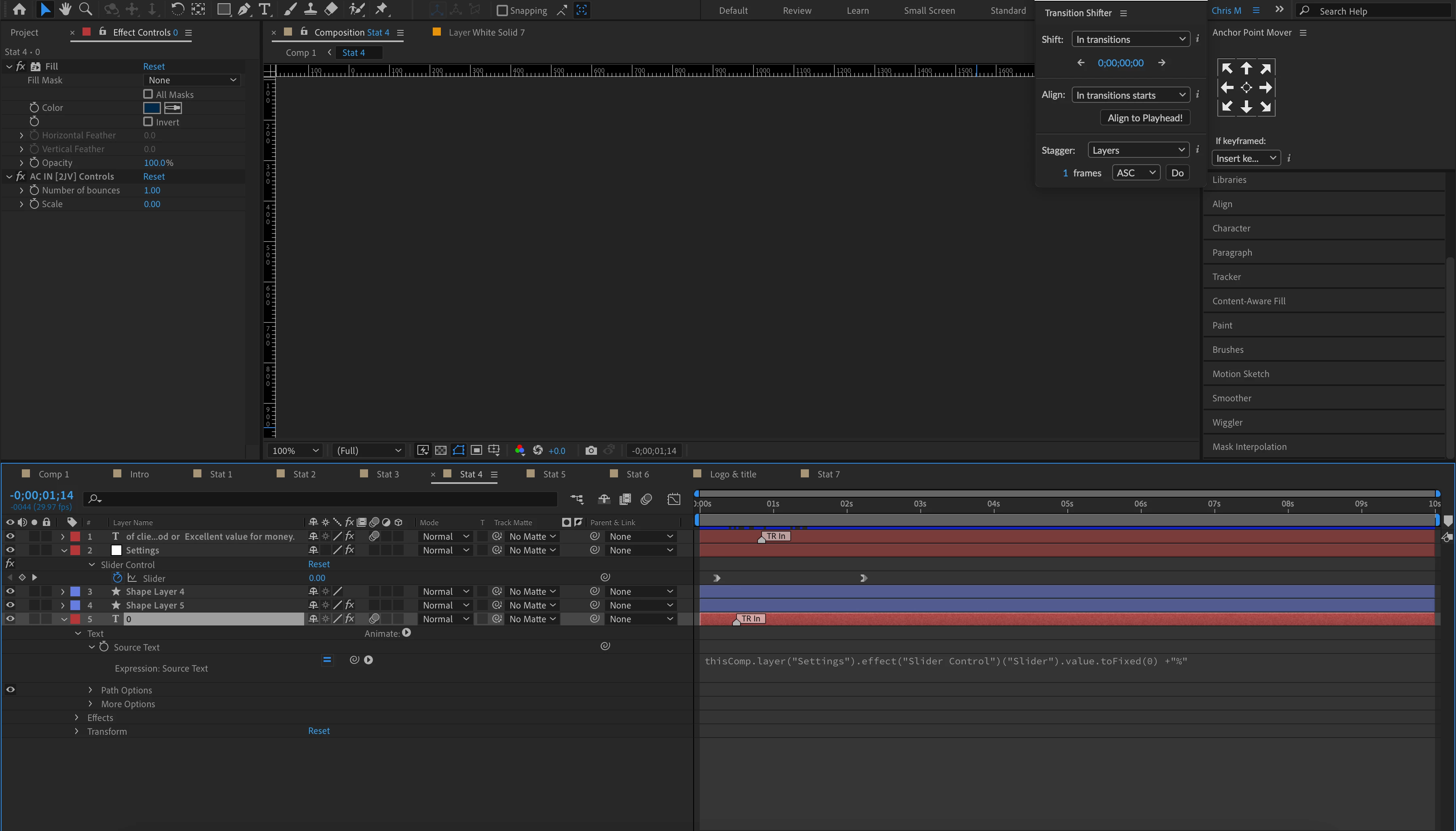

I have created a slider control to count down from "£20,000 remaining" to "0 remaining" however the font is in a bold weight but I would like the word "remaining' to be in a light weight.
Here is my code:
"£" + effect("Slider Control")("Slider").value.toFixed(2)+" "+ "remaining"
Any ideas? New at expressions and coding!
Thanks
Rick GerardCorrect answer
