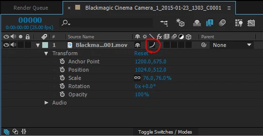

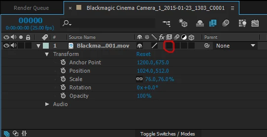

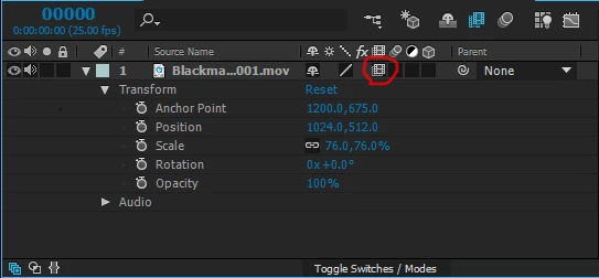

Hello!
     In Adobe After Effects CC 2014 I cannot understand which of the following icons is for advanced pixel motion blending method. Could you help me on this?
I am attaching the relevant picture files.
Thank you!!
Yiannis.
Correct answer adamneer
I believe picture 1 (the film frames icon) indicates standard tweened frame blending (combined frames using dissolved opacity)
picture 2 (forward arrow icon) indicates pixel motion frame blending
picture 3 means no frame blending enabled
picture 4 (curvy line) indicates bicubic sampling for layer quality.  This is a newer feature added in 2014 which greatly improves the quality of scaling/rotating a layer.  I always enable this for any scaled or rotated footage.

Adam is correct. This is also explained in the help files, though it seems the page hasn't been updated to include all info:
After Effects Help | Managing layers
