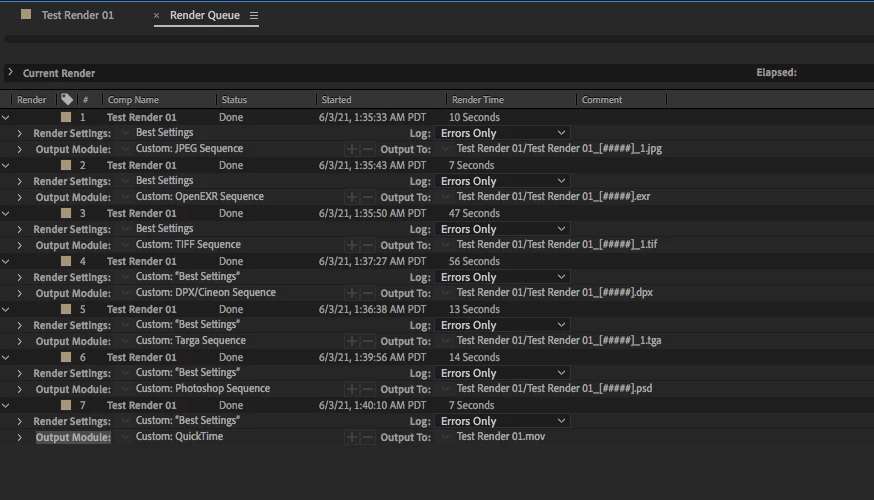

PNG sequences had problems with a few builds of AE. So did JPEG images. You did not mention the version of AE you are using or your system specs or OS. If the slowdown is progressive you could be having resource problems. If it is constant and you are rendering to an external drive you could be having connection problems. I would run a few tests with a fairly simple comp. Some animated text and animated shape layers, motion blur, and maybe an adjustment layer with color correction. Make the comp about a minute long, add it to the Render Queue, then try a few of the different image sequence options and see what is the fastest. Here is a test I just ran and the results:
Open EXR and Custom Quicktime - GoPro Cineform tied for first at 7 seconds. Second place goes to the default JPEG sequence at 10 seconds. The clear losers were Custom TIFF and DPX at 47 and 56 seconds with the rest of the tests coming in between 13 and 14 seconds. These results were about what I expected. Open EXR and GoPro Cineform are my first choice because I almost always create my DI (digital intermediates) with at least 10-bit color. I don't remember the last time I rendered a JPEG sequence because they don't support Alpha or high bit depth (JPEG 2000 is the exception). If you are trying to figure out the most efficient workflow, run similar tests on your system. Using nothing more than shape layers and text will eliminate the variables to render times caused by the source footage. I've had a lot of footage over the years that were so slow to process into pixels that I transcoded it to a different format before even trying to use it in a project.
I don't edit movies or create sequences longer than a phrase or sentence of narration in After Effects so I can't remember a time when I ever had an AE project that lasted more than 30 seconds. Most of them are under seven seconds. I worked on one on Monday that was only 32 frames. Even if I produce a 30-second ad for TV entirely in After Effects, the final edit is always done in Premiere Pro because I always have to be especially careful with the final color grade, sound effects, audio track, and the timing of the cuts. The comp you appear to be rendering would be over 10 minutes at 30 fps. You might want to consider breaking it up into smaller pieces.

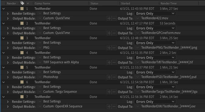

Mac Pro 2013 6-Core, 128GB Ram, Dual D700
After Effects 18.2.0
Render Garden 1.2.0
Rick, thanks for the thorough response (as usual). Running these tests has opened a whole can of worms.
I'm just surprised how slow frame rendering is versus rendering out a MOV sequence. And I want to use Render Garden so I'm not tying up AE. In my memory, frame rendering (especially with RG), has always been massively faster. I ran a bunch of tests, and unfortunately, what I found was that Render Garden doesn't stack up with my Mac Pro. It seems like something has fundementally changed with AE Render Core? Or something else is going on with the computer?
The slow down is not progressive. As expected, it renders faster during more simpler points in the animation and slower during more complex moments.
My R/W on my render drive (700 r/w) is slower than my main working drive (900 r/w) but it's never effected render speeds before. I have to use AE for this because all the image moves and grfx overlayed are templatized. Most of the work I do is pure AE. The project is 60 fps because of client requirements.
For my TestRender comp, I threw some shape layers in and looped their animation over the 1800 frames. Motion blur. Color Balance adj layer. Text animates in over 900 frames and animates out over 900 frames.
Rendering straight in AE - GoPro Cineform was my fastest render. APR 422 and PNG sequence were my slowest.
Overall Render Time, approx 15 minutes to render all versions
Between my straight from AE renders, and my Render Garden renders, I purged the cache. For my Render Garden test, I ran 3 gardeners and did 5 seeds (per render type).
How'd it stack up?
APR 422 - exactly the same speed using RG 3:27 vs 3:27 AE
GoPro Cineform - much slower using RG 4:18 vs 00:53 AE
PNG - slightly slower using RG 3:57 vs 3:25 AE
TIFF - slower using RG 3:43 vs 2:02 AE
PSD - much slower using RG 3:35 vs 1:21 AE
TARGA - much slower using RG 3:05 vs 1:38 AE
EXR - much slower using RG 3:50 vs 2:14 AE
Overall Render Time, approx 19 minutes. On the Mac Pro, Render Garden is definitely slower and, in a lot of cases, much slower.
This is super weird, so I decided to run another test where I did ONE seed per render type. Still running 3 gardeners. This would treat RG as a background rendering tool, but allow me to render multiple render types simultaneously. This should, in theory, be the same speed as rendering straight in AE, with a slightly faster overall render time. This theory was proven wrong. In all cases, the render times were slower using this method than the previous two methods.
Overall Render Time approx 19 minutes
To be super clear, I decided to do a version where I did ONE seed per render type and running a SINGLE gardener. This should be the exact same speed as rendering directly in After Effects as there is no simultaenous rendering happening.
Overall Render Time approx 32 minutes
To make sure this wasn't computer based, I ran some of the same tests on a MacBook Pro 2018 6-Core, 32GB Ram, Pro Vega 4GB, running the same OS and same version of Render Garden and After Effects
It took approx 28 minutes to render everything directly in AE, everything is proportionally slower than the Mac Pro straight out of AE render test - though nothing near as fast for Cineform.
It took approx 13 minutes using RG on the MacBook Pro (much faster). 3 gardeners, 5 seeds per render type. Photoshop was the fastest and Targa was second fastest. This was two minutes faster than rendering on the Mac Pro.
For my next test, I made a 1 minute composition that is just solid black. Nothing happens. This should be lightning quick. It should also remove all variables to show what writes fastest to a drive. The two MOVs won out on both computers, I suspect for that very reason. For the image sequences, Photoshop was the fastest (within 10% speed of the movs). PNG was the slowest, but faster on the Macbook Pro. Overall, the renders took 9 minutes on the Macbook and 11 minutes on the Mac Pro. Running that same comp through the 3 gardeners, 5 seeds method yielded a faster render on the Mac Pro at 9 minutes and Macbook at 8 minutes.
Lessons: PSD seems to be always the fastest frame render. Not sure why. Cineform seems to always be slightly faster than APR (except for that first Mac Pro test).
Rick, what do you think is going on here? Render Garden / BG Render Pro / BG Render Max used to always out perform native AE rendering on my Mac Pro, but now, native rendering seems to go faster. Something else going on here?
