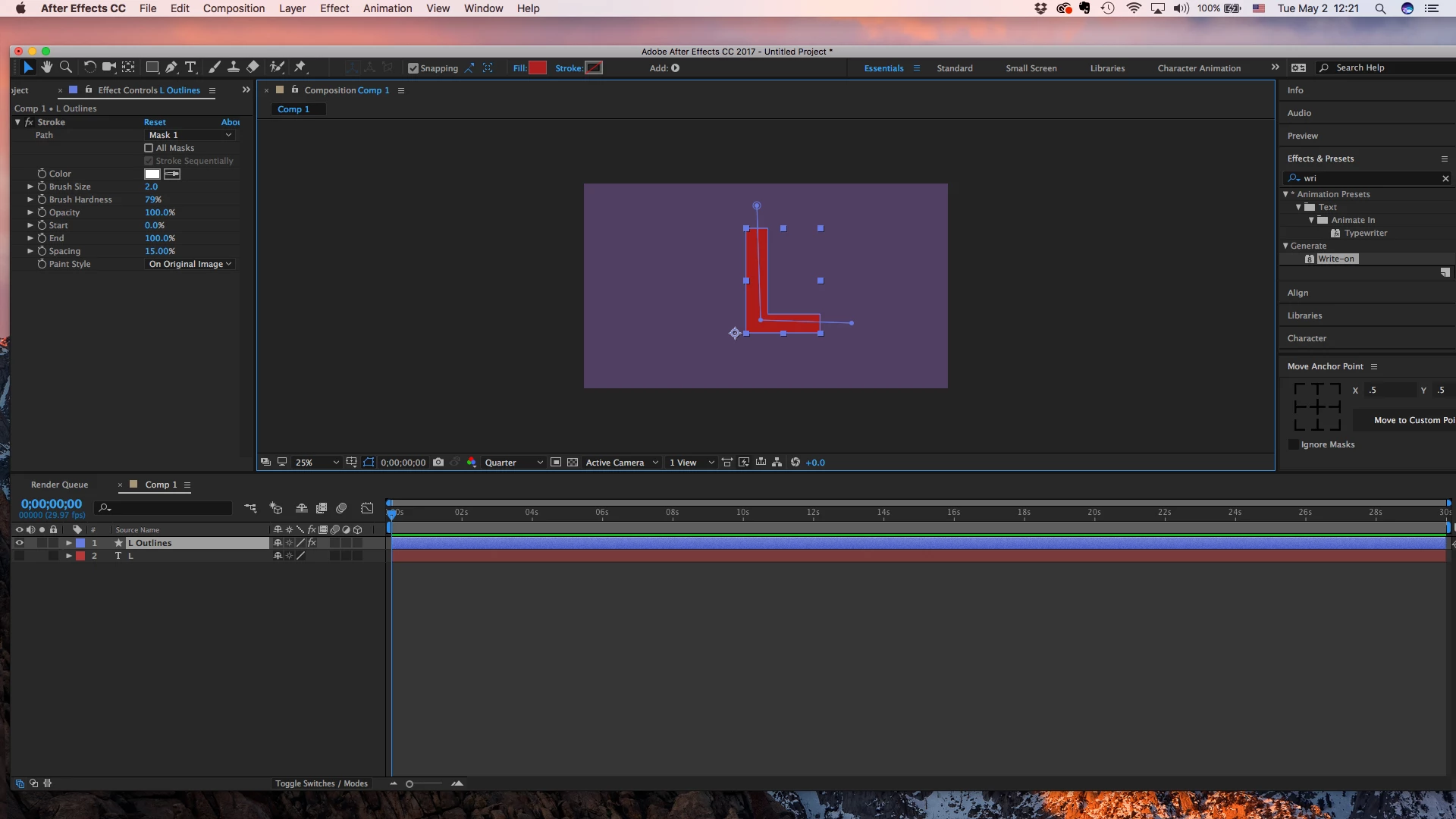

I am trying to create the write-on effect with Generate stroke effect over letters (letters have been converted to shapes) and when draw out my path it's not visible, it's just an empty path. Same thing happens if I use Write-on effect from the effects & presets menu.
see screenshot below. In all the tutorials that i've watched, the path takes on the stroke qualities that's in the effect, e.g. 2px white line. Here it's just empty path ☹ . Any ideas what's going on? I am using AE 2017
Thank you!

Well, I am not trying to animate the stroke. I am trying to reveal the letters like in this tutorial:
revealing = animating a stroke set to reveal.
to reveal a path with the stroke effect the method is this:
1. you create an open path with the pen tool on your layer. the layer does not need to be a shape layer, you can leave it as text.
if it is a shape layer, the pen tool and parametric shapes tool default to creating shapes and not masks. so you will create another instance of a shape group with a stroke and not a mask. you can change the behavior by clicking here when either the pen tool or parametric shapes tool are selected
2. apply the stroke effect. it will use mask 1 by default
3. increase the brush size, make sure it covers all the layer
4. set paint style to "reveal original image"
5. animate start and end to your satisfaction

Try This:
1: Create a text
2: Select the "Pen Tool" then draw a line or trace the part of text that you wish to reveal/animate a stroke animation
3: Search for "Stroke" effect then apply it to the text
4: Change path to the mask which you created the line (normally it would be Mask 1)
5: Change "On Original Image" to "Reveal Original Image"
6: Now play around with keyframes "Start" or "End" to your likings
7: Profit

Silly question here, but did you move further along the timeline to see if the effect starts?
Apologies ahead if you did.  Just asking.

masha_44Author
May 2, 2017
I just did and nothing changed. There aren't any keyframes yet. Usually the stroke appears as soon as you start making the path, without any keyframes even. But not in my case. ;(
kirkeric
May 2, 2017
I'm not at my PC at home at the moment but I'm seeing a shape layer.   It's been a while since I did the stroke but does it appear as a shape layer or should it just be a mask.
Trying to think through this in my head.
