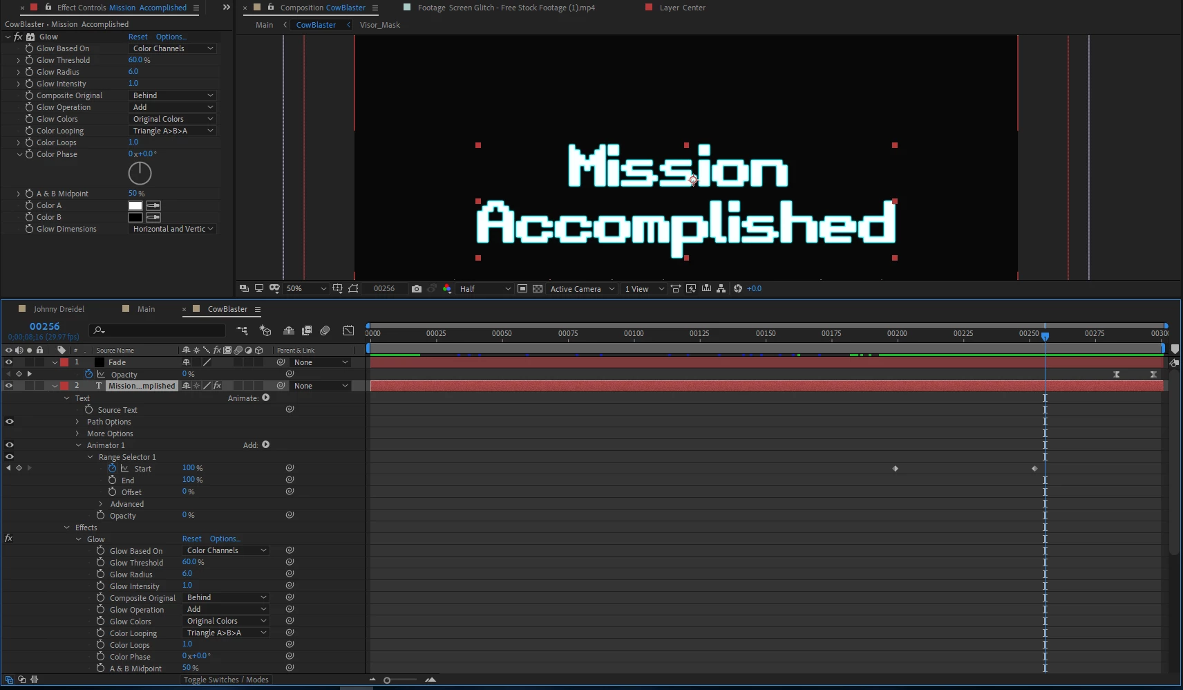

Hello all,
I have created a text layer with Cyan colored text in my project, and have applied a white Glow effect over it.

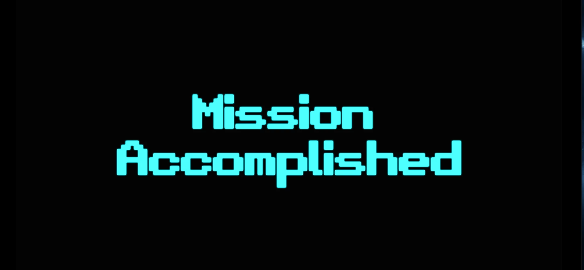

It looks fine in After Effects, and I can even see it look correct while it is rendering in Adobe Media Encoder. However, when I open the final mp4, the text only shows up as Cyan, and the glow effect is not applied.
I'm not sure what info needs to be provided, so I took a picture of my work space, containing the properties and layer effects of said layer, as well as what it looks like in the video.
Mylenium
January 29, 2020
Impossible to tell with so little real info, but let me make a bold guess: You work in 32bpc, yet use an 8bpc output format. At least the overblown "white-out" would suggest so. This may of course render the glow totally differently since the 32bpc value ranges cannot be accommodated in lower bit depths. If that's indeed the case, you will need to switch your AE project to native 8bpc/ 16bpc and tweak the glow so it looks right, use the "render at maximum depth" setting in AME or make sure you get a proper downconversion by applying effects like Compander on top of your 32bpc comp to get correct conversion of the internal values. Other than that of course also always check things like hardware acceleration settings, preview resolution vs. final output quality, layer switches that may be overriden during render and so on.
