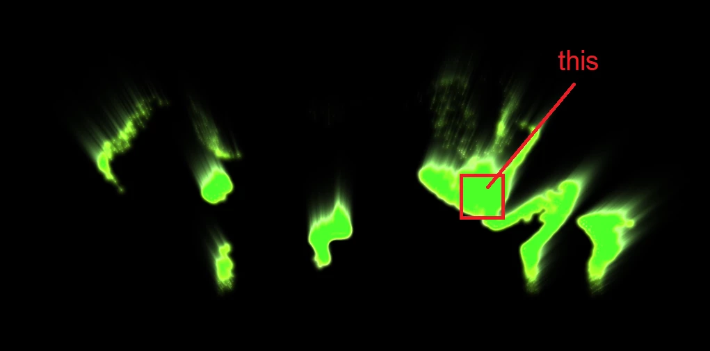

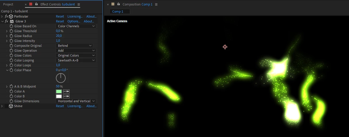

I have a issue about glow. When I use glow in projects its seems really good. But there is really big difference between my project and export. In the project everything is fine. But the render is seems really bad..
(project is 32bpc, i tried every render options, also tried using cuda/mercury, and also tried all glow options(threshold,radius,intensity))

    I would check the color values with the Lumetri scopes or by using the selection tool and the Info Panel. If you are driving the colors above 1, 1, 1 (32-bit display in info panel) then they are going to get crushed when you render an 8-bit file.
    If the project is 32-bit and the render is 8-bit you are going to have color range problems. If you have compensated for over white values one way around the  is to render a 16 bit DI (digital intermediate) using a 16-bit production format then try compressing that DI to your 8-bit deliverable file (h.264 MP4).
    Another option is to add a little noise to the file so when you go directly to an 8-bit file with a lot of color compression the noise will tend to hide the color artifacts. You will still have to compensate for over whites.
