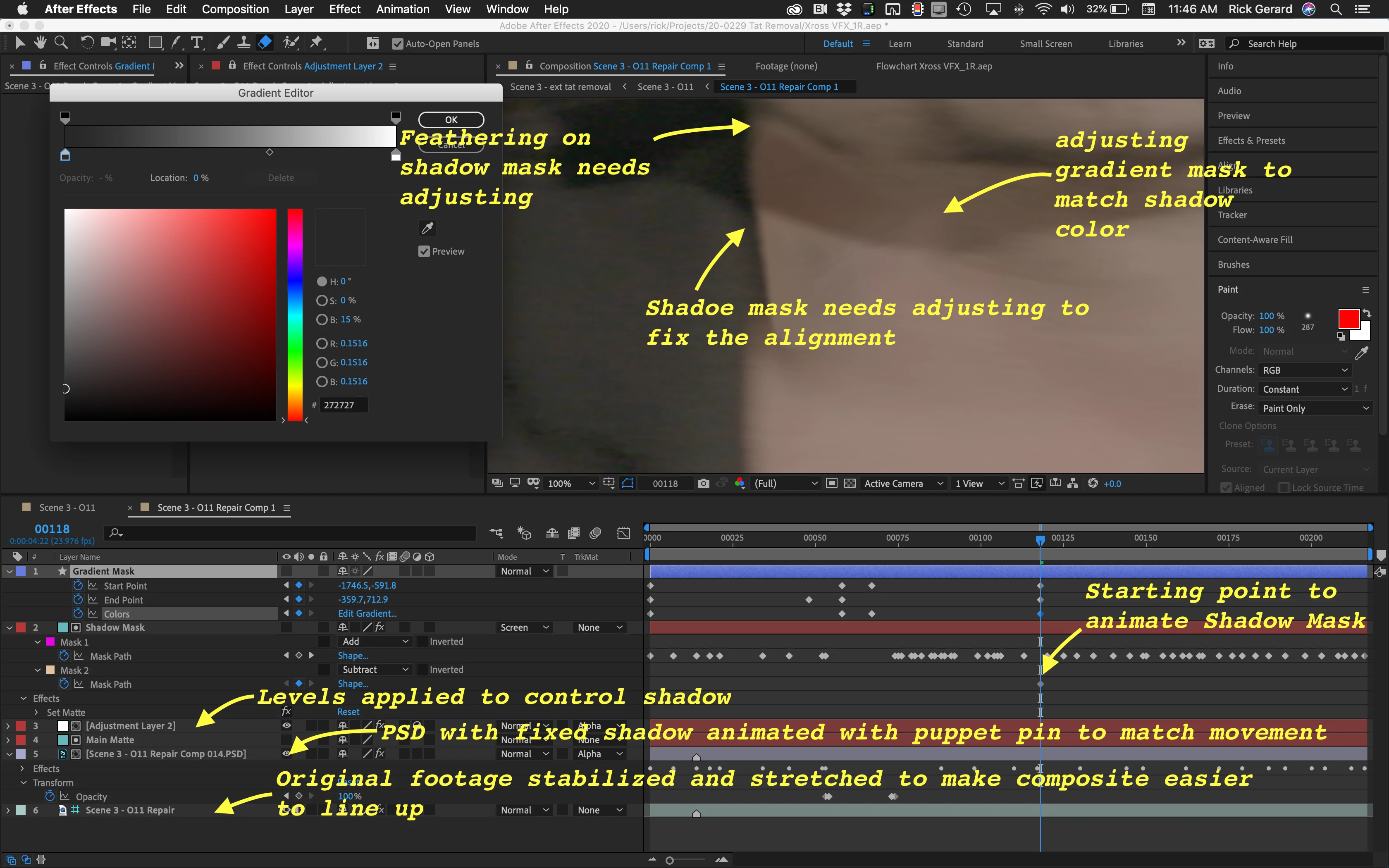

I am currently working on a shot where I have to remove a tattoo from the neck of an actor and it involves motion stabilizing to simplify the roto, hand roto, several Photoshop files created from the timeline that I can use to remove the tattoo using a combination of the healing brush, clone stamp, color dodge, color burn, smudge, puppet pin animation on the PSD file to distort the image to match the changes to the shape of the neck, adjustment layers, animated gradients as lima track mattes for the repair layer to match the lighting changes, shadow masks, blend modes and a few things I have forgotten. One of the shots was just over 100 frames long and it took me 2 days and about 40 layers total in a half dozen pre-comps to effectively remove the tattoo. This kind of work can be easy, but it can be very difficult. You just have to break the problem down into the smallest pieces possible and not be afraid to combine layers to get the final solution.
Without seeing the shot you are working on and/or your timeline showing the modified properties of the layers (uu) it is pretty difficult to give you any meaningful solutions.
Here's a start on the next shot I'm working on that sounds something like what you are trying to do.
By the time I'm done, I'll have at least 3 more nested comps and hundreds of keyframes in this 216 frame composition. I'm guessing it is going to take at least another 3 or 4 hours.
