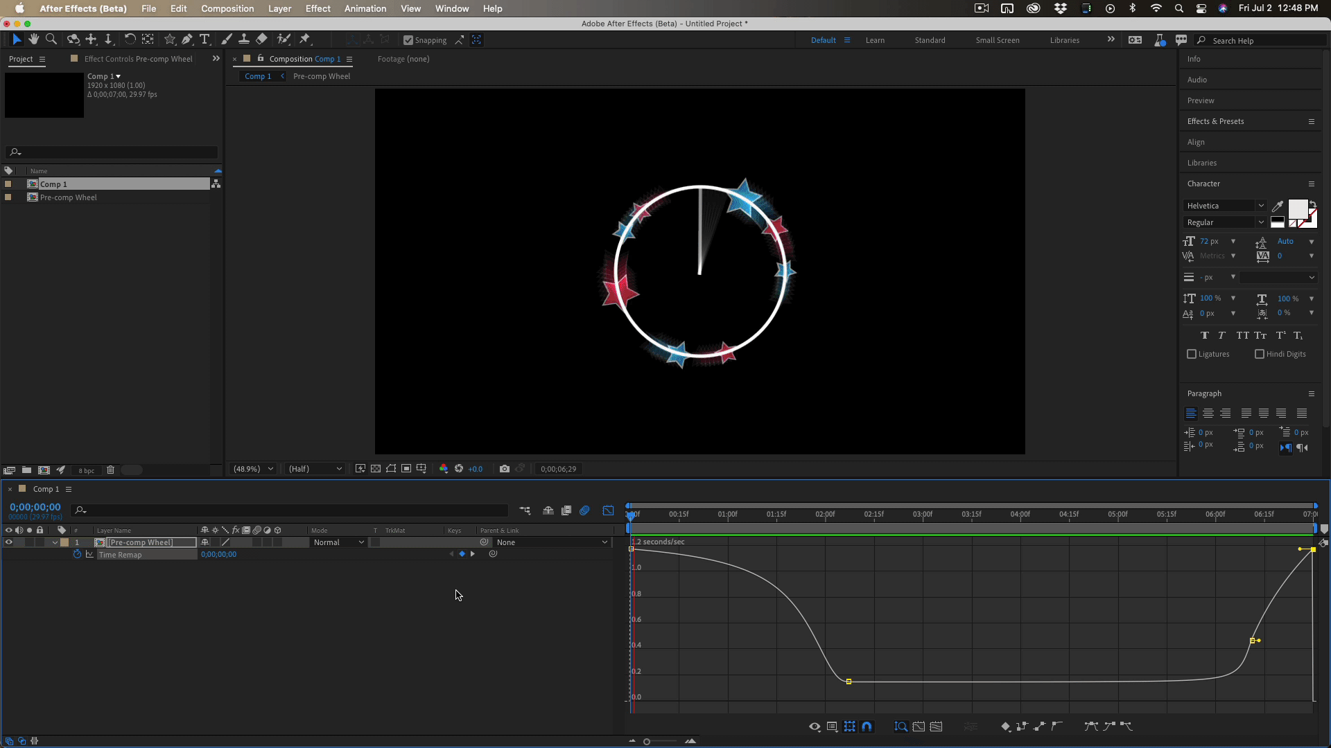

Option 2: Make sure the anchor points of all layers are in the right spot, parent the layers to a null, add a keyframe to Rotation at 1 second at 0º, move down the timeline about 10 frames and add another keyframe at 360º, then all LoopOut() as an expression, Pre-compose all the layers and enable Time Remapping (Alt/Option + Ctrl/Cmnd + t), open the Graph Editor for time remapping and select edit speed graph and start setting a few keyframes and adjusting the speed.
Time required for Option 2 with a little experience with the graph editor: About 10 minutes.

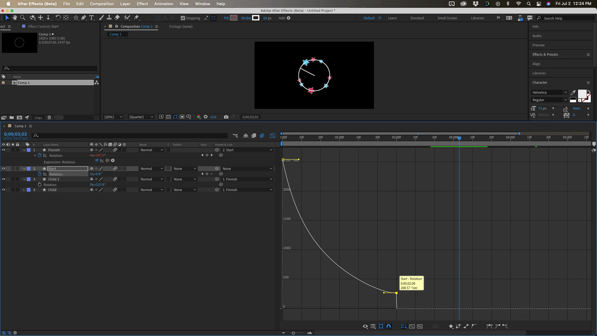

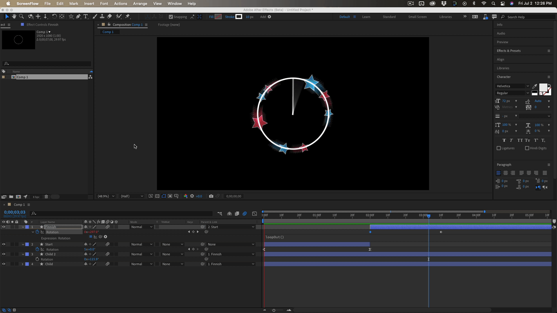

Option 3: Toss out your transform Rotation expression and use parenting. Select your Arrows layer and move down the timeline to where you want the Ferris wheel to maintain a constant speed. Name the top copy End and the Bottom copy of the Arrows layer Start. Set rotation keyframes on both layers under the CTI at 0º. Move down the timeline and set another rotation keyframe at 360º for the End layer, add the simple expression loopOut() to the Rotation property, open the graph editor, set it to edit speed, and then check the rotation speed by hovering over the speed graph. Make note of the speed.
Now switch to the Start copy of the Arrows layer and move to the first frame and set a new keyframe at rotating the layer in the opposite direction several revolutions. Select both keyframes and set easy ease for both. Open the graph editor and adjust the number of revolutions and adjust the bezier handles so you get very close to the rotation speed of the End copy of the layer. You should be able to get it within a few degrees with little trouble.
Now Parent the End layer to the Start layer, then parent all of the other layers to the End layer and you're done.

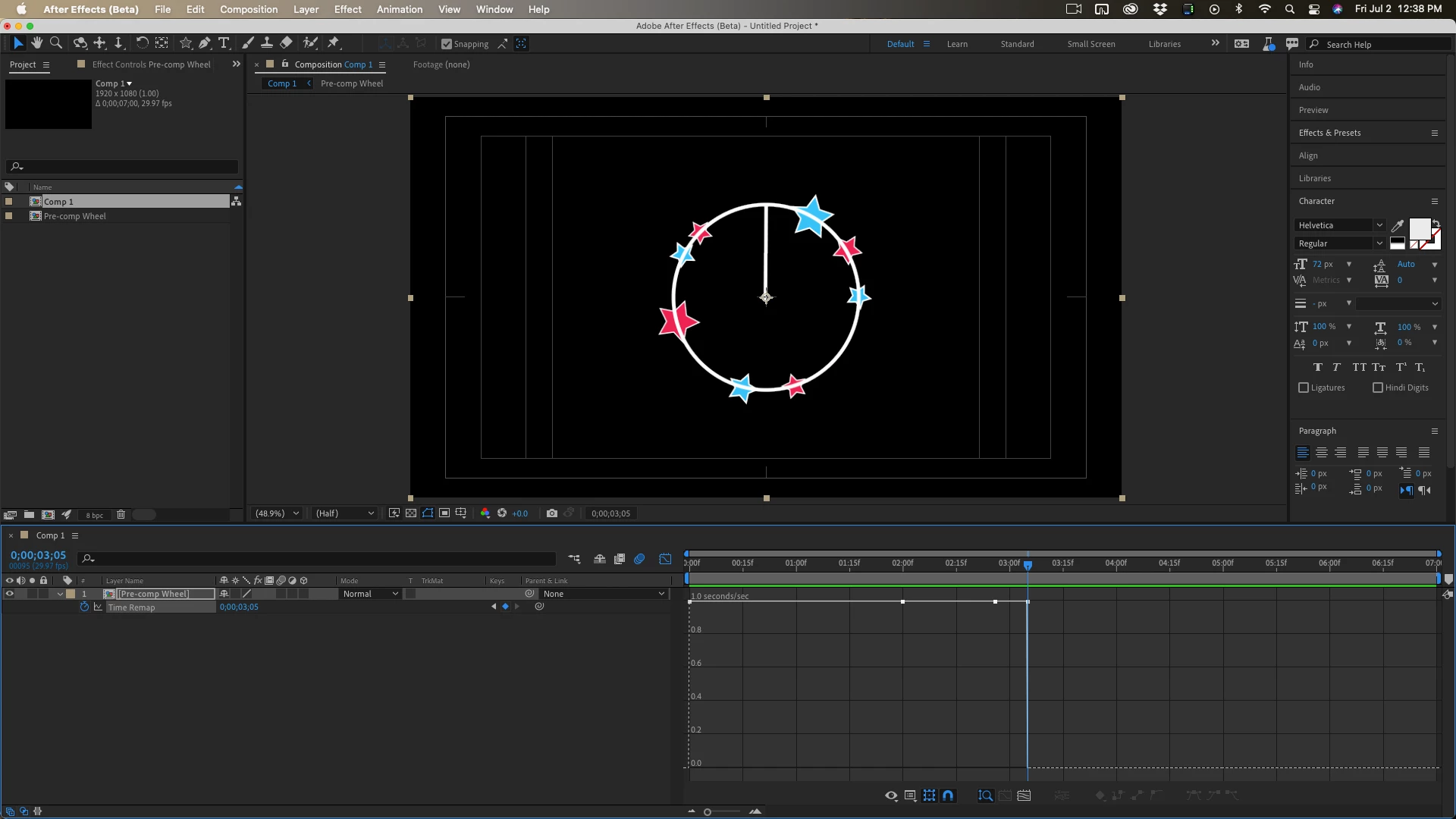

If you want to make further speed adjustments just pre-compose all layers and enable time remapping and edit the speed graph. The nice thing about using Time Remapping on animated layers is that there is no frame blending. All of the animations are interpolated to the correct value for that new time so nothing is lost and you have complete control over the timing. Since this is the most complicated I'll show you multiple screenshots:
Personally, I would use option 2 most of the time. It is the simplest and guarantees smooth transitions between the rotation speed. These are the steps: Set additional keyframes and delete the last one.
Edit the Speed Graph.
It took me longer to write the post and make the screenshots than it did to create the animations.
