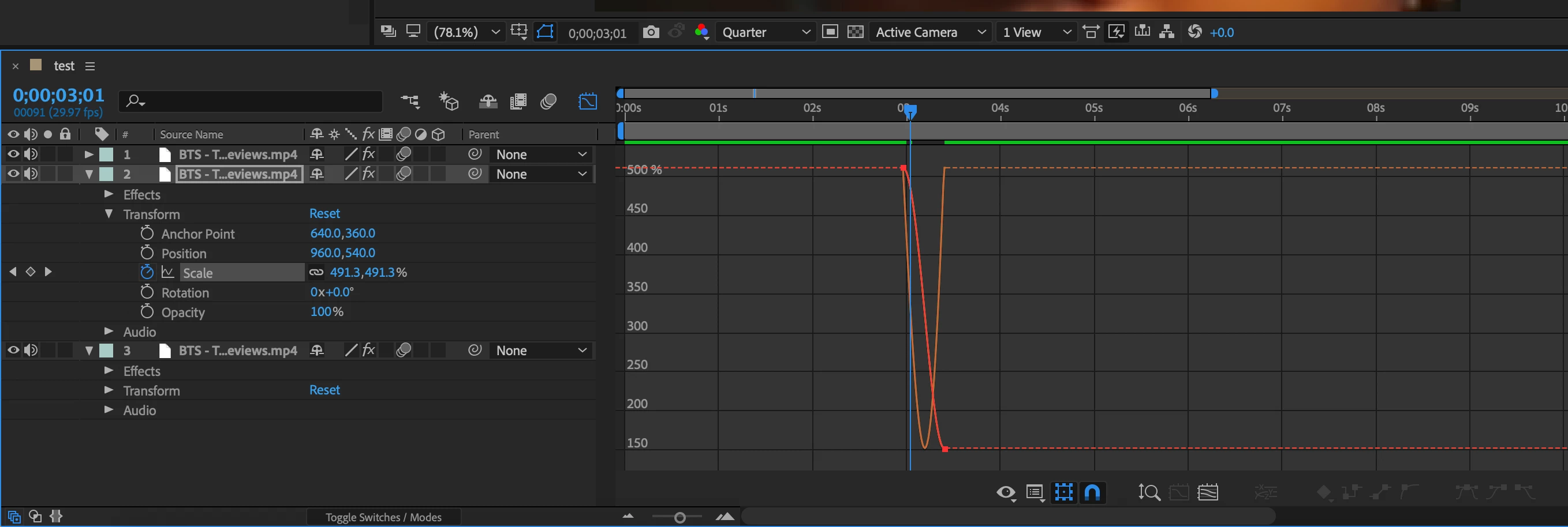

I'm trying to do a zoom transition but when I selected easy ease and clicked on graph editor, it shows me this curve and red line. When I tried to adjust the speed the orange curve moves with it. How do I turn it back into the single white line for me to adjust the speed? (Sorry I don't know the terminology since I'm not experienced with after effects)

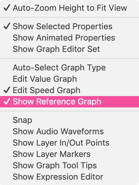

Right click in the Graph Editor and uncheck Show Reference Graph

thank you!
