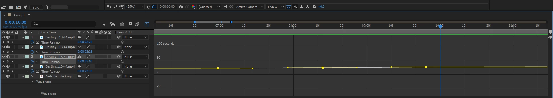

Graph editor looks flat
I'm trying to do some time remapping but when I edit my keyframes in the graph editor they look like this? There is no space for me to use the handles or do anything really. It is a reoccurring issue but I have managed to not have this in the past. I have hit F9 and the easy ease function and neither work. Any help would be much appreciated!

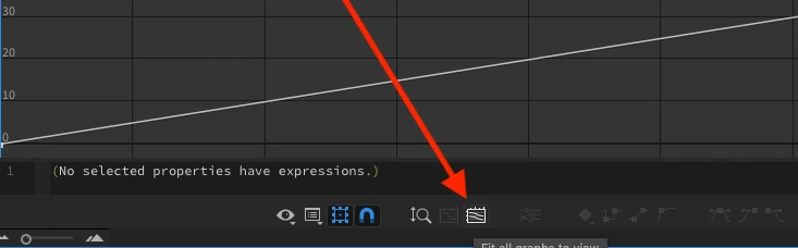

Have you tried to click the "fit all graphs to view" icon?
Mathias Möhl - Developer of tools like BeatEdit and Automation Blocks for Premiere Pro and After Effects
Feb 25, 2021 4:48 PM UTC
yea it hasn't worked unfortunately
