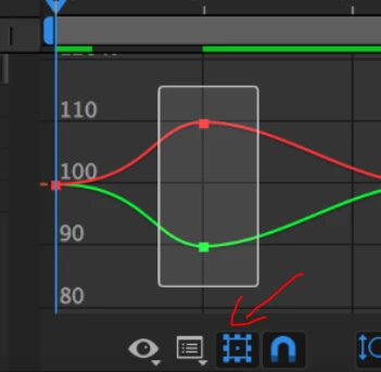

I'm trying to select multiple points to edit at once in the graph editor. As you can see in the screenshot (http://imgur.com/a/enTqw), I draw a box over the two points I wanted to edit at once. However whenever I drag one point (lets say the green line for instance) it will only edit that point (the green line) instead of both point (green and red). Is there any setting I need to change in order to assure I grab both points at once?

this should work.
un-check the transform box, you will have an easier time moving them.

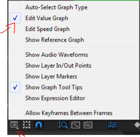

I see you are manipulating a bouncing animation, you should probably work in "Value Graph" mode and not "Speed Graph". change the view by right clicking on the graph options and choosing "Edit Value Graph"
see if you do it this way

I unclicked the transform box, and when I went to check what graph I was working on it already said value graph :/

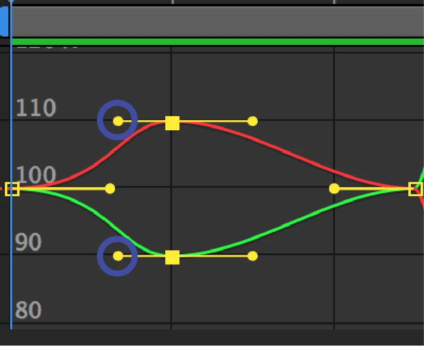

I'm trying to do the exact thing that you posted in the last gif, however when I highlight the two points and then attempt to move it, it will only move one point (such as if I were doing exactly whats shown in the last gif you posted, only the red line would respond and move). I'm honestly clueless as to how to fix this issue. Maybe a setting might be turned off?
EDIT: So I retried it once more and it seems to be working now (only to the extent that if I grab it by the anchor it will move). HOWEVER, I'm trying to grab the anchor handles and adjust one handle in hopes that it will adjust the other handle as well and not the anchor itself. Moving the anchor directly works but it's not what I'm trying to achieve as I only want to move both anchor handles equally.
I have circled in blue the parts I'm trying to move equally at the same time.
like this?
if this does not work, there is no setting to allow or not allow it. this could be a bug or hardware failure (mouse/wacom). see that you are using the most updated version of your release and come back with what you find.
