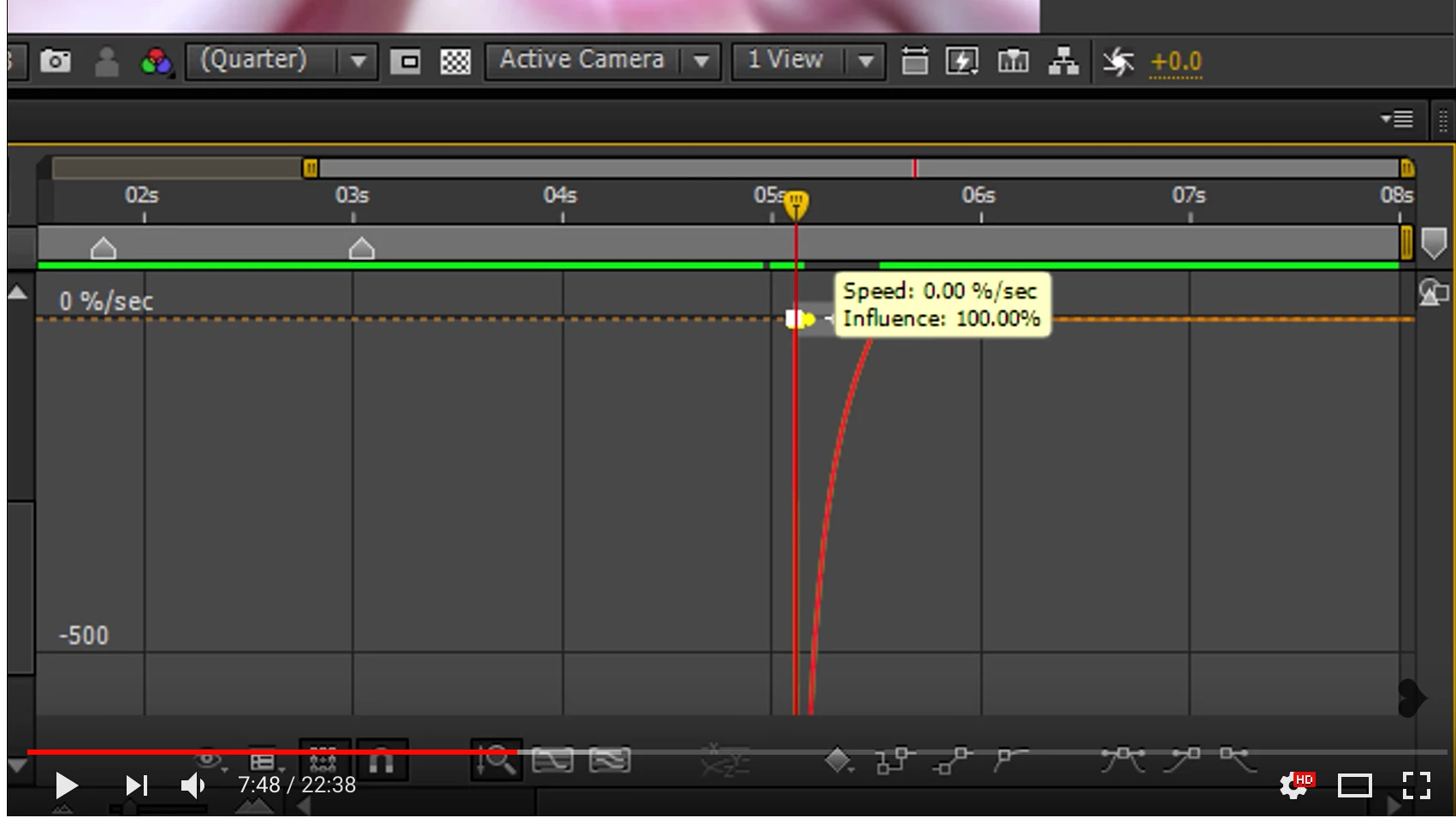

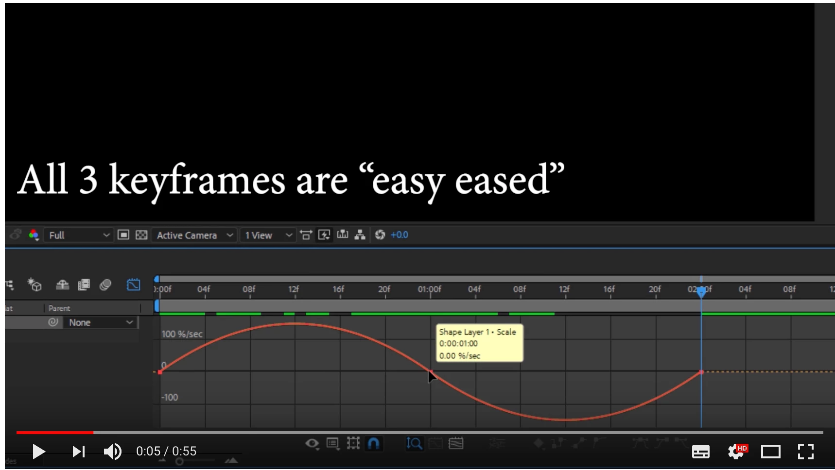

I don't think i was very clear in my question. In most video tutorials the speed graph editor looks like this:
It just has one red line, instead of a red and green line that are almost unable to edit with. if i grab the handle, i can't adjust it, the curve just gets incredibly big and almost impossible to use. i can't move the yellow handles around etc. i am fairly new to after effects but there should be a way to get my graph editor look like that and to be able to work, shouldn't it? because now it's impossible to work with and it's extremely frustrating.
