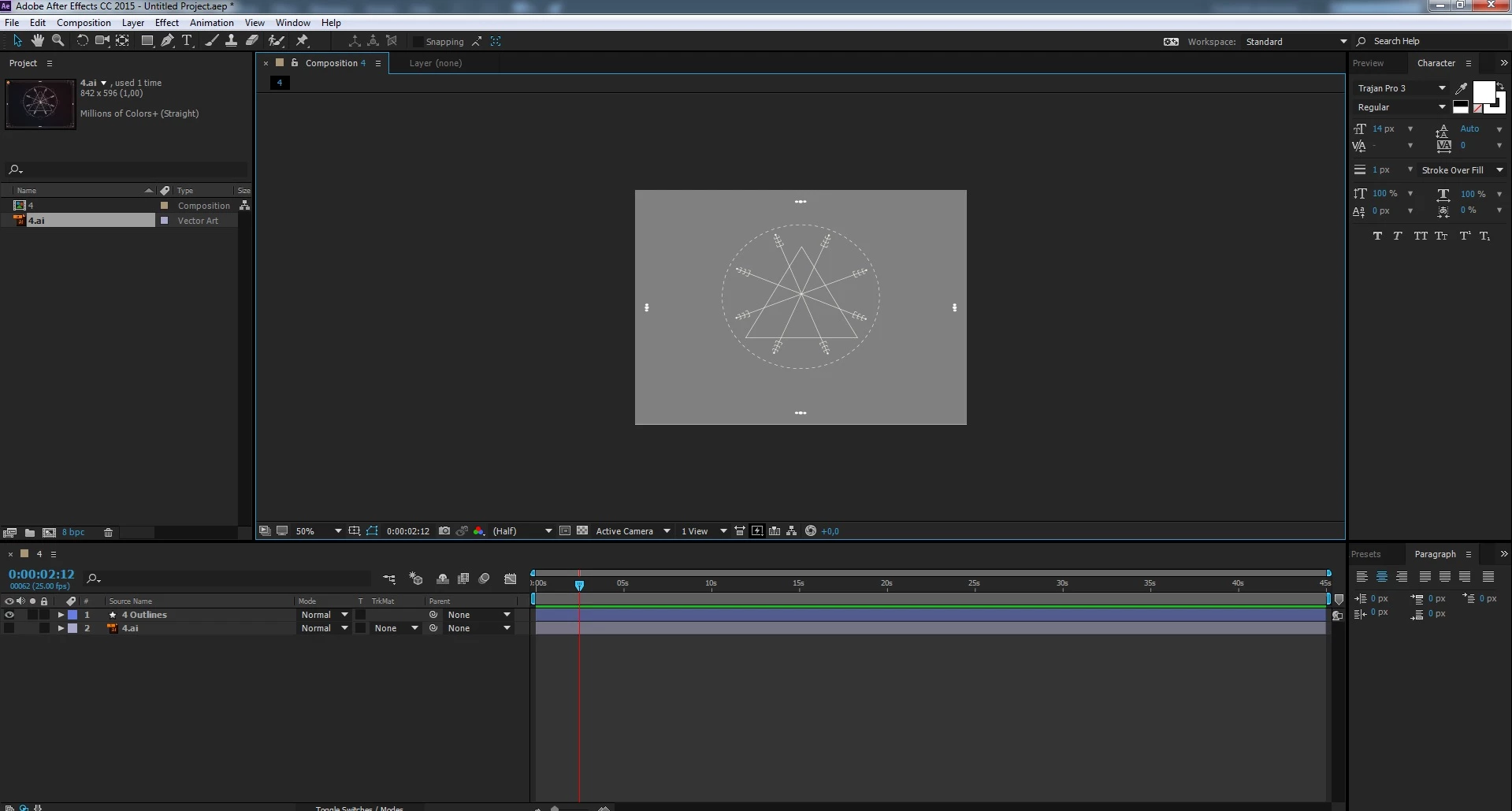

Hey all,
I'm busy with a schoolproject and I want to make a teaser for something. In the artwork there are some things I want to animate really simple in After Effects. I'm only talking about rotating 5 á 6 things.

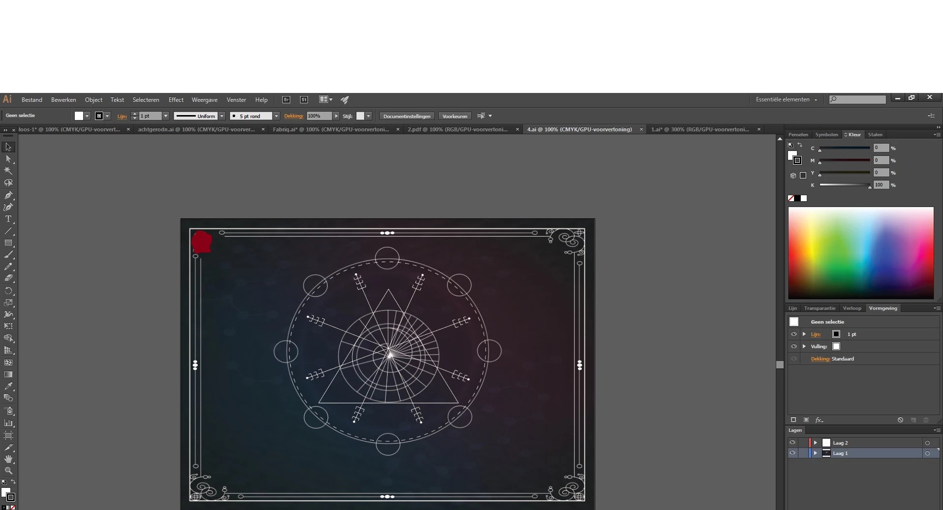

So in the first image you can see I've grouped everything in Illustrator. Laag 1 (layer 1) is the background and Laag 2 (layer 2) contains the things I want to animate. After that I just saved it as an Illustrator file and imported it in After Effects.
After I import it, I click on 'create shape from vector layer'. After Effects does let me animate the things, but also he gives the whole a gray background. But ofcourse I want to maintain the original background.
Anyone who can help me? I just want to maintain the original background and only animate the things that you are seeing in the second image.
