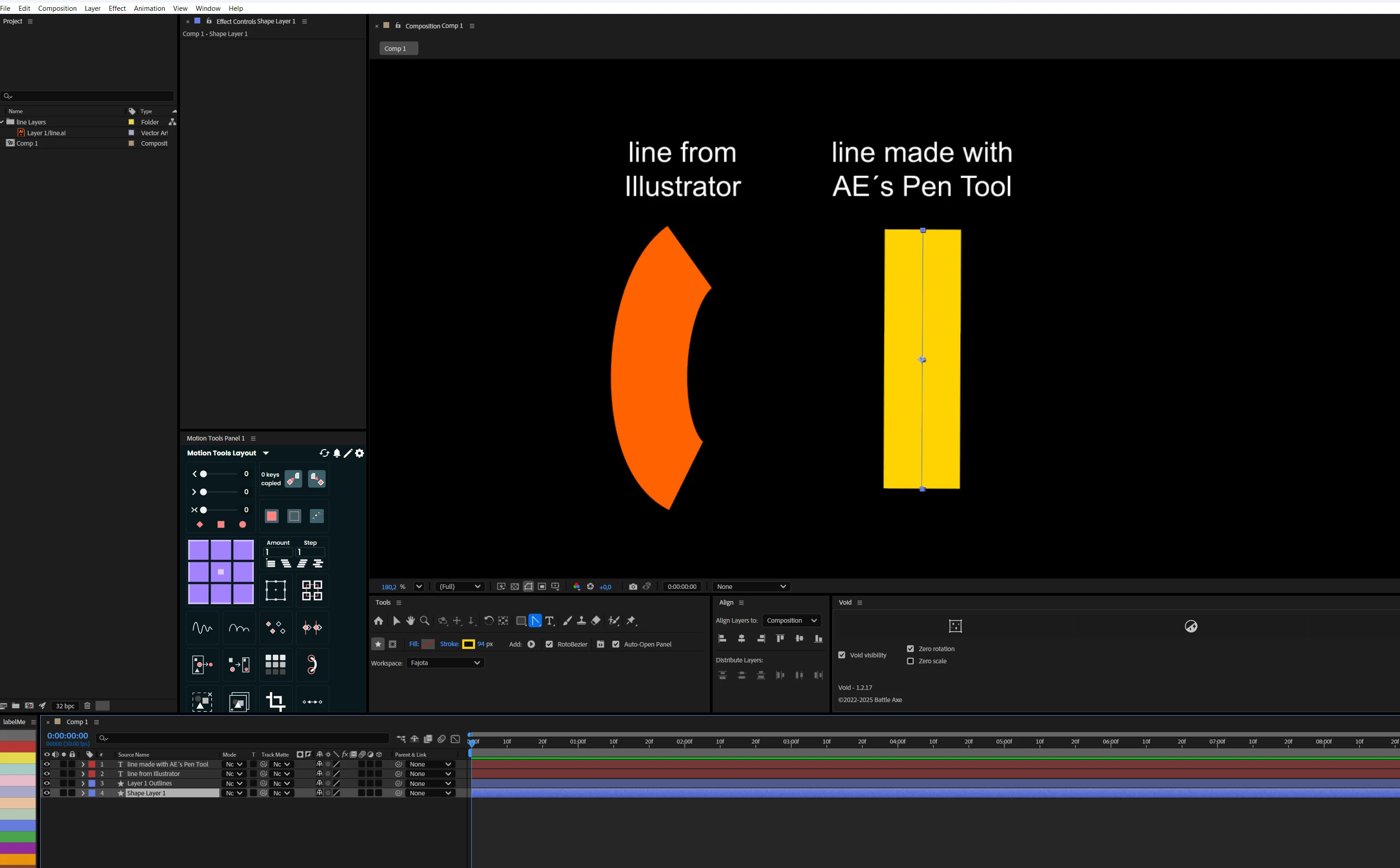

When I convert an Illustrator vector into a shape, the handles appear on the anchor points. (image 1)

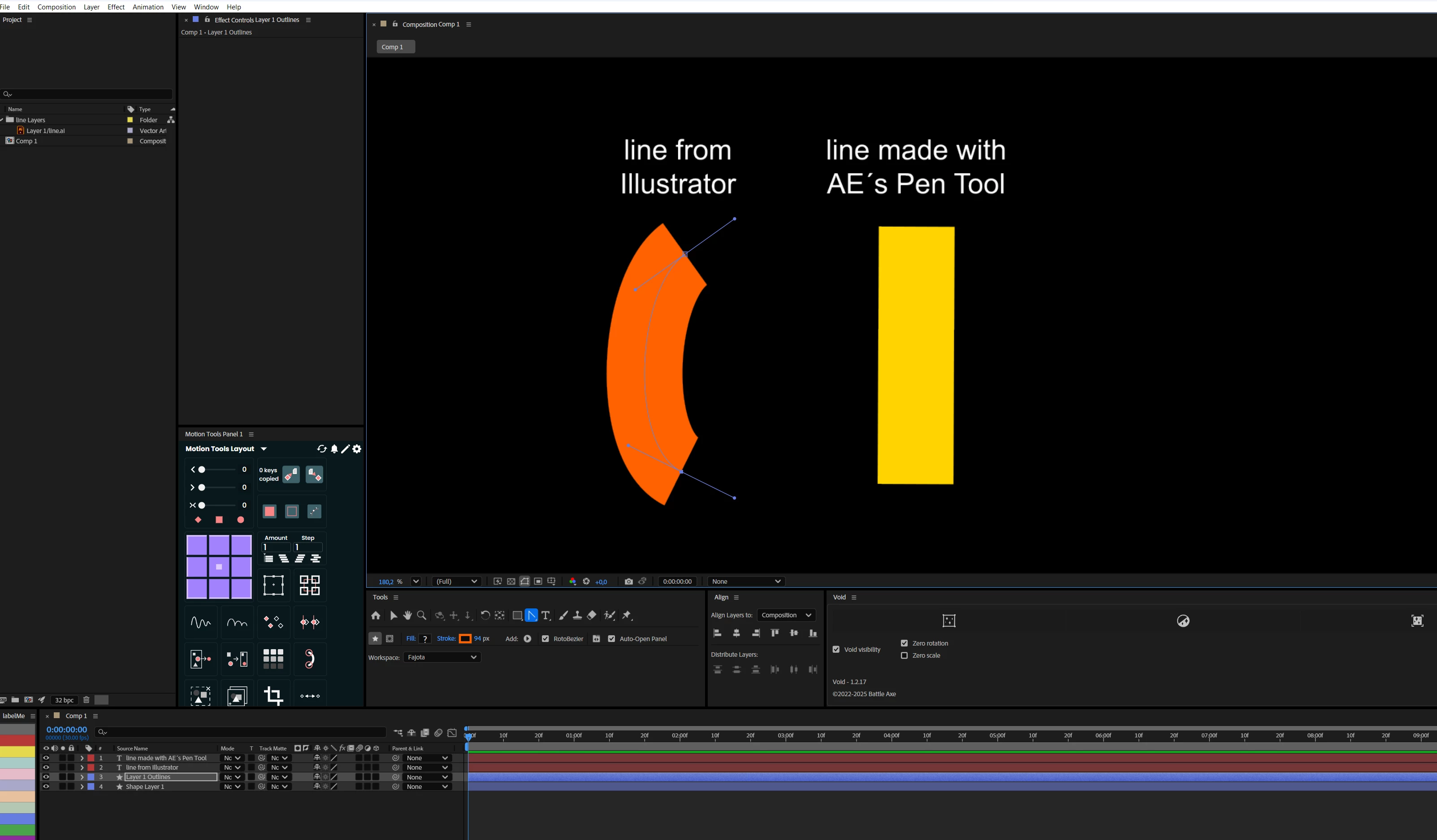

However, if I draw a line or any object using the Pen Tool and then use the Convert Vertex Tool to change the shape, the Handles do not appear on the Anchor Points. (image 2)  I tried uninstalling and reinstalling the AE. How can I fix it?

Thanks for sharing the screen recording. It helps! Uncheck the Roto Bezier check box before creating the path. For the existing path, select one of the vertices> right-click > Mask and Shape Path > and uncheck Roto Bezier.
Hope it helps. Let me know the outcome.

Hi! I just want to edit the curves without animating
