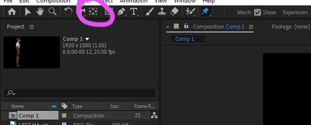

Hi, all! I'm sorry if this is the wrong place to ask this, or if it's already been answered - I'm new to both the forum and completely new using after effects. So please talk to me as if I'm a beginner - because I am!
I'm a university student and I've been told to animate a walk cycle in After Effects (2019) using the puppet tool. So far I think I've done well - I've done my drawing, separated the limbs into layers accordingly, and selected the parent/child layers (although I'm not 100% confident about this).
However, as soon as I try to move it like this:
As you can see, the arm doesn't remain connected to the torso like it needs to. Same with the rest of the limbs, and it's essential because the movement looks unnatural otherwise and makes it difficult to animate. What am I doing wrong and how do I fix it? I'd appreciate it if you'd explain as simple as possible, and visual example would be of great help too, thank you!

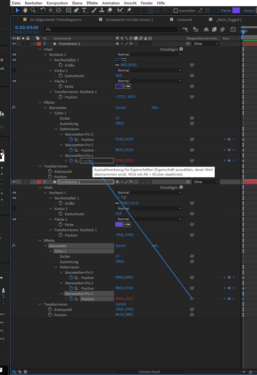

If you are forced to use puppet tool and you cannot use DUIK, the best would be to put a pin on the shoulder and connect the arm pin to the should pin. When animating, you leave the arm pin and only keyframe elbow and hand. If the should should move, you animate the shoulder pin only. Just like in actual physiology.
To connect the pins, create them first (pay attention that the whole body needs pins - neck, shoulder, spine, hips - otherwise is will just rotate). When go into the effect and use the pigwhip to connect arm pin to shoulder pin.
In my example Formebene 1 (Shape Layer 1) is the body with 3 pins. Pin 1 is the shoulder. Formebene 2 is the arm with 3 pins, too. Pin 1 is the top the arm. I pig whipped pin 1 of the body to pin 1 of the arm.
The result looks like this:
When ever I move the shoulder pin (body pin 1), the top of the arm follows.
I hope this helps - I don't know how to make a GIF fast.
