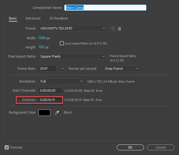

help ive had problems with this for a couple days and have not found an anwser
i got the after efffects book and was doing a project and the timeline keeps looping and is too short help
    Correct answer P.M.B
    Your composition is 2 seconds long.  If you want to make it longer go to Composition>Composition Settings and enter how long you want it to be.  In the image below the length is 8min, 6sec, 19frames

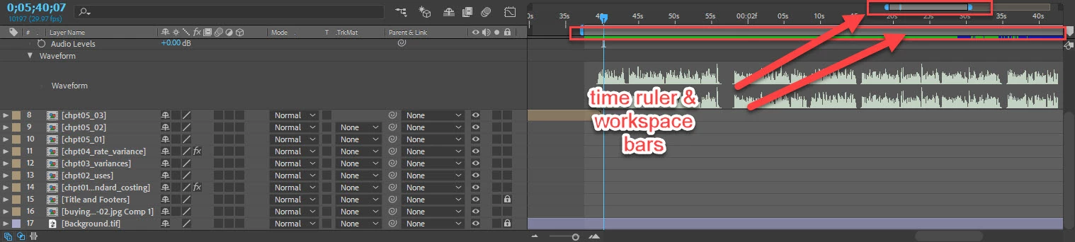

    AFter you do that you will have to drag out the time ruler and workspace bars so they encompass the entire composition.

    also the book is almost due and i cant progress without this

    April 24, 2018
    thanks im only 10 so i have a hard time  thanks!
