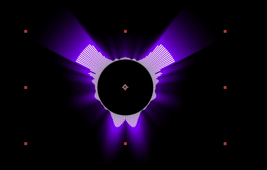

Hello dear community,
I've been trying desperately for hours to find out how I can make the peak from my audio spectrum biggerI've tried so many things and now I can't find a solution on my own eithertherefore I hope that someone can help me here..
My goal:
  1. To enlarge or lengthen the purple / white peak, so that it takes up more space and stands out more
  2. To keep the circle as small as possible in proportion
My problem:
  1. The value "maximum height" is already set at the maximum level
  2. The smaller I set the layer size of my audio spectrum, the bigger the peak in relation to the circle, but then the tip is cut off from a certain height (PIC 1)
  3. The larger I set the layer size, the smaller the peak & the larger the circle (PIC 2)
I would be really happy if someone, who knows the program more than me, can help me here. Of course I will also give you more information about my problem, if you need it .. Greetings 😉

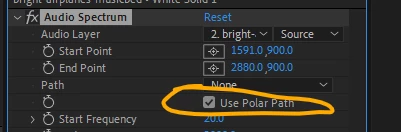

Correct answer Justin Taylor-Hyper Brew
Instead of using the polar coordinates effect, use the "Use Polar Path" checkbox in the Audio Spectrum effect

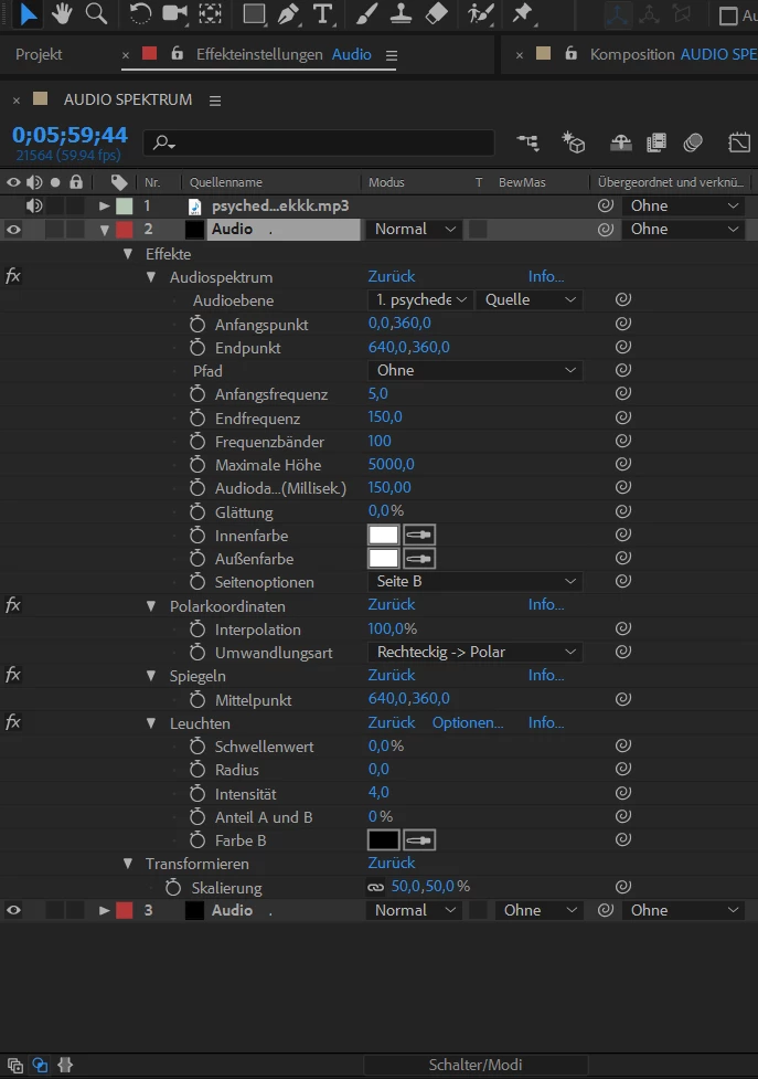

Thank you @Justin Taylor-Hyper Brew@Rick Gerard for responding.
I found out, that you can set a higher value for "maximum height" than just 2000. Perfect!
..but the problem is now, that there is a cut, like an invisible mask. But i got no mask set! How i gonna fix that??
i hope i got it right with the pictures.. and also that my german-set After Effects is no problem for you.
Greets !
June 3, 2021
June 3, 2021
I did, but ehm...
June 3, 2021
Cropped screenshots are useless for diagnosing problems. Select your problem layer or layers, press 'uu' to reveal all modified properties and then embed them so we can see them.
You can increase the audio levels on a duplicate track by simply using levels controls, or by editing a copy of the audio in Audition to change the EQ and levels and use that modified track to generate the effect instead of trying to use the audio you want to hear in the shot. You can mess with the values in the Effects Control Panel. Let us know if you figure out the solution.
June 3, 2021
If max height isn't working, try to:
  1. Increase the mask size
  2. Increase the layer size
  3. Increase the audio layer's "Audio Level" value
