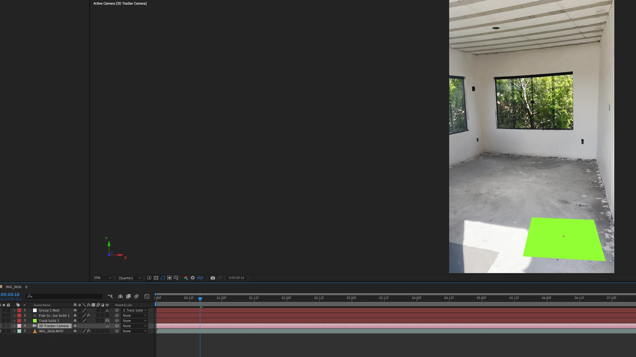

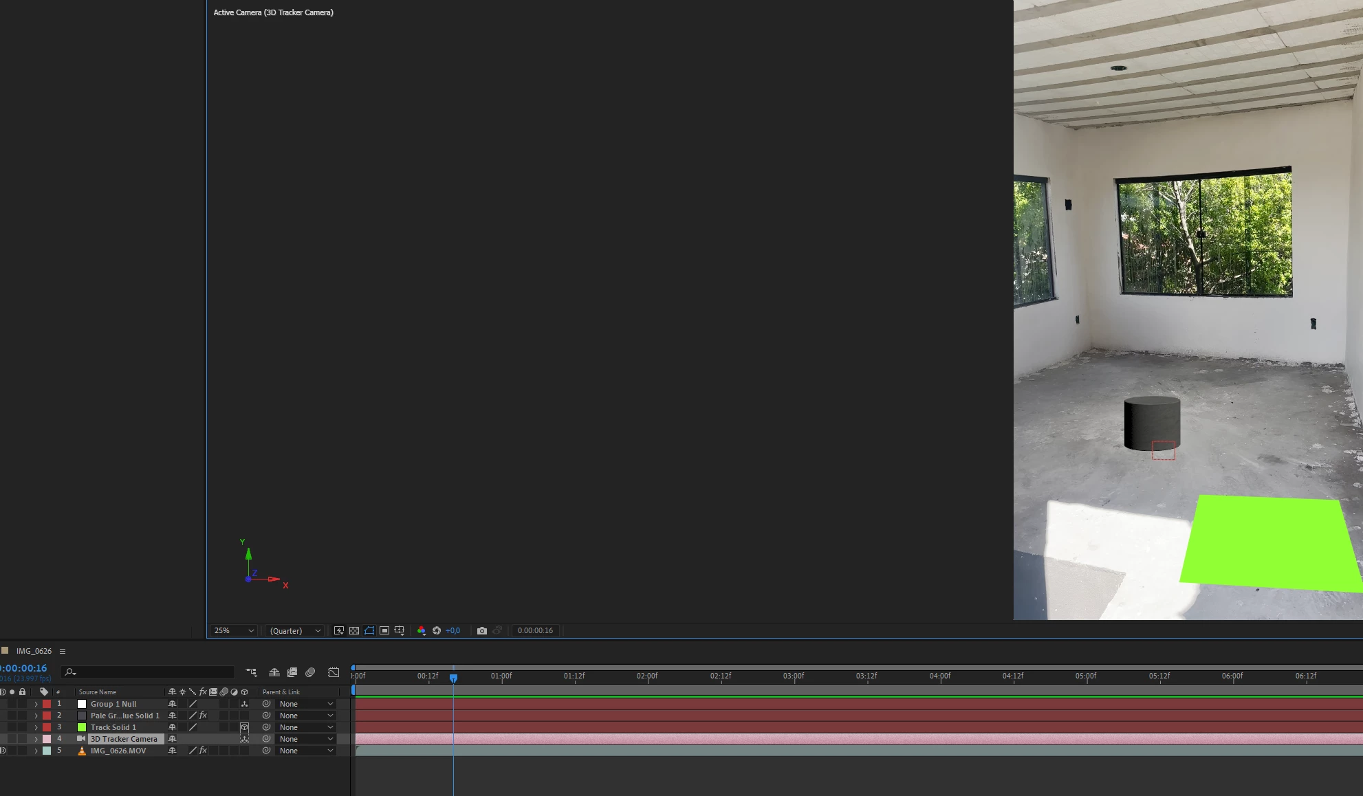

I do a tracking in a video in after, I create a tracking solid, so far so good, it follows the right way, then I create a new solid, add 3D element and place a 3D object in the scene, everything appears fine. BUT WHEN I MAKE THE PARENT OF IT IN TRACKING THE 3D OBJECT DISAPPEARS!!! I've tried everything I can imagine but I couldn't solve it. HELP ME PLEASE

Camera Tracker makes enormous values for its 3D space.  I can see in your second image that the null has shifted to the green square but is now tiny.  My guess would be that the 3D object's new position property (now that it is a child of the plane) has it either off screen or underneath or similar.  If you are using Element3D, then I've noticed this happens more frequently.
First thing to check: did you set a Ground Plane and Origin (immediately after tracking, select three points on the ground, then right-click and choose Set Ground Plane and Origin.).   Then you can create additional nulls and a camera.
Then I like to use a free script from workbench.tv to reduce the distances.  https://workbench.tv/freebies/2020-05-28_NormalizeTrack/
And then with 3D objects everything should be more manageble.
Alternatively, if you copy the null's position values to your 3D model, does it appear?
