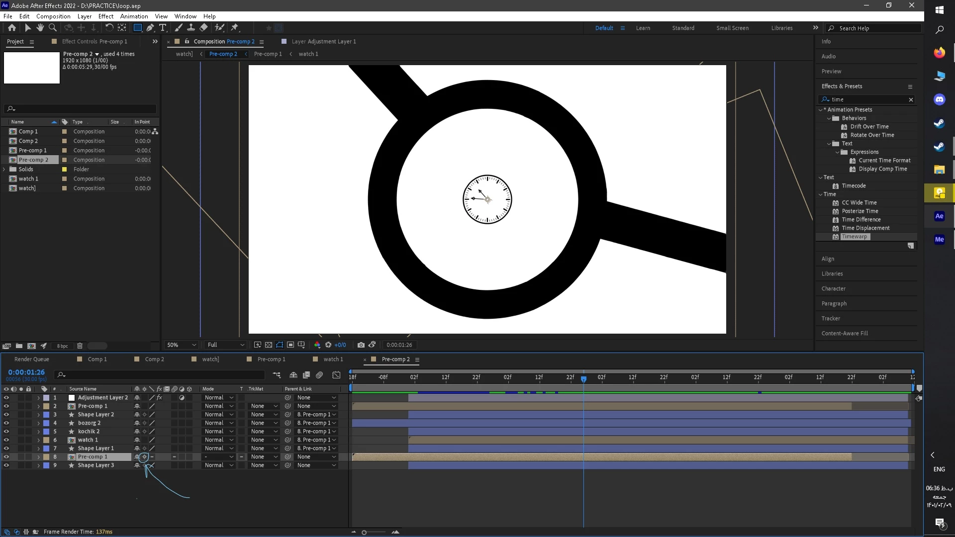

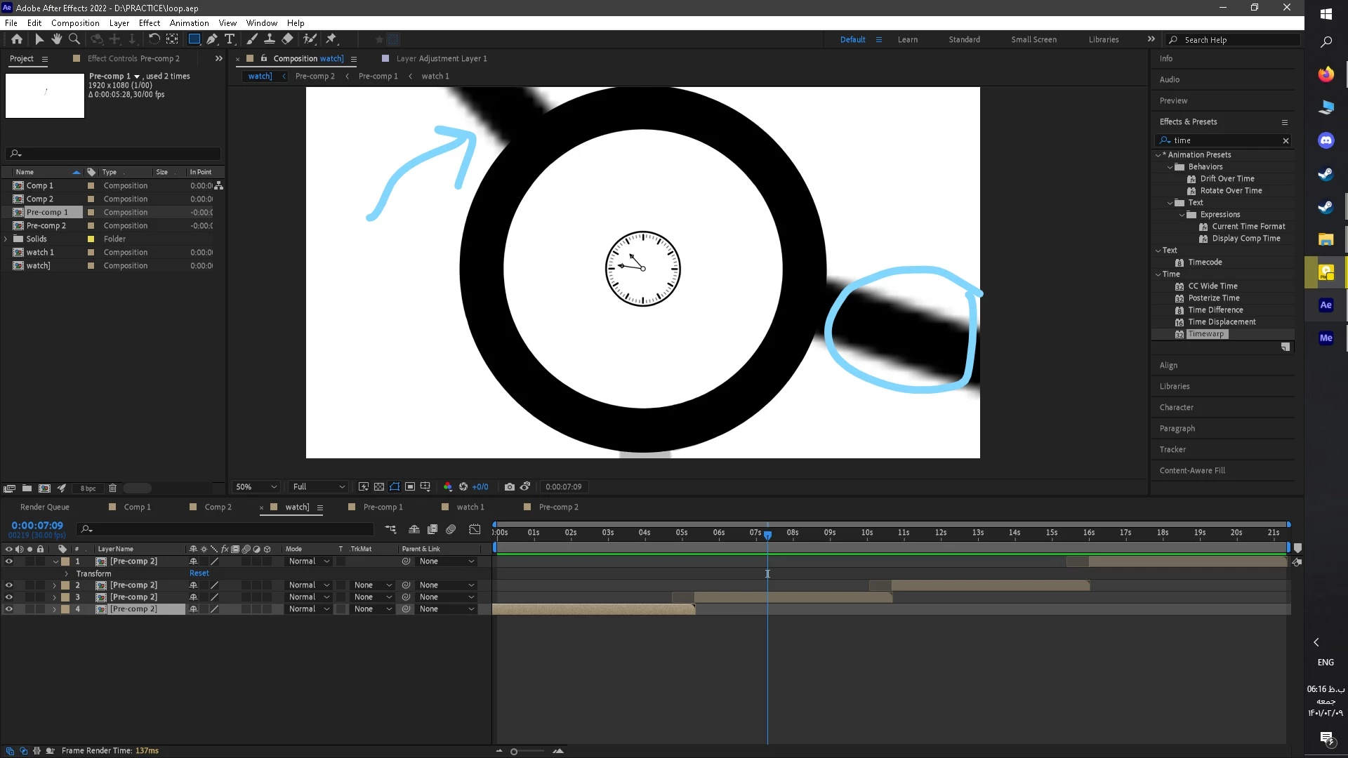

hello.
I'm a beginner with after effect and I made a simple loop of a watch and as you can see when I increase the scale , the quality of the hands goes kindda messed up.
Is there a way to fix that?and it's not just in the preview. it's the same after Export.
Sorry for my bad English .Thank you
Correct answer Mylenium
You may want to read up on collapsed transformations/ continuous rasterization and how to use those layer switches with vector-based content. The online help is your friend:
https://helpx.adobe.com/after-effects/using/layers.html
Mylenium
Mylenium
MyleniumCorrect answer
April 29, 2022
Mylenium
April 29, 2022
wow it worked I just activated this little option
Thanks Mylenium. and that was pretty fast too.
