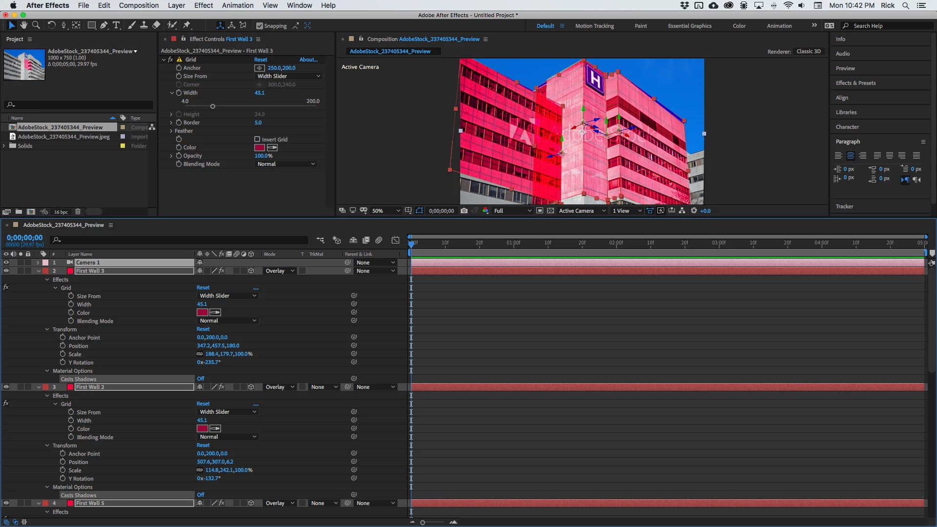

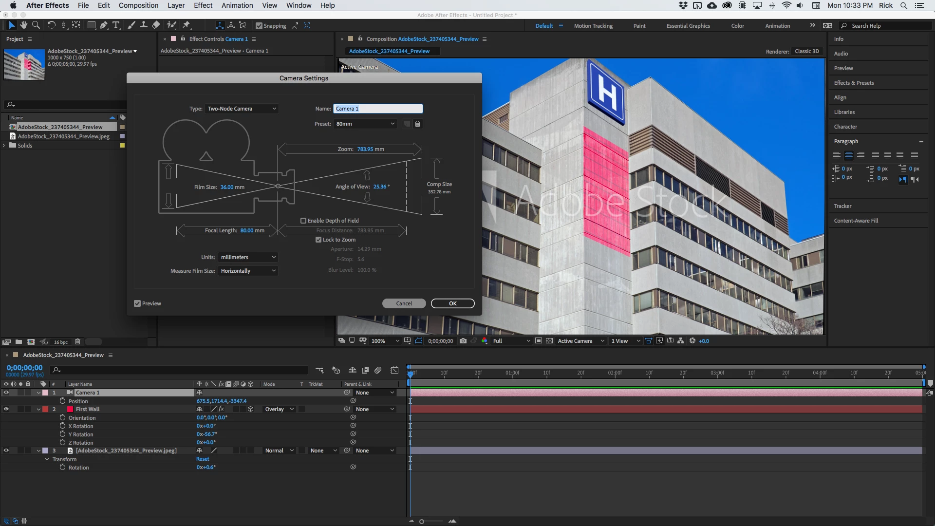

First I add the image to the timeline then create a new solid that is a little smaller than the layer. I'll start with a Red solid, add the Grid effect to it, make it 3D, set the blend mode to Overlay so I can see through it, then move the anchor point to the left edge and line it up with some prominent geometry close to the center of the image. I then rotate the image in Y so that it comes close to matching the perspective in the building. Now I add a Camera and estimate the focal length of the lens. I'm guessing this shot was taken with about an 80MM lens. A little manipulation of the camera position and the Y rotation of the layer will give you the first surface you are going to use to catch a shadow. Your comp would look something like this:

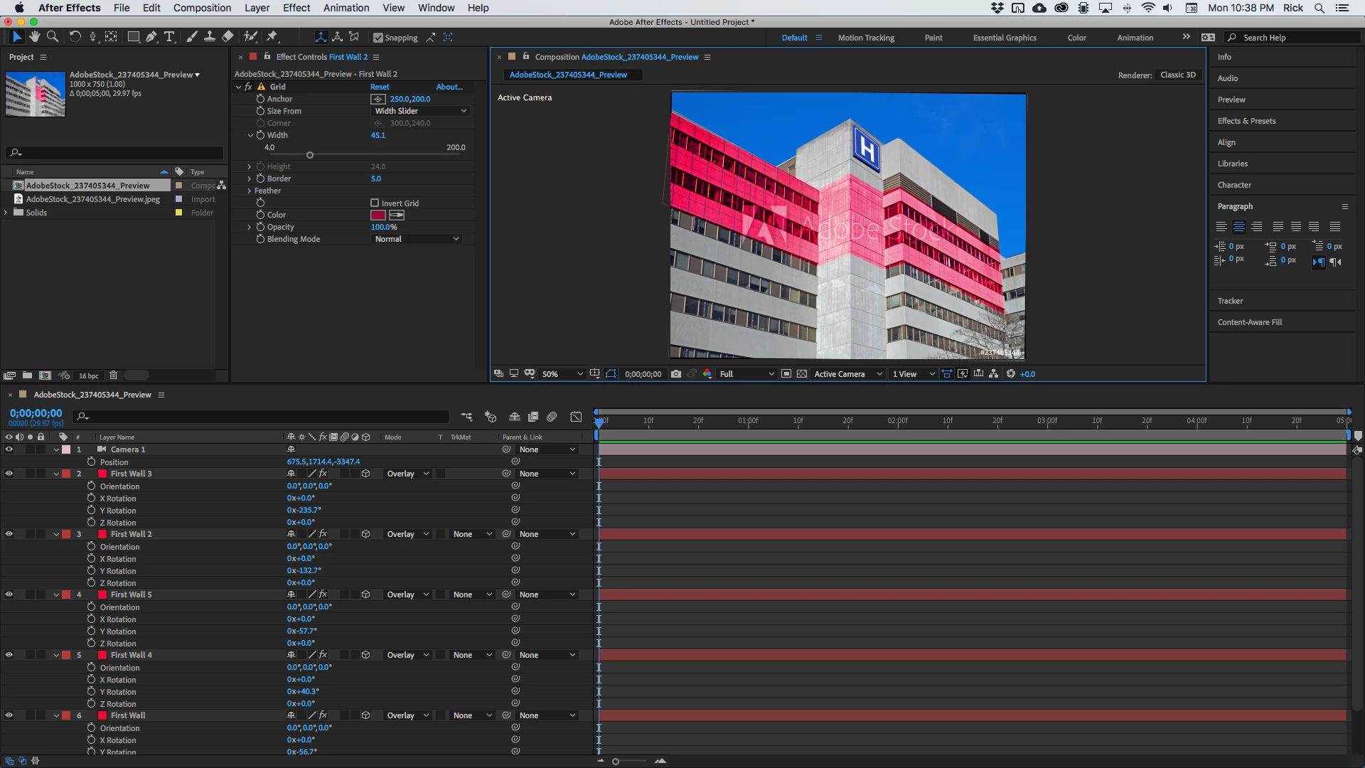

The next step is to start duplicating the solid layers, adjusting the rotation, moving the anchor point, and changing position until all of the surfaces that need a shadow are covered. That looks something like this:
The next step is to scale up the layers as needed and add masks if needed until you have everyplace on the building that needs to catch a shadow covered. Now your comp looks something like this:

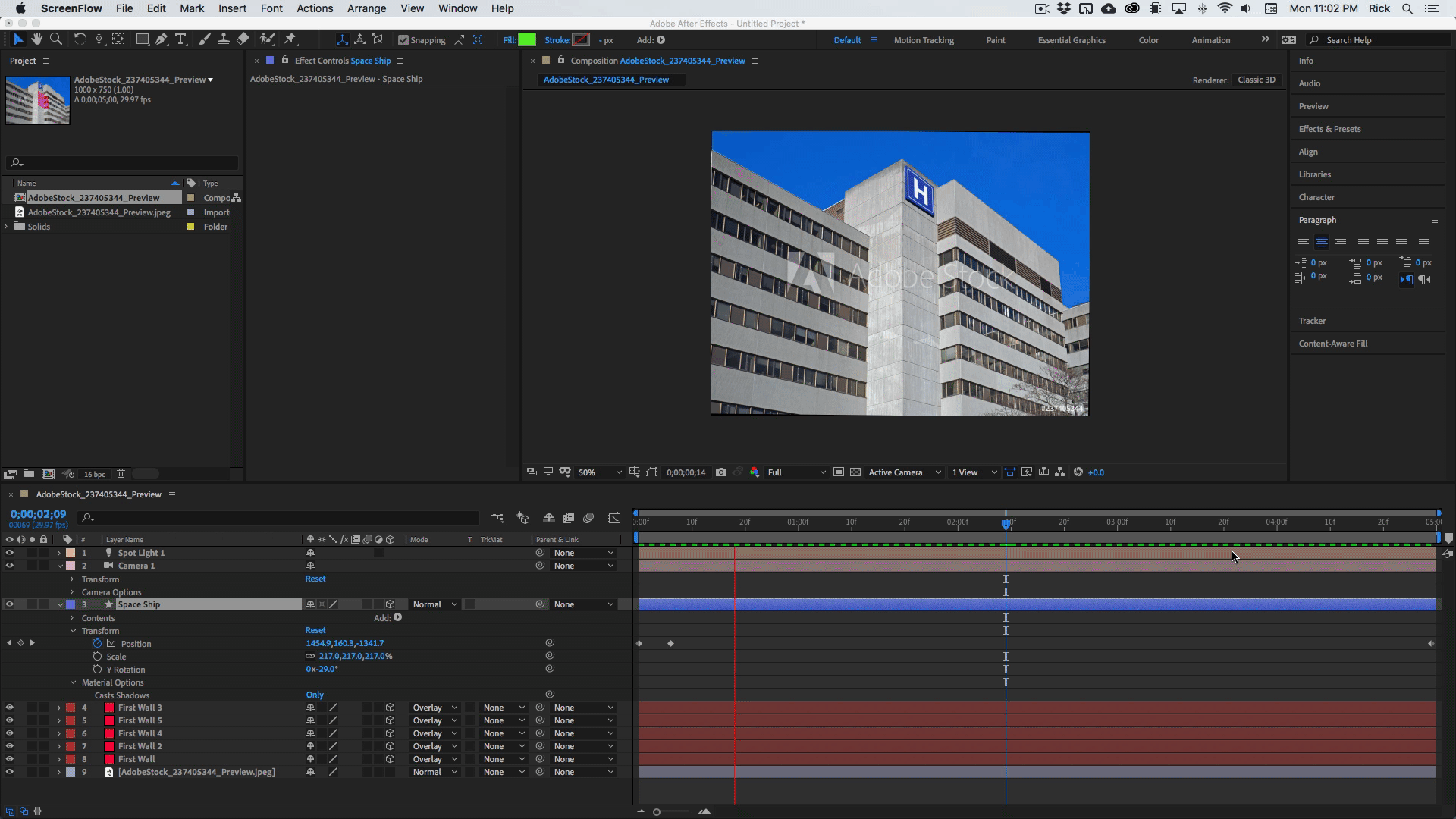

Now you open up the layer settings from the menu and change the color to white. delete the Grid effect from each layer, select all the wall layers and press the A key twice to reveal the material options and set all layers to Receive Shadows Only. They will now disappear.

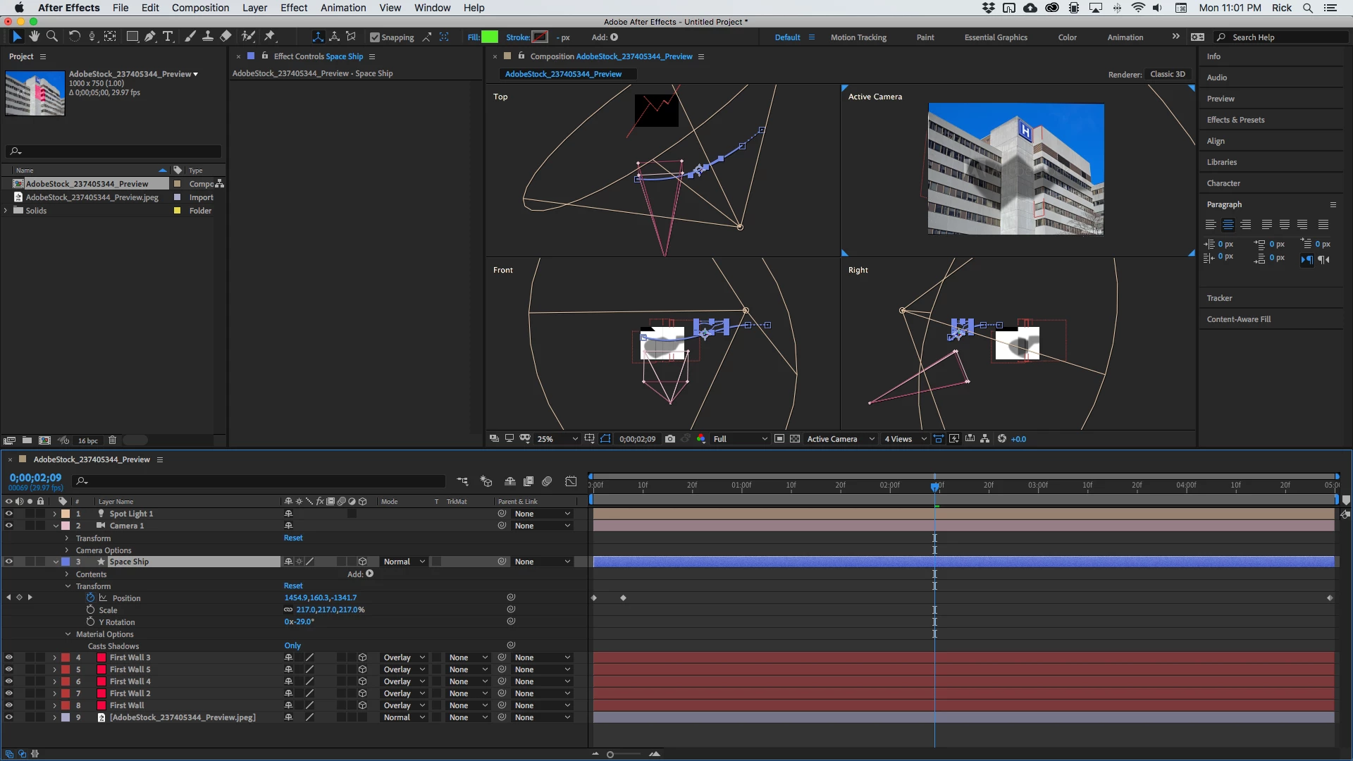

The final step is to enable multiple views so you can arrange 3D layers. Create a spaceship layer (I used a simple shape layer) make it 3D, press 'aa' to reveal material options, and set the layer to Cast Shadows Only. Then position a spotlight if you want soft shadows or a parallel light at about the same angle you think the sun is coming from, animate the position size and scale of the space ship layer and make the final adjustments. You end up with a comp that looks like this:
You end up with something like this:
The project took about 15 minutes. The closer you get to matching the perspective of the building and the closer you get to matching the position of the sun, the more realistic your composite will look. Mine needs a few more minutes of tweaking. Feel free to download a sample of the Stock Image and play with this project file
